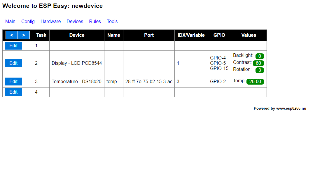

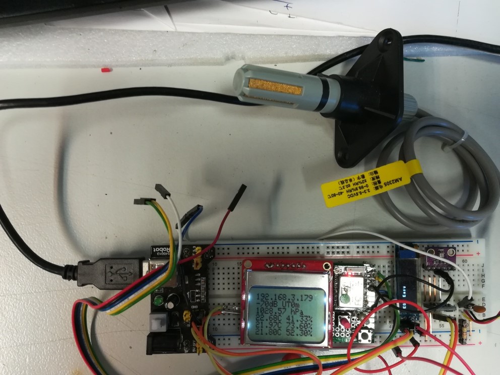

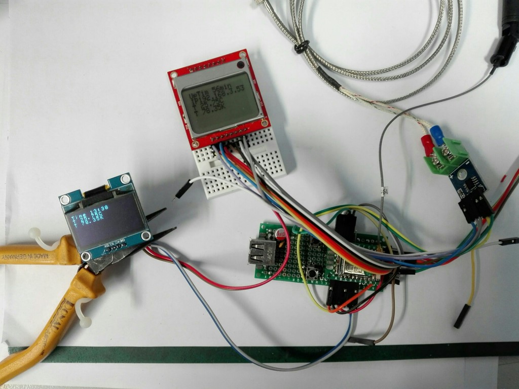

Hello i took above code and made it works.. at least for me :D
we also need lib from link above.
Pinout is:
Adafruit_PCD8544(14, 13, 12, 5, 4);
// pin 14 - Serial clock out (SCLK)
// pin 13 - Serial data out (DIN)
// pin 12 - Data/Command select (D/C)
// pin 5 - LCD chip select (CS)
// pin 4 - LCD reset (RST)
Edit: updated a bit, added rotation.
Edit2: updated to use gpio to turn off/on backlight, added loging and UserVars, cleanup.. didnt tested cmds yet and i probably wont since i dont need it,
Warning: Check if current of backlight isnt bigger than 15mA if powered from pin, or 20mA for sink

Yes , the PCD8544 is connected direct to ESP8266 in hardware SPI configuration (in my example - ESP-07). I'll post today complete how-to based on modification from 7_lol (post No 4). It's working GREAT !!!
hier is modified version of 7_lol plugin for Hardware SPI and my connection (picture under code part).
Pleas check if you display have equal pin sequence :
PIN1 > Vcc,
PIN2 > GND,
PIN3 > SCE,
PIN4 > RST,
PIN5 > D/C,
PIN6 > DIN,
PIN7 > SCLK,
PIN8 > LED
IMPORTANT - in ESPEasy configuration it shows as I2C device with suggest that PIN 4 and 5 are used by PCD8544 plugin but they are NOT (I'll correct it next week - sorry no time). Followed code use only GPIO2,13,14,15
PIN's connection for display are hardcoded. Don't change them.

Hi all, I am very pleased that other ESPeasy enthusiasts also use the Nokia display. In many applications using the hardware SPI allows you to use the I2C and OneWire interface. And we still have Tx and Rx which can also be used - if we don't need a serial login :) I would be very grateful if you manage to include PCD8544 in the repository. I also have positive tests of NOKIA display with ESP32.
On the following photo - ESP07 (updated to 4MB) , BME280, Si7021, AM2305, 0,91" OLED Display, Nokia display and ... still RX and TX free. ;)
Bestr regards ... i pozdrowienia dla kolegów z Polski ;)
