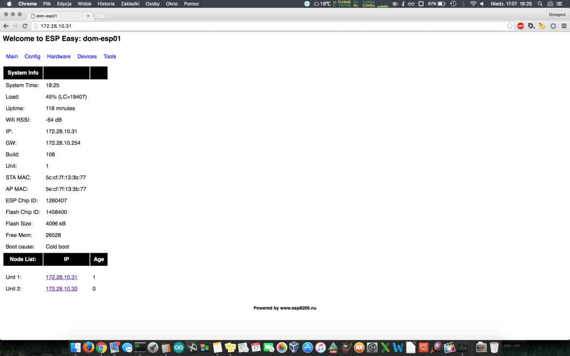

Hello I know that this future is experimental, this are my experiences with it:
1. I have enabled udp port 65000, enable Global Sync in Advanced Tools, set Unit nr 1 and 2 on two units in Config and reboot.
2. I see Unit 1 and Unit 2 in Node List in Main.

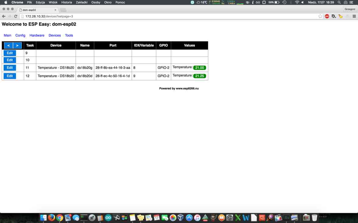

3. At the beginning everything was ok, I added the first thermometer ds18b20d on unit 2, I set global sync on it, submit and on unit 1 got task with correct readings but with strange port address (cloned of existing one on that unit). When I added a second ds18b20g with global sync enabled and submit it on unit 2, on unit 1 got task with readings truncated to the integer part (before the decimal point). Then add and remove multiple times this two tasks and since then i got truncated readings only:
If any developer is reading this, I can debug it more with your directions (for example tcpdump, but i don't suspect network communication becouse if I change task on unit 1 I see temporal readings with 2 decimals but without updates from unit 2 till I delete it on unit 1 and resubmit it on unit 2 but then again with the truncated result)

I added a third sensor and it looks like only temp is rounded to integer:
