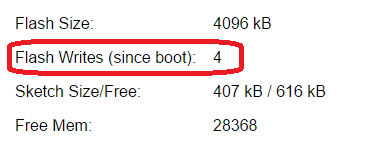

Besides the bad example, regular users are likely unaware about the internals of this project and would not know when stuff is written to flash memory.
So it might be wise to run a check on these log entries (set you log level to '2'):
FLASH: Settings saved
If they appear on a regular base, or each time you push a button or send a command from your Home Automation software, you have to start getting worried a bit...
In case of doubt, please report here so I can have a look at your specific case.
You could also start using R131 from github and check the webgui:
