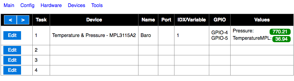

MPL3115A2 pressure sensor Plugin
#1 Post by interhard » 25 Sep 2016, 13:18
Hello. A few days ago I made a plugin for I2C MPL3115A2 pressure sensor . If anyone needed - is a plugin here:https://yadi.sk/d/pbVAdMcGvgFVk
Datasheet for sensor - http://www.nxp.com/files/sensors/doc/da ... 3115A2.pdf
