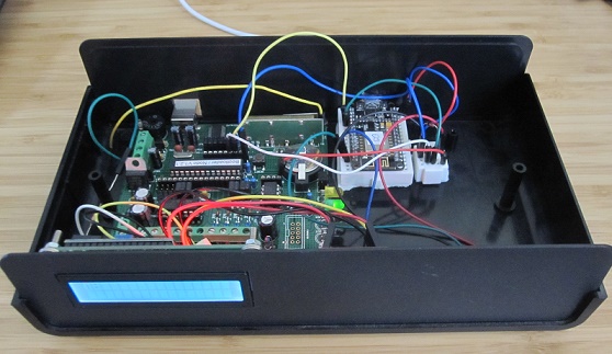

My house is still populated with some of these boards (Nodo Arduino, similar to Nodo Small):
Some of them have ESP Wifi added, using the Nodo Bridge, but it's time to think about a new approach and modernize the stuff. The Nodo comes with a powerful programmable 'eventlist' so it can act as a decentralized mini-controller. I started the ESP rules engine mainly for testing purposes but it may have become powerful enough to handle over control from Nodo to ESP Easy.
But i do not want to waste the Nodo boards because they can control all my 433MHz based lighting as decentralized units without needing any other Home Automation like Domoticz.

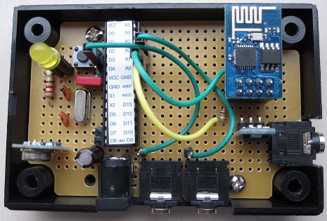

and some Nodo Small variants, using only a 433MHz transmitter to save money:
(to be honest, i do not have any native ESP Easy running at all...)Some of them have ESP Wifi added, using the Nodo Bridge, but it's time to think about a new approach and modernize the stuff. The Nodo comes with a powerful programmable 'eventlist' so it can act as a decentralized mini-controller. I started the ESP rules engine mainly for testing purposes but it may have become powerful enough to handle over control from Nodo to ESP Easy.

Did some testing yesterday with the customized RFLink and idea #4 looks promising.
My very first Nodo Arduino (purchased in 2011) has been running smooth for 5 years. Controlling several lighting schemes downstairs, outside and garden lights. But now it will start it's second life, likely for another few years... Same job, new features. Using the webgui to configure the rules makes life easier than to program the Nodo eventlist the old way... It should also work with the more recent Nodo Small. These are likely more sold than the original Nodo Arduino boards (but i don't have one of these):
I've also added a few commands to this "RFLinkSmall" edition so i can use already most of the Nodo Small hardware features:

Martinus , do you have a schedule for me how you connected the esp to the arduino.Martinus wrote: ↑01 Oct 2016, 14:08 Today has been a productive day so far and migration to RFLinkSmall makes quite some progress. Already converted 4 units to RFLinkSmall on the ATMega328 MCU, connected to the ESP01-1M modules (OTA capable!). All running the latest ESP Easy R133 that can communicate with RFLink using the rules engine.
