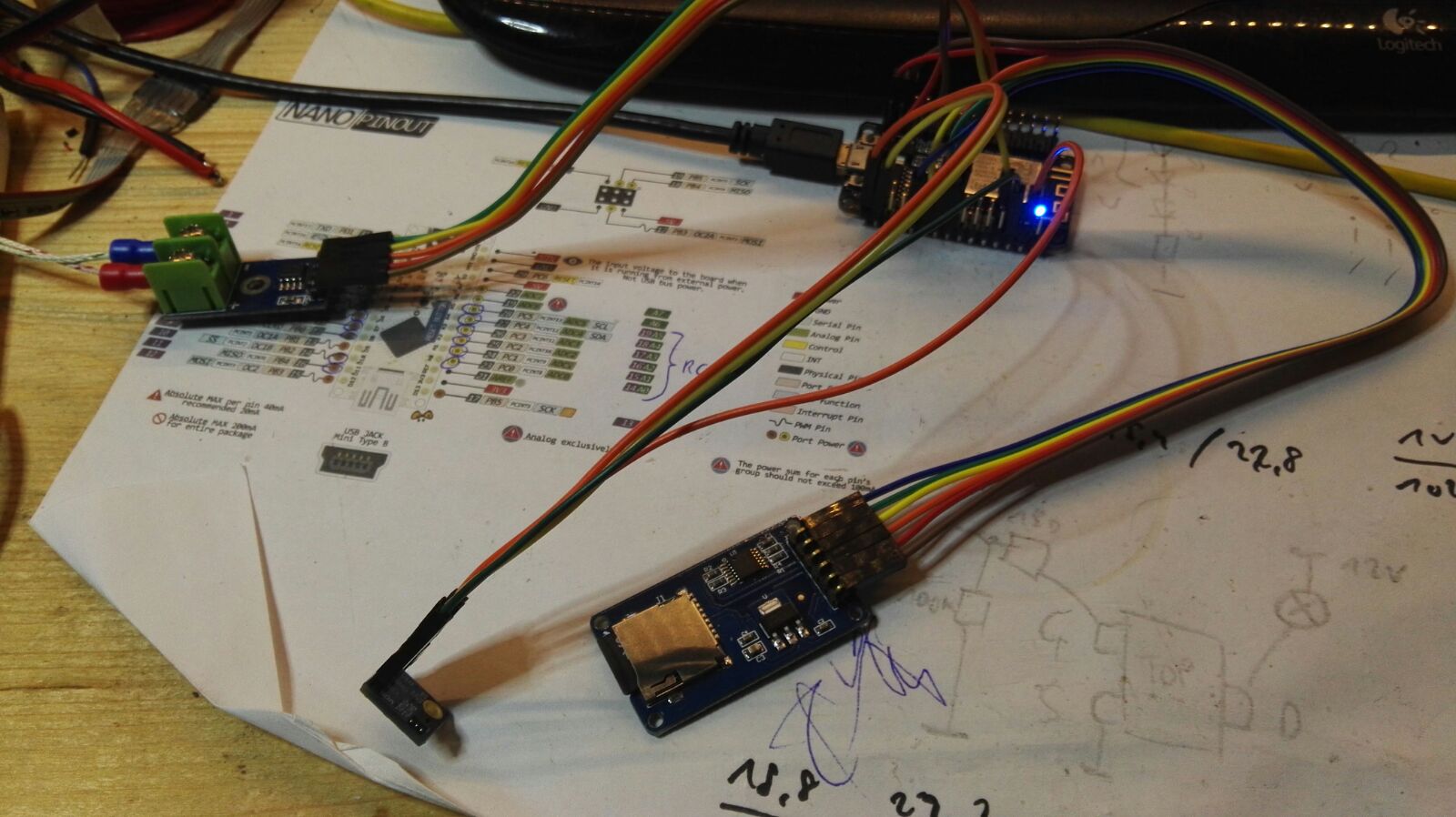

today I want to show you my latest developement with / for ESPEasy ... You may have noticed that I have done a new plugin for the SPI adapter MAX6675 / MAX31855. After I finished the plugin I thought it could be nice to add a SD card interface since it uses also the SPI interface. ;)

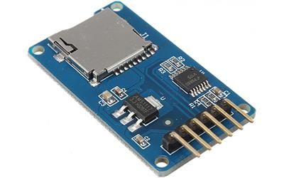

After some grabbing in my components I found an adapter from CATALEX. See the pictures in the attachement. It´s connected with 5V, GND and SPI.
It needs some SPI additions in ESPEasy (which I hope will be merged ... :roll: ) to get the SD card working.
But after 3-4h of testing it´s working :ugeek:

I used a Thermocouple via SPI, SI7021 I2C Sensor and the SD Card and there are still pins left :-D
CATALEX Adapter.jpg (14.79 KiB) Viewed 21619 times

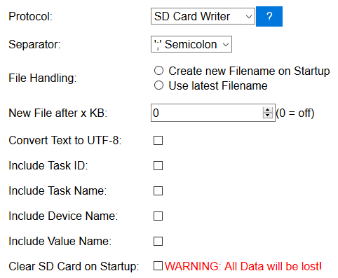

Work in progress ;)
I just want to show you the settings page for the SD Carc Controller Plugin.
Now there are some file handling and IF conditions left to be coded :P
If you have any missing additions please let me know ...
