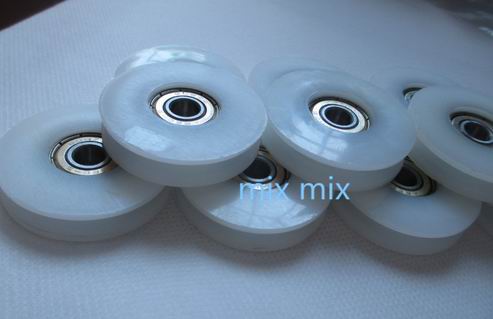

The fishing line is guided by Nylon U groove ball bearings:
https://nl.aliexpress.com/item/2pcs-Nyl ... Title=true
