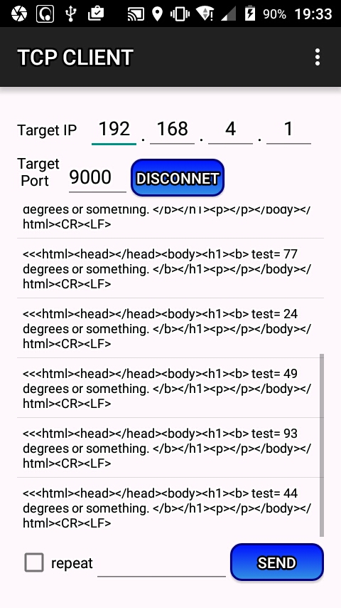

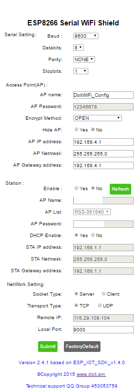

To do this I want to display a line of text transmitted by the Arduino Uno with an ESP13 shield (Settings: ESP8233-ESP13 Settings for Project 3.bmp) to a textbox on an Android cellphone. The Arduino sketch that produces the text is attached (ESP13_ESP8266_Project_3_sketch_v6_to_Android.ino). With the App TCP/UDP Test Tool I can see that the data is transmitted and received properly (PrtScr_2017-02-11_193339.jpg). When I connect my browser to the ESP13 the data appear too (Typical Browser output for Project 3.bmp), except the data only start to appear after a long delay, such as half an hour (Why? any ideas?).

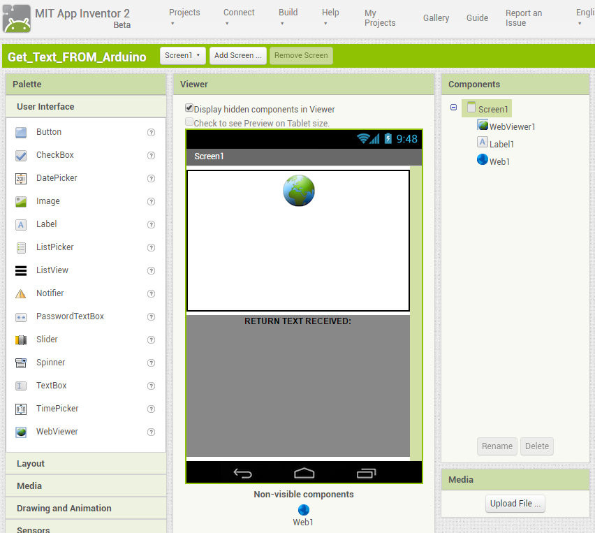

To put the data in a textbox on my Android I want to use an App developed with MIT's App Inventor 2 program. To do this I used the blocks and designer code (App Inventor Blocks.bmp, App Inventor Designer.bmp, Get_Text_FROM_Arduino.aia). I could not get it to work and I could not find an example that shows how. What changes do I need to make it work?

Without knowing anything about the app inventor and minimal knowledge of object oriented programming I just noticed that you use two different "web" objects: webviewer1 and web1. Maybe the whole point is to use just one - if the .gotourl method of webviewer1 retrieves data I don't think the .gottext function of web1 will be triggered.

Hello, I have also worked with MIT AI2, you can use the "response code" and check for 200 response which is the "OK" response from the server.
