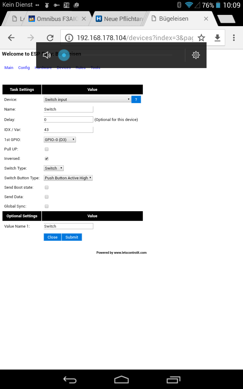

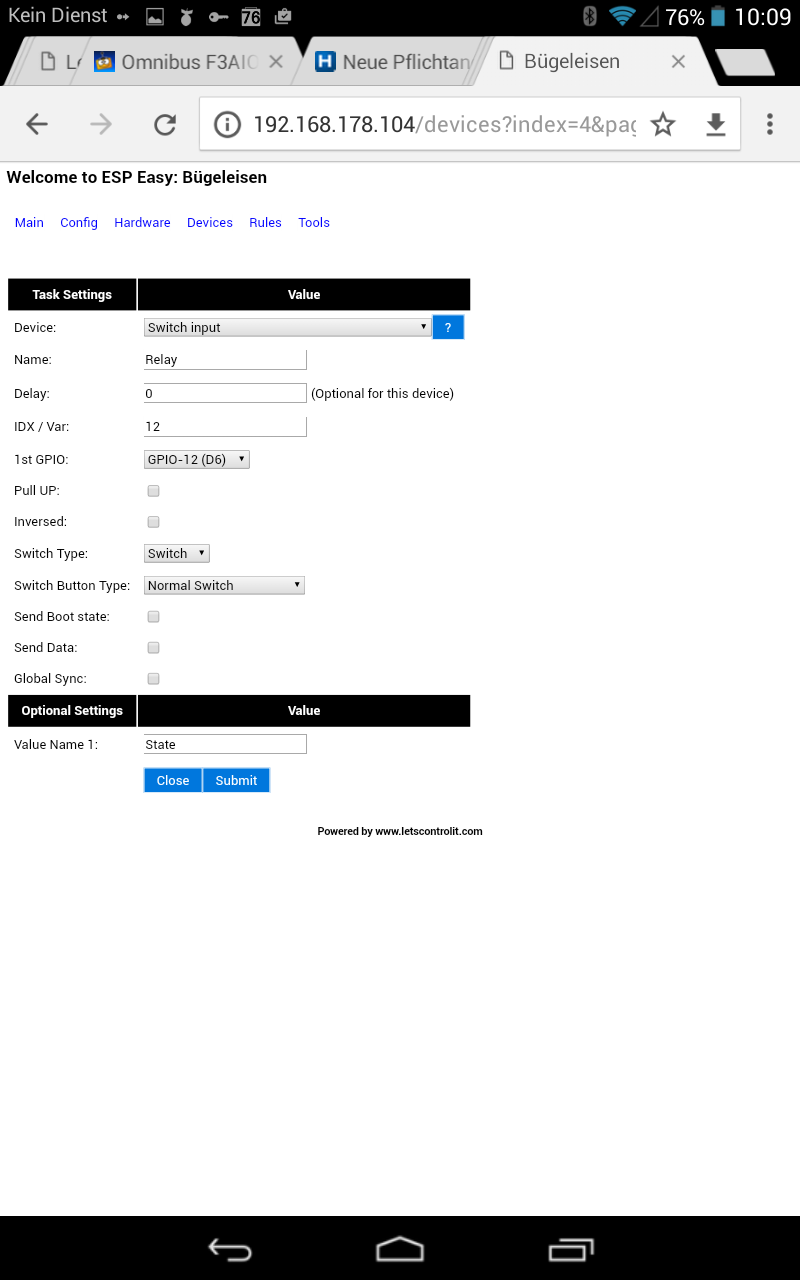

It works for me. This is my switch setup:
