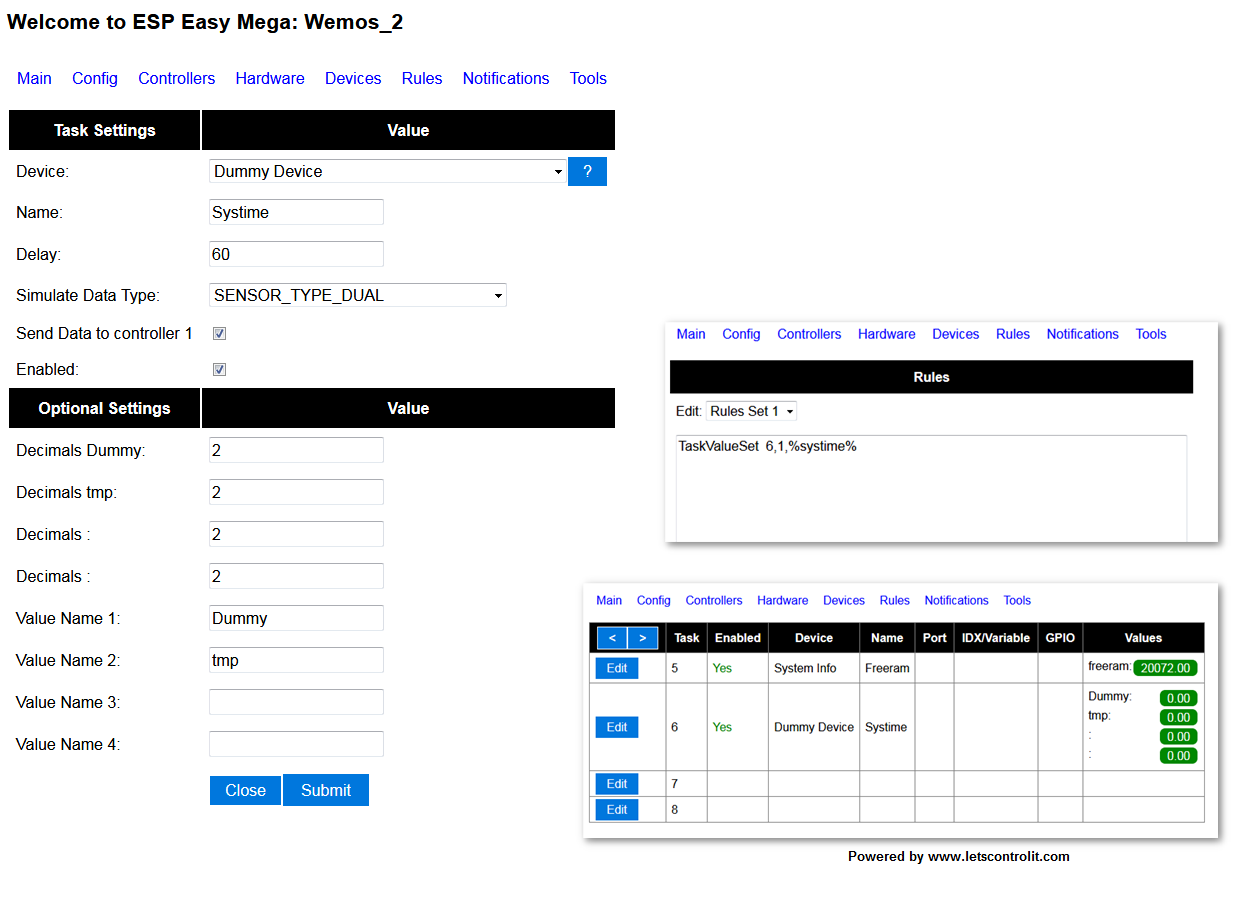

I wasn't able to be successfull using systime. Do you see my mistake(s)?
Posts: 1156
Joined: 03 Sep 2016, 23:27
Location: Bielefeld / Germany
Re: %systime% | pir-sensor (HCSR501)| oled display (SSD 1306)
#7 Post by Shardan » 30 Mar 2017, 14:59
hm....
i think i've made a mistake.
All the fields of a dummy variable are number values including decimals.
I don't think you can put time format values into such a variable.
One of the programmers reading? Is that possible?
tklein.lotte@web.de
