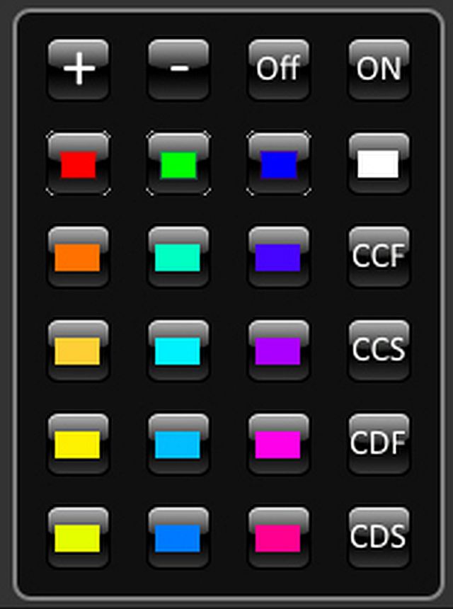

I bought some very cheap LED stripes from the DIY market and virtualized the remote control with FHEM "remotecontrol"
https://fhem.de/commandref.html#remotecontrol
If needed i can give a config sample.
the codes are in Hex.
From FHEM you can use the "ESPEasy" pluigin from FHEM: https://fhem.de/commandref.html#ESPEasy

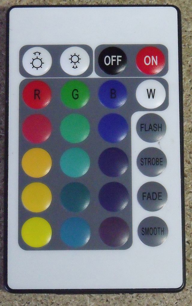

Any of the Stripes can be relocated without problem.
As an extra the manual remote control is still working if necessary.
Another extra: As it is a IR Transceiver it receives commands from remote controls too.
That makes some things possible: For example if i use the usual remote to switch on TV the IR transceiver
receives the signal too - and i can dim down lights automatically via homecontrol.
I have a ready developed LED driver for ESP that avoids usual problems.
Most use too low voltage to drive the MOSFETs so the current they can handle is very limited.
Avoiding this needs far more effort and is more expensive. First you need an additional higher
voltage from the power supply (10...15V) as MOSFET's are voltage driven. Then you need
a MOSFET driver chip like the Maxxim 7667 for interfacing the ESP to the MOSFET's. The
7667 is expensive... and so on.
With this circuit i have tested ESP-based LED drivers with 15A on one single channel.
Pending on the used MOSFET type even more is possible - just my testing equipment has it's limits
Just this is a far more expensive solution equaled to using the IR-modules
delivered with the stripes. I need the IR-transceiver for TV and stereo anyways.
