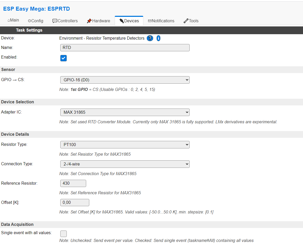

if interested i started support for MAX31865 in an dedicated local plugin on my machine. I simply miss the know how to transfer it to your GIT repository.
It has proven running with a common MAX 31865 shield ( e.g. Adafruit of similar) and a D1 mini clone using an PT100 sensor.
It supports PT100, PT1000 with adjustable reference resistor value, switching 2-/4 wire connection, and an adjustable float offeset value to finetune temperature display.
I am currently starting to implement as well support for TI LM7x and TMP12x devices (experimental, untested).
If you tell me how to achieve a local mirror of GIT and how and where to put the plugin (and with which number and status) i will provide it.
Best Regards
chr.kai.in

- 2021-05-01 18_30_26-ESPRTD.png (27.11 KiB) Viewed 16296 times
- 2021-05-01 18_29_13-Clipboard.png (54.52 KiB) Viewed 16296 times

Took a quick look an it looks like it is highly inspired on the P039_thermocouple.ino, but as a quick test I copied it here over that plugin file to see a diff and it is quite a bit more elaborate.
Maybe we can rename it to a plugin number following the first free plugin ID in the 'mega' branch.

thanks to your quite detailed crash course a pull request for the plugin has been added to the queue.
[EDIT] Yes, renumbering would have been as well one of my first questions - but i was uncertain which number would have been available.
Hope this turn out to be helpful for someone...

Hello Max Meyer,
you are welcome - I am happy to hear others are looking forward to use the updated plugin !
The existing thermocouple plugin already provided a very good foundation for my updates. My big Thank You goes out to TD-er and Ton Huisman for their review support on the realization so far - it helped a lot. The plugin will carry the name "Thermosensors" to reflect the enhanced set of adapter shields supported and provides thermocouple and resistor based thermosensor support.
There are still some maintainability related updates to be done in the code and i plan to finally provide as well the cold junction temperature as a 2nd variable for thermocouple sensors. This would help with unsupported thermocouple devices (external algorithms) and help for TC sensor mounting debugging (-> cold junction temperature out of range).
Still TI devices (LM7x family and TMP12x device family) are planned for the future and basic set of communication is prepared, but i doubt you will get correct values when communicating with those devices - i simply lack hardware for testing at the moment. Anyhow, i found those small, capable devices interesting for future usage.
In my set up, i plan to use the MAX31865 support for decentralized temperature supervision with PT100 sensors, D1 mini pro and 0,66'' or 0,95'' display running on a 2000mAh Li-Ion rechargeable battery or 5V micro USB power supply. Those satellites are forwarding the measured data and their charging status to a mosquitto MQTT server and a node red instance running on a raspberry pi.
Planned to be a mobile temperature measurement setup for multiple channels, with high flexibility of mounting and power supply. The Node Red Instance provides easy to use dashboard capability and web GUI for remote access.
The second cable gland on my housing is planned for micro USB power & programming cable, allowing later charging and re-programming without the need of opening.
Best Regards
Christoph

Re: Plug-in for MAX31865 RTD or MAX31856 Thermocouple IC?
After a lot of research on how the MAX31865 and ESP easy cards work, I came across this forum page. (You have done a remarkable job). I saw that there was a version of ESP easy with support for these cards but I don't have the knowledge to build the bin file. Is there a built version?
I couldn't find it on git, even here: https://github.com/letscontrolit/ESPEasy/pull/3621.
I hope I'm not bothering you too much... It's for a university project.
Thank you very much
Thank you very much
