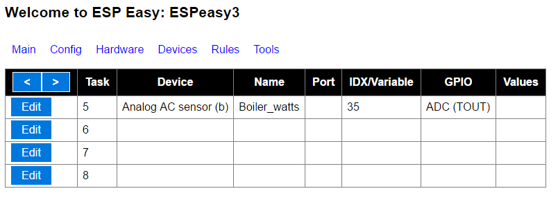

I'm hoping someone with more experience of plugins than me will kindly offer some advice about a plugin I'm developing. At the moment, it works (sort of) but doesn't display its readings on the Devices page.
My plugin is based on the existing Analog ADC Plugin (P002), and also uses interrupt code and calculations from a Henry's Bench arduino sketch. My present code is functioning ok, reading the waveform of the mains AC through a current-transformer sensor module (I'm using a TA12-100). The interrupt routine identifies the peaks in the alternating current, then the main code of the plugin converts this peak data to a RMS (root mean square) value for current, and finally sends the result via MQTT to openHAB2. It also correctly displays the values in the Log. I've begun to set up some parameters which can be entered/changed at runtime in the device configuration page, then saved, such as the ratio of the current transformer, mains voltage, etc. Potentially this could allow the plugin to be used with other sensor devices. So far so good!
The problem I have is this. Whereas all other plugins display the value of their measurements in the Devices screen, at present this isn't happenIng with my plugin :( . I must be missing something. Can anyone help me with some advice about where I'm going wrong, please?
Here is my code, with thanks and acknowledgements to the authors of Plugin 002 and Henry's Bench ....

.. and here is a screenshot of my Devices page (with no values from this plugin) ...

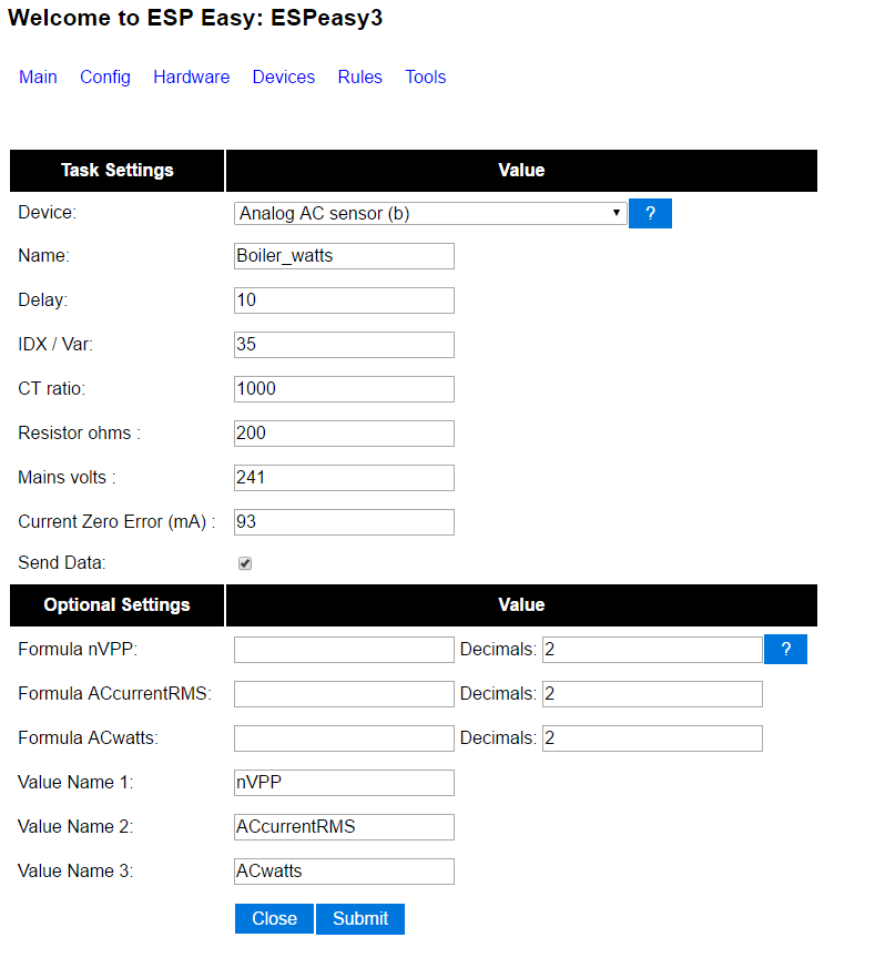

... and my device configuration screen for the plugin...
All help and advice welcome! Thanks in advance!.

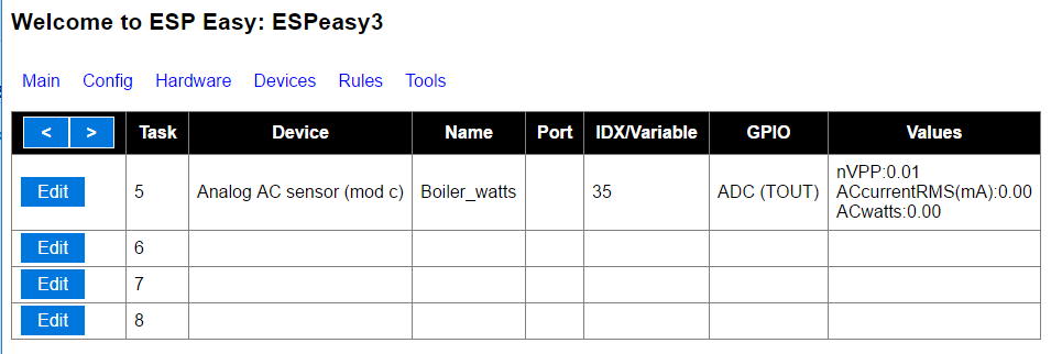

Thanks Costo for the information about RMS, that is useful, but I wonder if the ESP8266 would handle all the calculations of squares etc. (I don't mind too much if the readings are not perfectly accurate, as I'm mainly interested in the trends of the data.)
I've made some progress since my first post, and partly solved the problem. Looking at my plugin afresh, I realised that the majority of the PLUGIN_WEBFORM_SHOW_VALUES section was commented out. I now remember doing this to isolate the source of some compile errors earlier in the life of the plugin, but I had never gone back and uncommented this part :oops:
When I uncommented it, I immediately got errors. After some head-scratching, I realised that I had lines such as
 string += plugin_202_CT_ratio[event->TaskIndex]
. These referred to my configurable parameters, not to measured variable values.
So I changed the section to this...
    case PLUGIN_WEBFORM_SHOW_VALUES:
      // This section displays most recent measured values in the "Devices" table of the web interface....
        string += ExtraTaskSettings.TaskDeviceValueNames[0];
        string += F(":");
        string += UserVar[event->BaseVarIndex];
        string += F("<BR>");
        string += ExtraTaskSettings.TaskDeviceValueNames[1];
        string += F(":");
        string += UserVar[event->BaseVarIndex+1];
        string += ExtraTaskSettings.TaskDeviceValueNames[2];
        string += F(":");
        string += UserVar[event->BaseVarIndex+2];
        string += ExtraTaskSettings.TaskDeviceValueNames[3];
        string += F(":");
        string += plugin_202_current_zero_error[event->TaskIndex];
        success = true;
.....and it now compiles and displays the values in the Devices table page. :D
BUT (there's always a "but" isn't there?) the green colour around the values is missing... :(
I've been looking in the web interface code to try to spot how this is controlled, but without success so far. Could someone kindly give me some advice?
Thanks in advance,

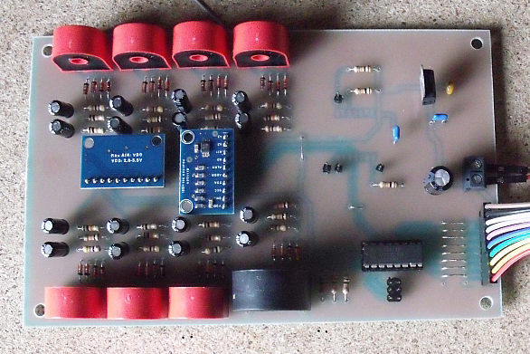

I have some PDU boxes, just 7 outlets in the back and switches in the front.

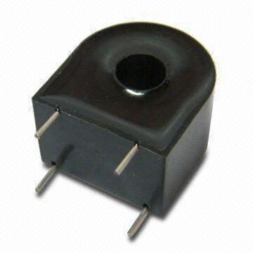

For measuring current i plan to use small current transformers like this:
The advantage: It's completely galvanic isolated.
I've already made a circuit for this, allowing switching of the outlets and measuring current
but it is not tested yet due to lack of time.
It uses 2 x ADS1115. Disatvantage is that it just measures current, not active / reactive current or such.
If anyone is interested i can publish the schematics, but be aware it is not tested yet.

Thanks for responses. The sensor module I am using also has a current transformer TA12-100, which provides complete isolation from mains (line) voltage. This was the big attraction.
I am using this ESP8266/ESPeasy module to measure AC current consumption (and thus estimate power) for individual appliances (currently my oil-fired central heating boiler system, pump and fan). Separately I have another ESP8266 next to my distribution box which is running a pulse counting sketch (not yet ESPeasy!) which is reliably reporting total power consumption of my house by reading the LED flashes on my main electric meter.
Coming back to my original, or rather second, question - please could somebody explain how the normal green background around the measured values (in the Devices table) is generated? I'd really like to get that right for completeness, and also for my own learning about how the plugins and the framework together should function.
Thanks in advance
