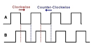

This is how I want it to do:
Below is the switch state of the Rotary-encoder.
If I read input A then check what is the status of input B is.
Then I know of the Rotary is turned left or right.
Then for left can I set output - 1, and for right output +1
But now the only problem there is :
How can I do this in "rules" ?

i dont think this can be done in rules, the timing is too tight so you will need interupts.19roland70 wrote: ↑07 May 2017, 10:02 This is how I want it to do:
this goes beyond my prgramming skills, but imho the following route should have the best chances of succes:
1. rotary encoder will need to be its own plugin.
2. the rotary encoder is a "double pulse counter" with the timing of the flanks determining the direction. the best starting point for such a plugin should be the pulse counter plugin. intrupt flank detection, as well as counting should be "there". whats missing is the "second gpio" part and detection of direction. this should ne available as ardui
3. unless the delays are reduced , the rotary encoder will still remain a bit laggy.
you could also use arduino to decode the two pulses and transfer data via serial into dummy device. this is probably the easiest if you cant code(like me)
