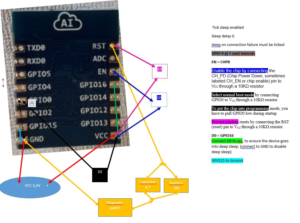

Re: Post mailbox to email notifier.
I would like to submit you the results of my searchs.
Could you have a look at the attached Word diagram and comment it?
It is the sum of what I have collected after reading a lot of things. Please tell me if I am right or if something is missing or is incorrect.
I understand that I will need something different to flash the esp07 with Espeasy (Vcc, Tx, Rx, Gnd)
Gilles
Gilles
Any comment or error in my diagram ?
Do you think/confirm that the cabling is the right one? I am not a specialist so any advice is good to me.
I have ordered 3 more ESP07. They may be helpful if I am wrong.
Gilles
Gilles

The old ESP-07 has 512KB Flash - the ESPEasy 2.0.0 binary is bigger then that and does not fit into memory.
If you need an external antenna use the ESP-07S (4MB).
For an example of the circuit you might take a look in the wiki's User section.
I've published some of my circuits, they are tested and work.
For example: https://letscontrolit.com/wiki/index.ph ... /IR-Remote

Thanks for the info.
My bad. I have missed the extra "S" in your recommandation of using a ESP-07 instead of a ESP-12.
I also will have a look at your project to check the wiring.
I have just ordered 5 ESP07-S to a chinese site.
btw, would you know an european site where to order parts and avoid waiting at least 1 month to get the parts delivered (to France)?
Gilles
