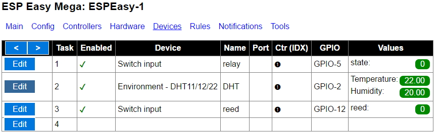

Also, here are my devices:

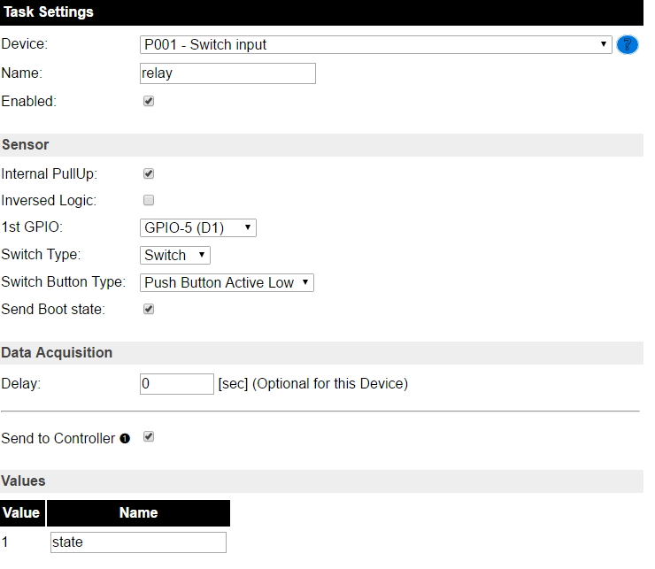

Hi grovkillen. Thank you very much for your reply! Basically, what I am trying to do is connect a relay to my garage door button, inline with the existing two wires to simulate the press on the garage door opener, I have a relay on GPIO-5, and a reed switch on GPIO-12 that determines if the door is open or closed. Below is the screenshot of the devices, and how the relay is currently configured. I did try your code example without any luck. I am NOT using a sonoff device, but just a standard relay.
