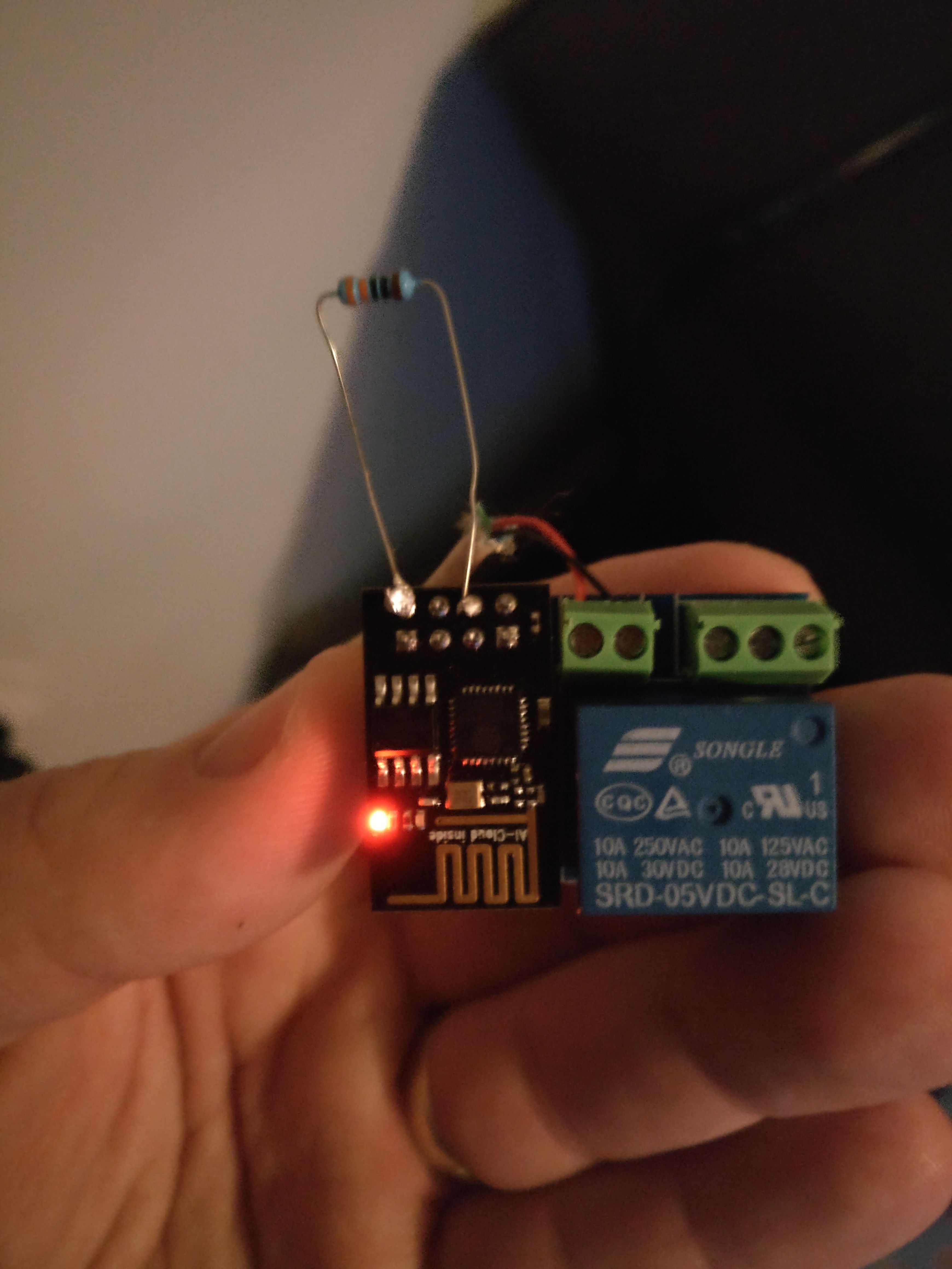

But please send a picture of your soldering / connection when trying to run it with NO programmer.
Re: No connection ESP01 and Relay
Yes I do. I have a standard ftdi programmer. I will send over a photo to.orrow if you don't mind. By soldering those pins does that mean it's in bootloader mode 247? I thought these where the pins I shorted to flash the firmware.
Yes that jumper is a permanent thing. Do not remove it.
Ok all soldered. Still not connecting to my network ;(
Image attached

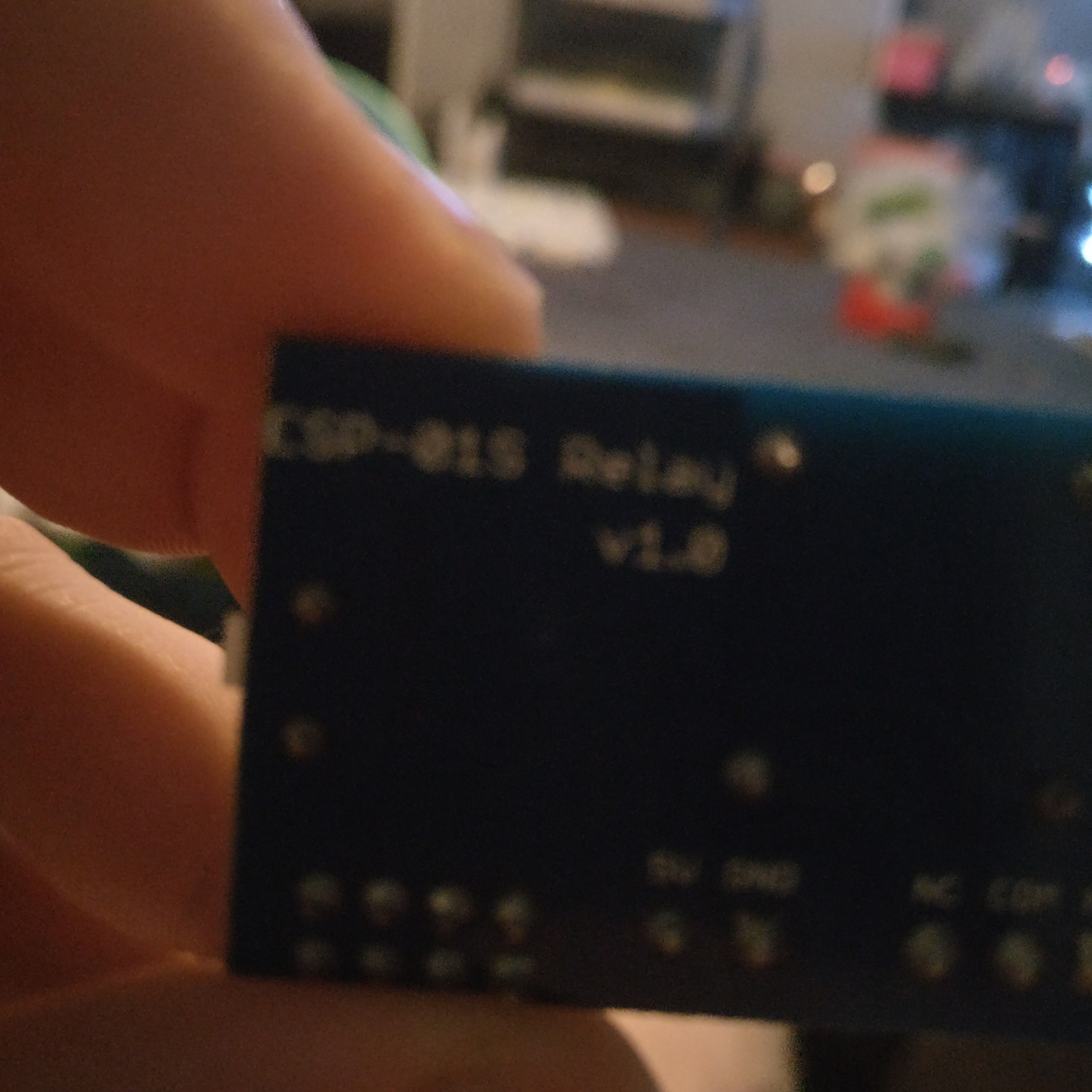

This may answer your question.
I suspiced some needed pull-up resistors are missing on the board so i just checked the pictures of the board on AliExpress.
Beware - i'm judging only by the photos and may be wrong.
This is an interesting relay board.....
- Relay connected to GPIO0 - no pull-up resistor on the board
- GPIO2 floating - no pull-up resistor on the board
- ch-pd floating - no pull-up resistor on the board
- Reset just connected to the button - no pull-up resistor on the board
seeing this I checked ESP-01 and ESP-01S from my shelf:
The older ESP-01 (the one you used juding by your photos) has a internal pull-up on reset only.
The newer ESP-01S has internal pull-ups on reset, ch-pd (enable) and GPIO0 (I see 9..12 KOhm with multimeter) but
not on GPIO2 (I see some MOhms).
There may be other ESP-01 types differing from this.
It might be worth a try to solder the missing resistors to the board for a test.
Possibly it would work with the newer ESP01S, but not with your older ESP-01 types.

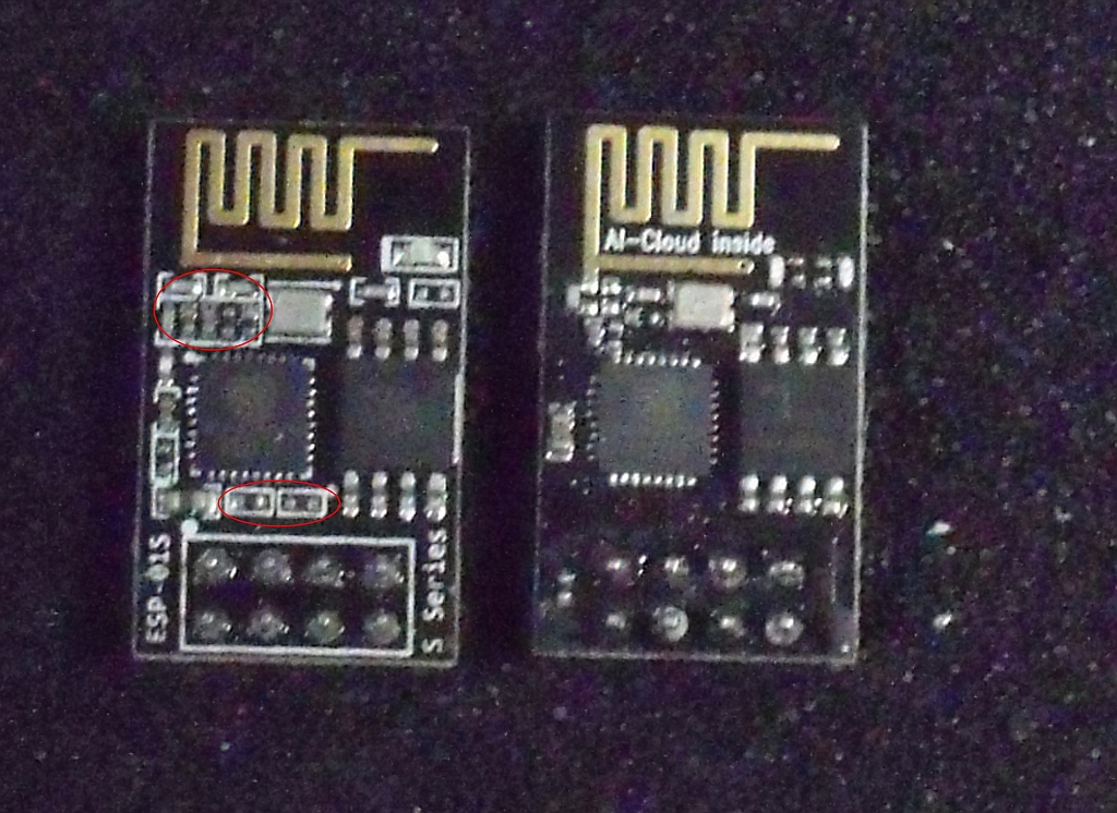

Yep, i think that's the reason - some pull up resistors are missing.
If you check the pictures on AliExpress et al you will see they all use a ESP-01S type.
Look at this picture:
In the upper left marked area there are some more parts on the ESP-01S.
In the lower area are two resistors that are missing on the ESP-01.
As said check the voltage on the four pins as described some might have too low voltage to start up.

So I've replaced the esp01 for esp01s and it works flawlessly. Thanks for your help. Just need to find a use for the old units now.

i have connected VCC to CH_PD and put a 10K ohm resistor on VCC and GPO0 on the esp01.
The board seems to start up now and GPO0 can operate the onboard relais.
So don't throw away your old esp's yet.
