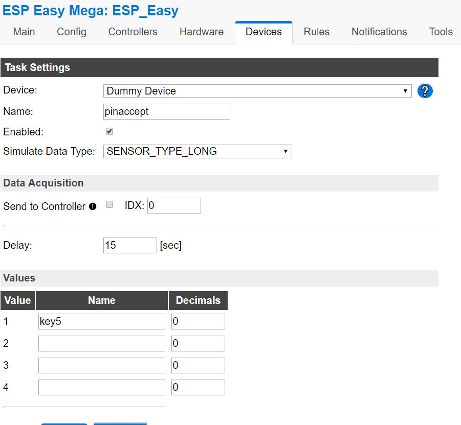

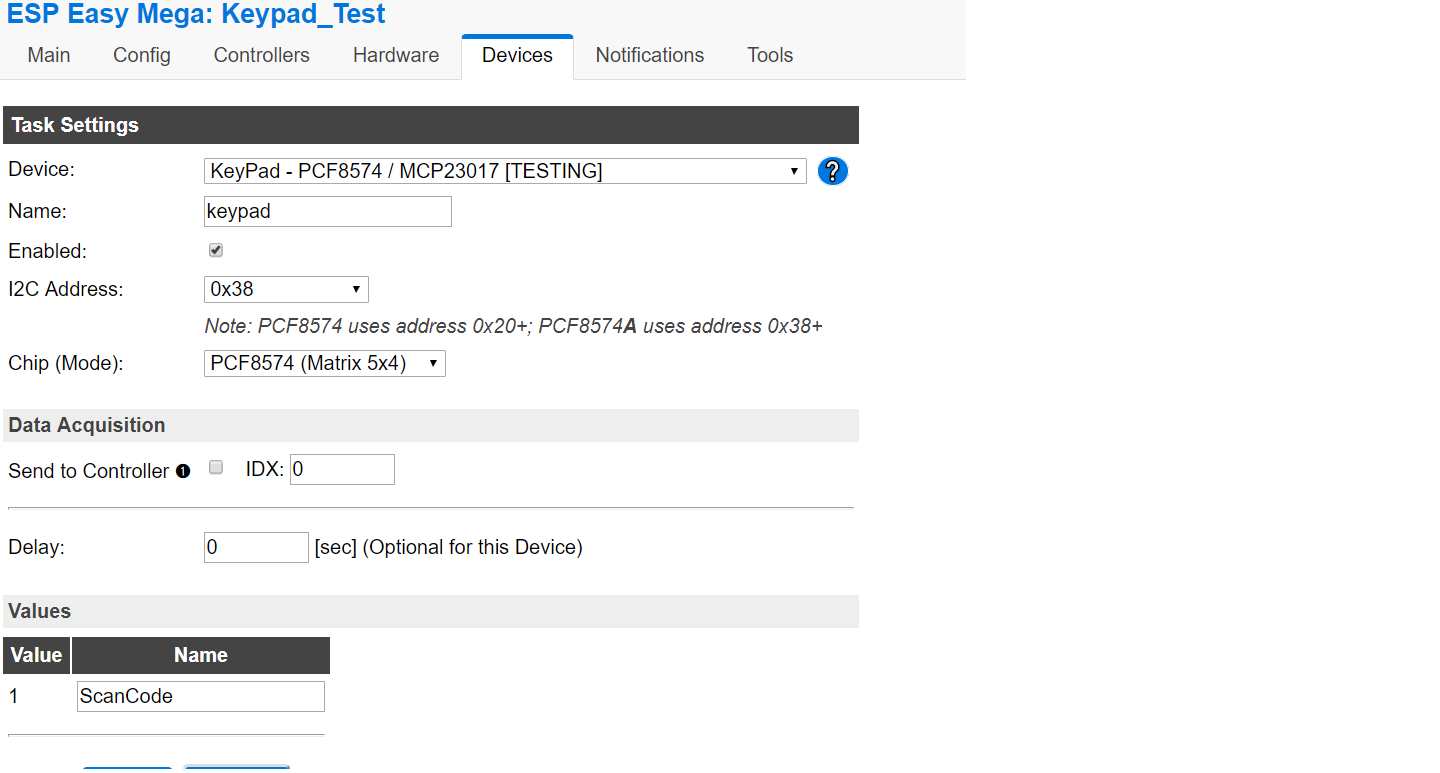

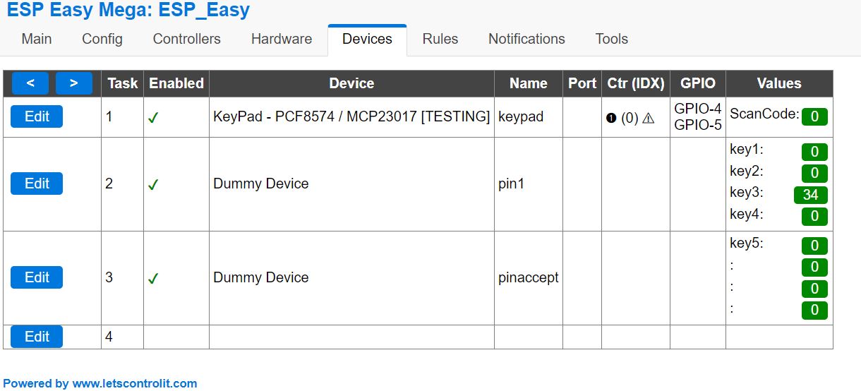

Here are the device screenshots
This sort of works. it does not add the values and no matter how I format that section of the rule it doesnt work. How to you add several values together?
The last part of the rules is to clear the codes because if you dont just pressing the star key will open the door. Not good!!
Also of note. Dunno if its my keypad or how its wired but its very flaky as to registering the key presses. Only way it works is to enter them VERY slowly. nor more than 1 key per second and a second or 2 in between. Otherwise it misses them.
Sorry this post is so long. Any takers?
