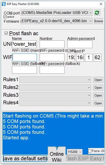

just tested it on a wemos d1 mini (system is Windws 10):
- COM port: Dropdown took a while, but works, found the correct COM -> i just double checked did not find the correct COM port
- Firmware: works fine if bin is in "BIN" folder "Browse" only opens file explorer wich no way to choose the wanted bin
- Fields for Details are working but format is off
- "flash ESP Easy" did "start" but not the flashing process
- Log Folder is empty
do you need anymore Information?
Thanks for your awesome work!

#11 Post by grovkillen » 31 Dec 2017, 12:04
jeti wrote: 31 Dec 2017, 11:03 looks awesome!
Thanks for feedback! I will try to update later today (especially include the font and log failed attempts of flash). :oops:

Just tested your 0.00.009 version. I am getting the same problem as "jeti".
The program indicates that it has started flashing, but "esptool" is not opening and nothing is being written into the log folder. Device not programmed.
This on two windows 10 (64 bit) PC's.

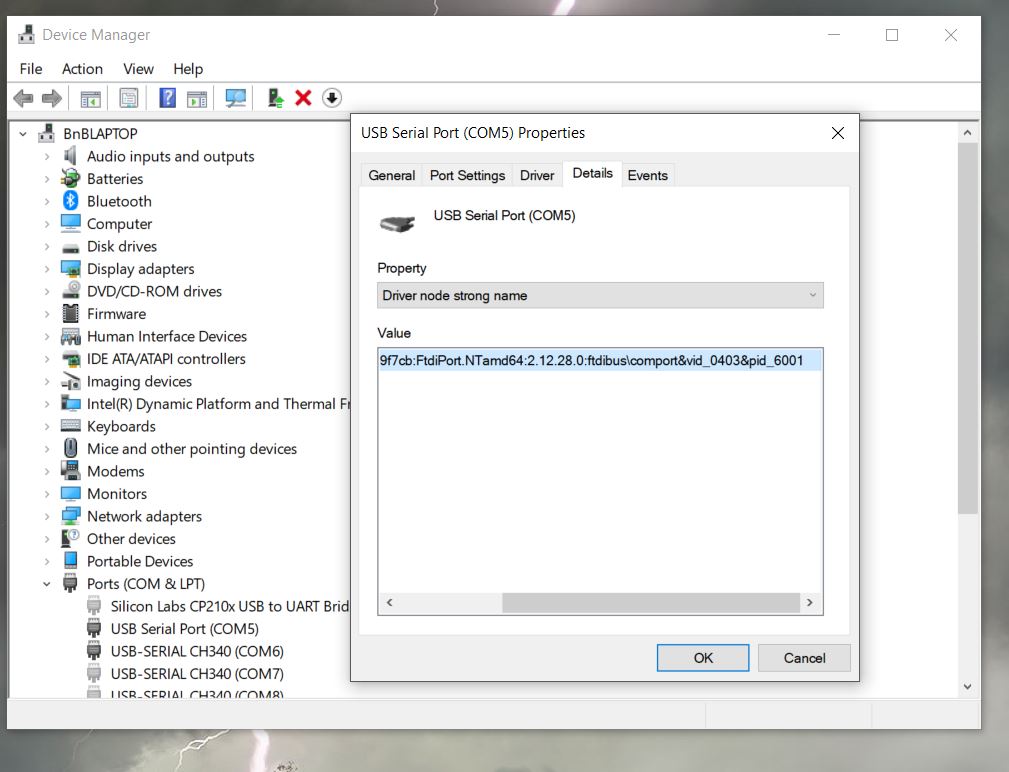

I have now tested and I cannot reproduce the issue. But I do get problem if the COM1 is not occupied by any driver. I changed one of my higher COM port drivers to point to COM1 and it started working as intended. Is this an issue that could be what you're experiencing? See how I changed the settings in the picture below:
control panel --- device manager --- settings for com port --- port settings --- advanced --- com port number

#19 Post by budman1758 » 03 Jan 2018, 19:58
I'm having a similar problem. Windows 10 64 bit laptop. Does not list the COM ports correctly or at all. When the active ports box is checked I get no ports listed. When unchecked it shows some (not all) and says (off line) after the name.
I will try the flasher on my server later. Its a Windows 7 machine. 64 bit.

I just tried to move the com port to com1 like your example and it now shows a USB/Serial device. Tried to flash a module but nothing happens. ESP Tool window does not come up. Module not flashed.

Almost every time I insert the USB flasher it comes up as com4 or com5. Using your example I "forced" it to com1. It now shows as a USB Serial device. But it does not flash the module. Zero activity shows on the device. It has two leds for rx and tx. Click the flash button in the app and info window says "Start flashing on com1" but nothing is happening.

#25 Post by budman1758 » 03 Jan 2018, 22:46
Log folder is empty. :shock:

#44 Post by budman1758 » 08 Jan 2018, 23:19
grovkillen wrote: 08 Jan 2018, 22:38 The screenshots of the device manager showing com5, is that the FTDI programmer? Shouldn't the driver state something more specific than "serial..."?
Yes, it is. It does show more detail if you go into the properties a bit deeper. I would have thought the same thing. Kinda generic for a $17 dollar "genuine FTDI". :roll:
Re: ESP Easy Flasher
#45 Post by grovkillen » 09 Jan 2018, 11:26
budman1758 wrote: 08 Jan 2018, 23:19
Please try latest release ... https://github.com/Grovkillen/ESP_Easy_ ... g/0.00.016

#46 Post by budman1758 » 09 Jan 2018, 20:18
grovkillen wrote: 09 Jan 2018, 11:26 Please try latest release ... https://github.com/Grovkillen/ESP_Easy_ ... g/0.00.016
OK. Still not finding my FTDI serial port. Correctly finds the CH340 on correct com port. Lots of windows flicker in background.
When the app window appears it is still scanning for comports.
When done a command window opens and at the top is says cannot find the specified path.
The command line is focused in the APP_DATA folder of the flash app.
Even when trying with my CH340 device nothing happens.
I uploaded my debug file to your dropbox. It's quite a bit more informative.
Hope this helps.
Hope this helps.
Great! I have come to the conclusion that since I now only scan for USB TTL ports the FTDI might not consider itself as such?
(COM4) Silicon Labs CP210x USB to UART Bridge
(COM6) USB-SERIAL CH340
(COM7) USB-SERIAL CH340
(COM8) USB-SERIAL CH340
Those are found with USB but I bet the FTDI specifies itself as good ol serial..? If you go to the device manager and look in the code described in the picture below. What does that say for the FTDI programmer?
Also the date format is messing with my variables since the US "\" between the dates are interpreted as path's (in my code). I will hard code ISO date :)
Lastly, the APP_DATA folder, what files is inside of it?

#48 Post by budman1758 » 09 Jan 2018, 21:06
My device is not the one in your screenshot. It is COM5 also.
The APP_DATA folder contains:
esptool.exe
TimeStamp.vbs
Screenshot of what I believe is similar to yours.
I have hidden devices showing. Those are the ones that are greyed out.
Hope this helps.
