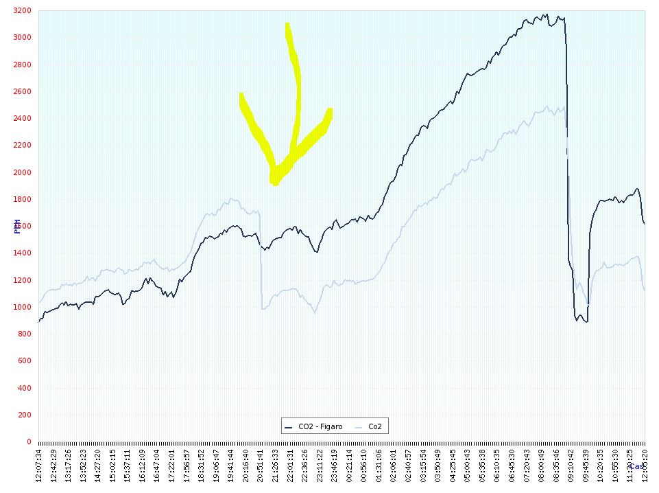

any idea why such different results are obtained? There are two sensors (CMD7160, MH-Z19) placed near each other but result seems to be shifted
. P.
Re: Support for CDM7160 / Figaro
Is the mh-z19 the line below (white) ? The sensor is on a 24h ABC cycle and will set the lowest point during that 24h period as 400ppm. They are supposed to be used in offices which will have the air purged during night, if you use them at home that will not happen and the sensor will start to drift..._petronie_ wrote: ↑25 Mar 2018, 23:55 Hi,
any idea why such different results are obtained? There are two sensors (CMD7160, MH-Z19) placed near each other but result seems to be shifted. P.
The MHz19 looks like a correct 400 ppm setpoint, since there are no 'flatliners', where the value is stuck at 400 ppm.
the values reported by the Figaro however are a bit to be worried about.
If they are correct, then you definitely should do more ventilation.
Above 700 ppm, it will start to smell like "can someone open a window please?"

There is visible significant issue with MHZ19 which seems to be caused by some autocalibration. There is visible drop in the output values with no reason. Both sensors are place next to each other. Figaro sensor require extra shielding again EMI! P.
- figaroVSmhz19_drop.JPG (112.53 KiB) Viewed 20347 times
That's the ABC feature.
It corrects the 400 ppm level, based on the lowest measured concentration of the last 24h.
So now you know why I added the option to disable this feature, since one day with less than optimal ventilation and the recorded values have quite some offset.
