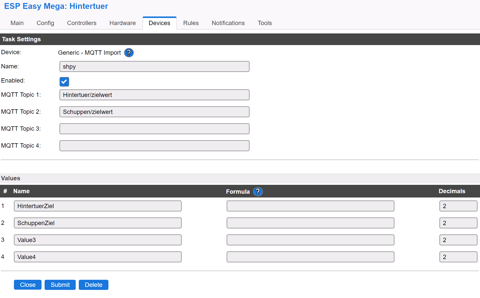

Here the steps:
1) create an MQTT Controller under "Controllers"
2) create an MQTT input under "Hardware" 3) create a Rule
This will set gio 15 HIGH for 100ms on 1 and gpio 13 to HIGH for 100ms on 0.
4) Configure the sleep mode under Config
5) Don't forget to connect D0 with RST. Otherwise the ESP will never wake up.

Here the steps:
on shpy#HintertuerZiel=1 do
Publish %sysname%/setze,1
gpio,15,1
delay 100
gpio,15,0
on shpy#HintertuerZiel=0 do
Publish %sysname%/setze,0
gpio,13,1
delay 100
gpio,13,0
