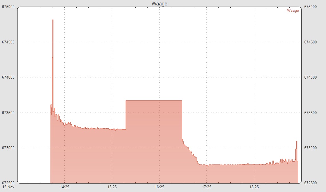

#7 Post by chunter1 » 15 Nov 2018, 19:28
I recorded several hours of sensor data.
The setup did not move and the temperature changed not significantly aswell.
So...I don't know what's going wrong here.

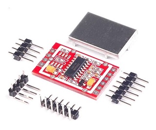

Looking at the schematic and checking the PCB i found two design flaws (besides the generally totally inadequate design for a 24 bit ADC):
1.) AGND is not connected to the GND pin!! You need to make your own connection otherwise it is undefined and only connected through some body diodes!
2.) The HX711 datasheet says, that AVDD should be at least 100 mV lower than DVDD.
The resistive divider on the board however is only dimensioned for 5V supply resulting in 4.3 V.
By replacing the 8k2 resistor with a 15k the LDO now sits at 2.9 V for AVDD which is fine when using it with a 3.3 V supply.
It's funny that these crapy GREEN chinese HX711 PCBs are sold all over the places and only a view people seem to care :)
Next time i'll try something slightly better looking like this shielded and at least symetrically filtered one:
