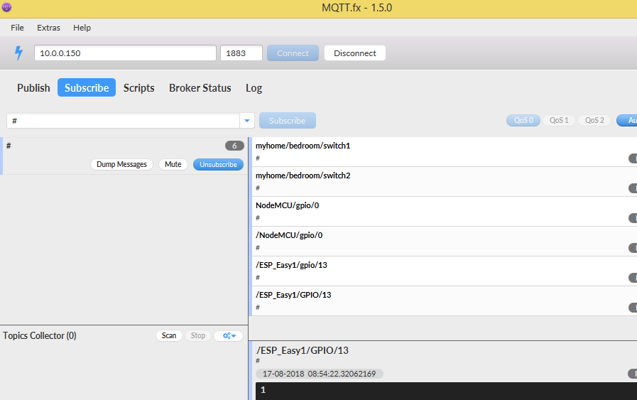

I'm using MQTT.fx and MQTT spy to see the messages to/from. I can see messages coming from OH2 but nothing coming from or being consumed by ESPEasy.
I've tried connecting to my localhost:1883 via name and IP. I've tried connecting to test.mosquitto.org in case it was a localhost issue but all fail. I've tried with authentication and without.

What broker are you using? (or am I in need of new coffee and did you mention it? I did see test.mosquito.org )
As far as I can see MQTT.fx (I just installed it here to see what it was) is just a client.
So ESPeasy and OpenHab must both connect to the same broker (and also your MQTT.fx to see the messages)
And what topics do you try to subscribe to?
When using "#" as subscription, you get to see all messages sent through the broker.

I'm using eclipse mosquito 3.1 as the broker. I thought mqtt.fx had it's own broker but I just found mosquito 3.1 running in the background from a previous attempt to get it running before moving to mqtt.fx.
I have been subscribing to all topics # locally and also narrowing the topics down when using a cloud broker (ESP_Easy1/#)

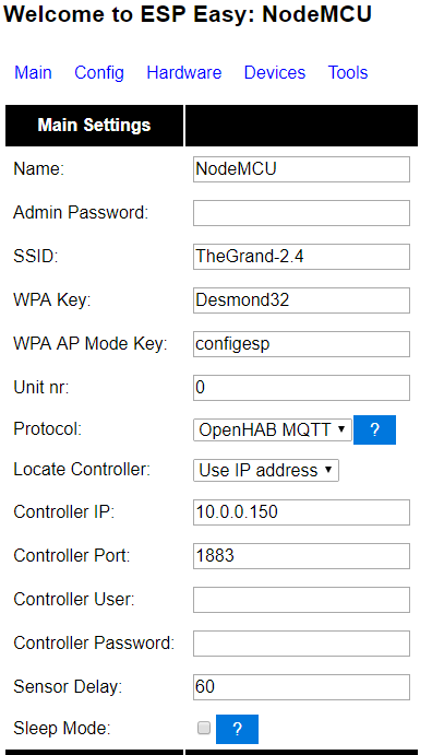

I just reflashed a NodeMCU esp8266 that I have with r120 to see if I could see messages through that.
The install went fine and I can address it through the browser to turn an LED on/off (http://10.0.0.198/control?cmd=GPIO,13,1 http://10.0.0.198/control?cmd=GPIO,13,0) But it still won't talk to mosquito on 10.0.0.150?

I see that your main settings page is missing the Controller User and Password. Just a reminder: Be sure to populate those two fields with your MQTT login.
