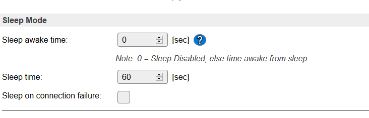

I have changed settings to
wake 60
sleep 0
but device does not go to sleep, even after reboot?
What am I missing?
Re: deep sleep with manual wake up - how?
#5 Post by grovkillen » 05 Dec 2018, 20:15
I know the wiki is being converted to RTD (read the docs) and I will update all info to be on same level as the code. You need to connect D0 to high (VCC/3.3V) for the unit to go into deep sleep.

#6 Post by TungstenE2 » 05 Dec 2018, 21:38
thx, that part was missing.
working now!
