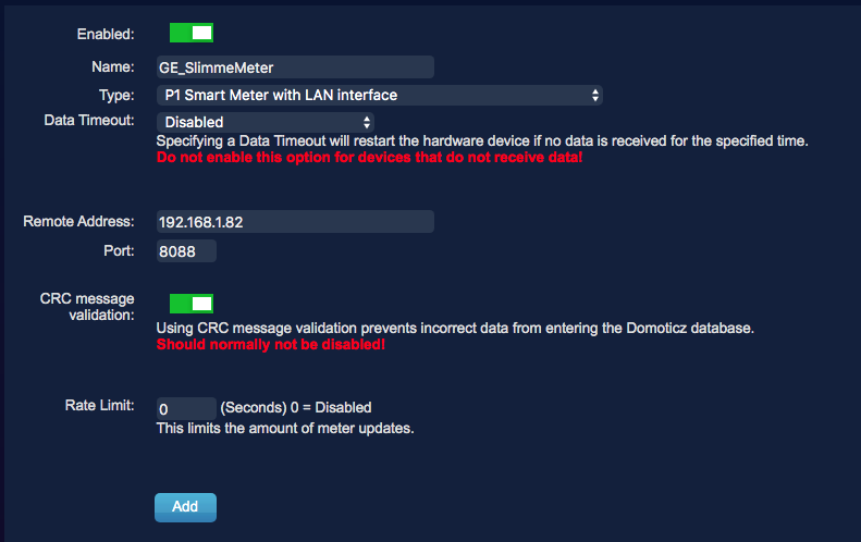

Create "P1 Smart Meter with LAN interface" in the HW interface of Domoticz

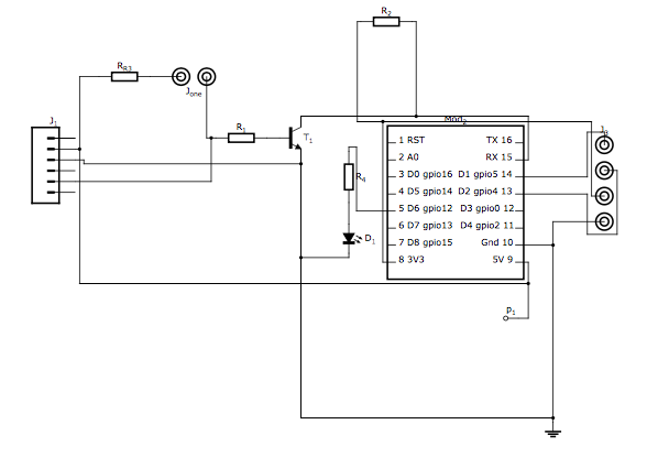

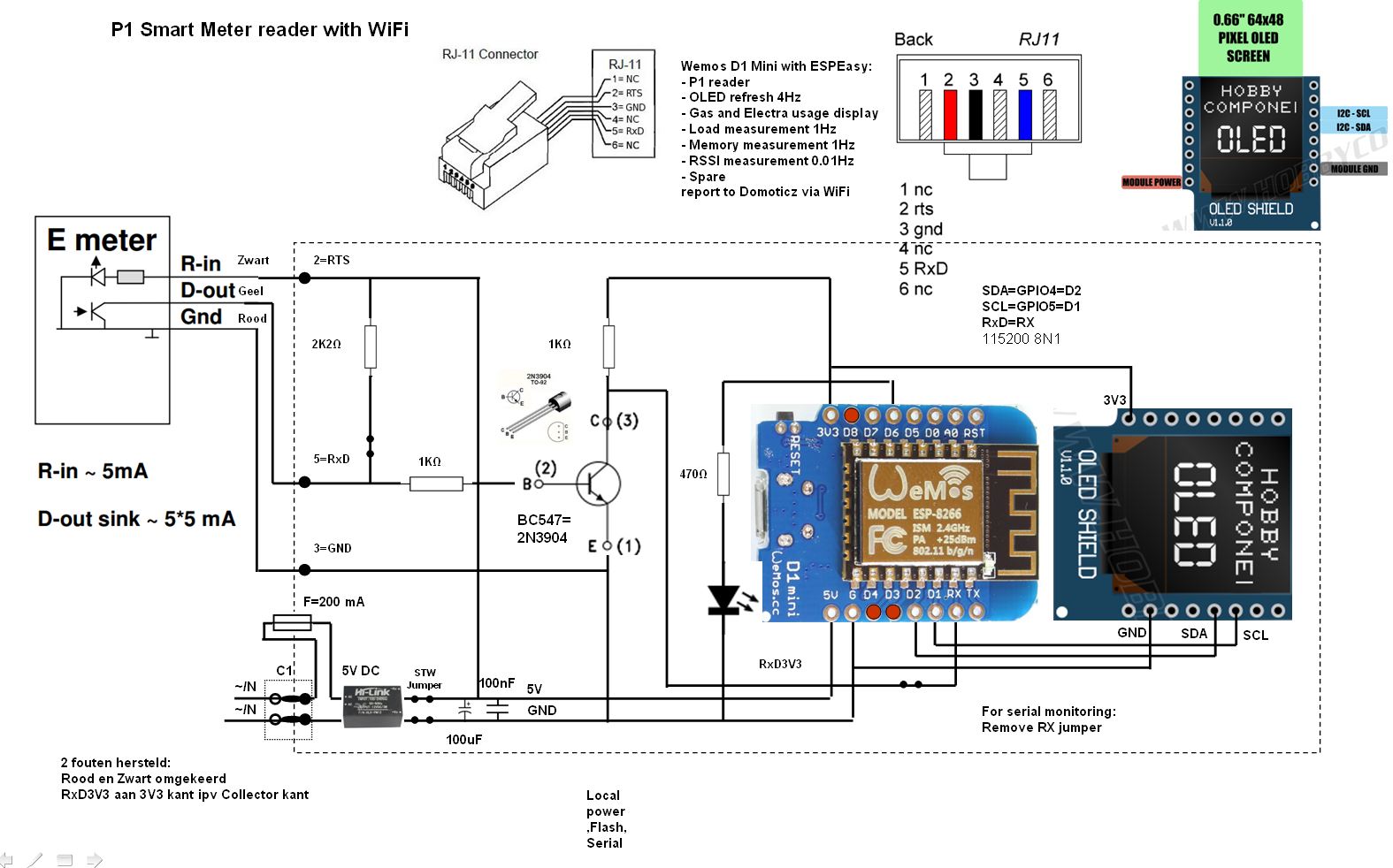

I use this connection diagram OLED is useless for local P1 values.
TCP Port 8088

I have made what is in your connection diagram. Instead of your Wemos I use a ESP-01 board.
When I measure with my osciloscoop on point (2) and (3) I see every second a burst of ones and zeros. At point (3) it's inverted.

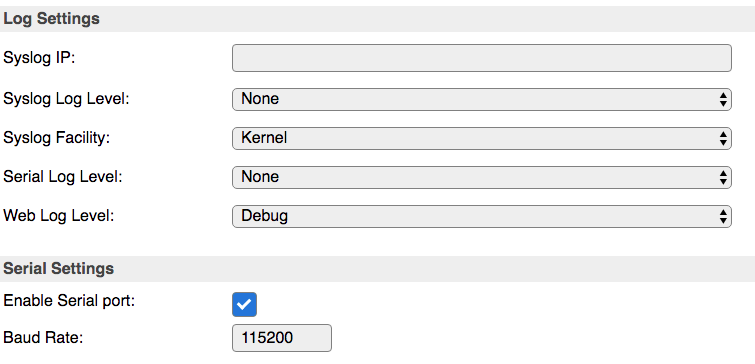

Where do I set the Serial log level to 0?

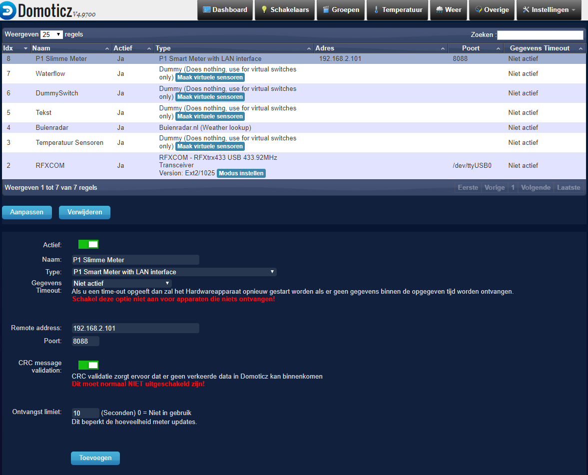

If I create "P1 Smart Meter with LAN interface" I see it in the Hardware list, but not in the 'Overige' tab.

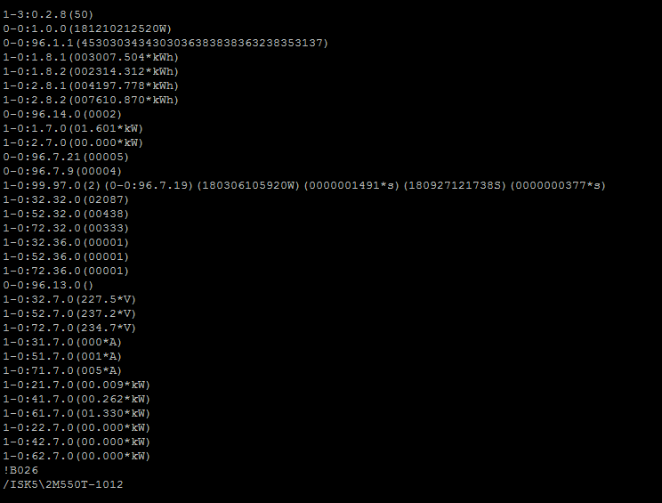

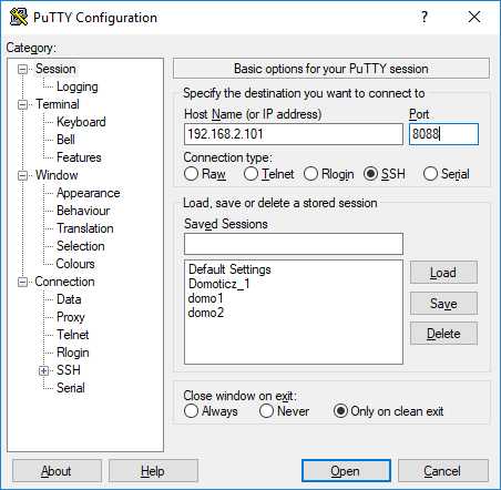

Can I use Putty to see if the ESP-01 gives characters? If yes, how do I configure Putty?
- Putty.png (17.01 KiB) Viewed 58331 times

ESP Easy, Tools, Advanced, Serial log levelWhere do I set the Serial log level to 0?

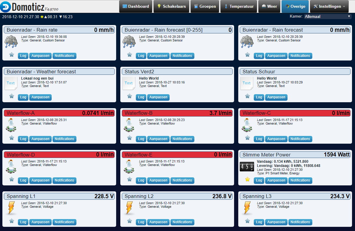

Check Domoticz tab Devices, filter on P1, you should see 2 devices: Energy and Gas.
If they have a green arrow, click on it, to make it blue.
Then they should appear in the Utility Tab (refresh it!)
Yes, but one connection at the time! If Putty is connected, then no Domoticz and the other way aroundCan I use Putty to see if the ESP-01 gives characters? If yes, how do I configure Putty?
Reboot the ESP in-between
Stop/Start the P1 in Domoticz to re-start the connection

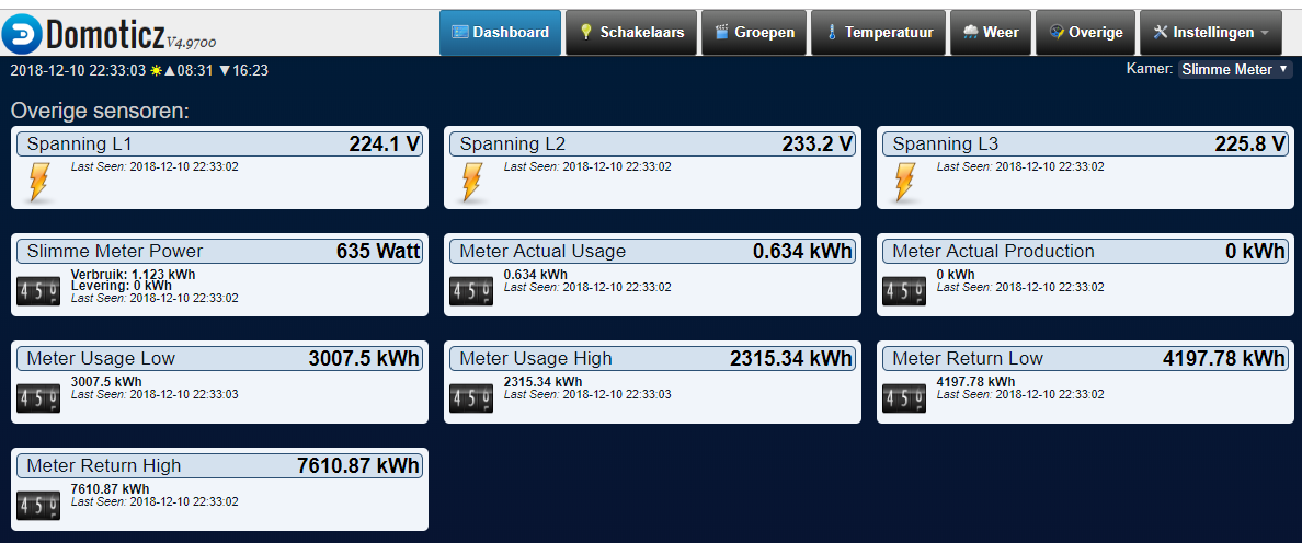

Many thanks, it works, super.
Is there a possibility to see in Domoticz also the other data from the smart meter? For example, the cummulative data. Can I program something with lua or DZVents?

I followed the advices above and got readings using Putty from the P1 port of the smart meter: T210-D ESMR5
ESP-Easy version ESP_Easy_mega-20191003_normal_ESP8266_4M1M.bin on a node-MCU, circuit and parameters as shown by Domosapiens and DomoticaRob, Domoticz (running on a Synology DS212J) : P1 Smart Meter with LAN interface with parameters as shown
Runs perfectly

i add on domoticz P1 Smart Meter with LAN interface and on log i have :
2019-12-08 16:58:57.521 Status: P1MeterTCP: attempt connect to 192.168.1.22:8088
2019-12-08 16:58:57.524 Status: P1MeterTCP: connected to: 192.168.1.22:8088
but nothing on tab Devices, i don't have P1XXX when i filter all list

Did you configure the device in Domoticz?

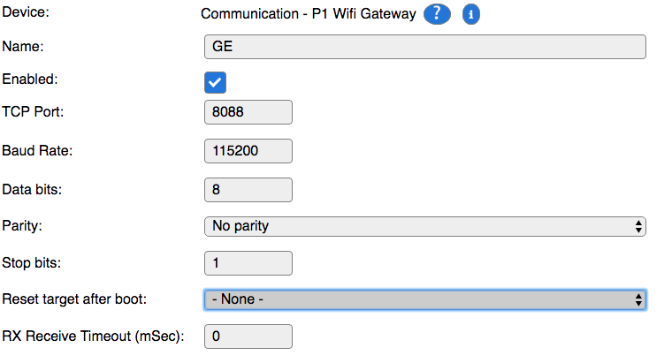

Re: ESPEasy P1 wifi gateway GPIO Idx
yes on domoticz :
and on domoticz logs :
on esp :
Les is blinking on pcb and when i try to filter on hardware tab i find nithing :
Thanks for your help

Your P1Meter plugin settings are for a DSMR 4.0/4.2 compatible meter. Any chance your meter is a DSMR 2.2 meter instead?
Ok, then your P1Meter plugin settings seem reasonable.no is a 5.0 sagemcom T211-D
I believe that the gateway plugin was written before DSMR 5.x was released. Have you searched to see if anyone has had success using DSMR 5 with the plugin?
Maybe the Web log (set to debug) will show something useful. Beyond that, I've run out of ideas to help out.

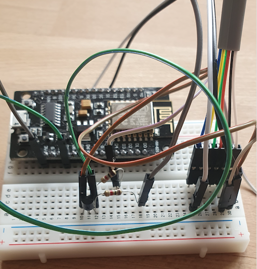

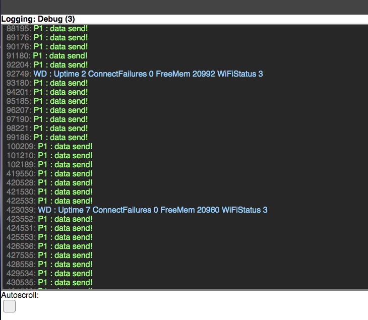

Hi, I would like to troubleshoot my setup. It seems to work but no data is coming out.
What I have:
Iskra AM550-ED1.01 SRM5.0 (E0043) year 2017
RJ12 - 6 Pins Dupont-Jumper Adapter - P1 Kabel Compatible (colours doesn’t match with any of provided in examples so I used pin output descriptions)
NodeMCU v3 (2x 1K resistors and BC547)
Before soldering anything I tried it out on a breadboard, this is the setup:
Screenshot below.
VIN --------------------- > Pin 1 (5v)
G --------------------- > Pin 6 (should be ground, btw i also tried Pin 3)
BC547 Emitter -------- > G
BC547 Base ------------ > 1K resistor ------- > Pin 5 (should be data out)
BC547 Collector ------ > RX & 1K resistor ( 1K resistor ------ > 3v)
When connected to P1 everything seems to work, NodeMCU is powered by the meter but no data.
Even with Web Log Level ‘Debug’ nothing in log.
My starting point was this site https://infi.nl/nieuws/hobbyproject-sli ... aar-later/ (on this site i found instructions and fritzing diagram) and then a lot of google.
Any advice?
Screenshots of Setup, ESPEasy & Domoticz settings & log files:
What I have:
Screenshot below.
Any advice?
Did you also connect Pin 2 as shown in the docs? I don't see it in your list.Before soldering anything I tried it out on a breadboard, this is the setup:
Screenshot below.
Hi Thomas, thank you for your replay.
No I didn't tried that yet. If I read it correctly, Pin 2 should be connected as following:
Pin 2 ---- > 2K2 resistor --- > 5v on one end of resistor,
other end should be connected to Pin 5 before 1K resistor.
I will order 2K2 resistor and probably could test it on tuesday.
Yes, a 2.2K resistor typically connects Pin 5 (RXD) to 5V.No I didn't tried that yet. If I read it correctly, Pin 2 should be connected as following:
But Pin 2 (the Ready-to-Send signal) needs 5V, so Pin 2 would connect to Pin 1 (5V). It does not appear you've connected Pin 2.
These details are shown in this discussion.
https://www.letscontrolit.com/forum/vie ... 168#p33682
For reference, here is the meter interface in a ESMRv5.0 P1 Port type meter:
http://domoticx.com/wp-content/uploads/ ... ematic.png
It would be wise if you provided a link to the information source you are using so we can see the circuit drawing you are following.
Edit: You've chosen to power your ESPBoard from the meter's 5V output. Be sure to consult the meter mfg's specifications to ensure it can safely supply the max current needed by your external circuitry.
Hi Thomas,
Thank you for your feedback, it provides clear picture how should this be connected.
The first source is https://infi.nl/nieuws/hobbyproject-sli ... aar-later/ it is in Dutch
diagram from the source https://infi.nl/files/nieuws/_medium/We ... tch_bb.png
The first source used other site it is also in Dutch but has better diagram http://www.esp8266thingies.nl/wp/
diagram from the second source http://www.esp8266thingies.nl/wp/wp-con ... .43.23.png
-What additional power sources do you advice to use? (just in case)
The fritz board drawing seems odd, only two resistors installed. But the author also shows his final PCB, which has four resistors.diagram from the source https://infi.nl/files/nieuws/_medium/We ... tch_bb.png
The drawing in the second source is about the same as the one in the discussion link I provided before, so it seems legit. The 5V power is not provided by the meter, an external 5V supply is used.diagram from the second source http://www.esp8266thingies.nl/wp/wp-con ... .43.23.png
The typical EPSEasy project is powered by a good quality 5VDC regulated supply, such as a USB wall wart. Although common ESP82266 boards draw up to about 250mA, the power supply should be rated for at least 1A to avoid brownout problems. I usually add an electrolytic cap directly on the pads for the ESP8266 module's power input (for example, 470uF/10V).What additional power sources do you advice to use? (just in case)
Your utility meter may be able to reliably provide the 5VDC needed to power everything. But I suggest you consult its data sheet to confirm it can handle the current your project needs.

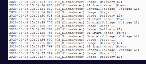

Hi Thomas,
Thank you for you support. The solution was to connect Pin 2 as described in discussion above. Now I can start soldering, building housing and add some dashboards.
-Drako
-Drako
Great to hear you solved the problem.
ThomasB wrote: ↑17 May 2020, 23:41The fritz board drawing seems odd, only two resistors installed. But the author also shows his final PCB, which has four resistors.diagram from the source https://infi.nl/files/nieuws/_medium/We ... tch_bb.png
The drawing indeed shows the dsmr4.x version.
The current pcb uses all six pins on the RJ-11. It can be powered by the esmr5 meter. A 3300uf 16v elco buffers for the peak currents drawn by the esp8266. For most meters you need three resistors for data as shown in the png on esp8266 thingies, the 2k2 serving as a pull-up on the data lime. The fourth resistor in the pcb is for the statusled on D6, which will not do anything in the mega version of espeasy.
