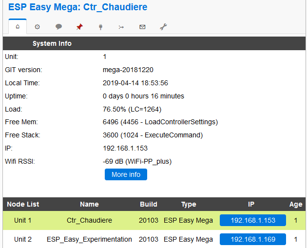

I have same problem and cannot find what i am doing wrong ...
Here is config of first esp config of second esp is identical Config of UDP controller same in the 2 Esp : I use dummy device in task 12 In the tutorial it is indicated that the task that is shared via udp is created automatically in all the participant esp units
But this is not the case in my application
Also when I create a task in the other unit and share it over upd controller the values are not updated
See below the setting of task 12 in one of the units Can an advanced user explain what I do wrong
Thanks in advance

ESP Easy P2P is "automatically" detected and if you want the devices to share data you need to address that in the advanced settings menu...

I found only this in the advanced settings Is this what you means ?
Patou
Thanks for your quick reaction
Patou

Correct, that's the port setting.
Additional choose under the tab Controllers the ESPEasy P2P Networking.
It's somewhat legacy that activation and port setting are on different places.

OK thanks
found my error
I choose generic udp controller instead of p2p udp
Thanks for your help
