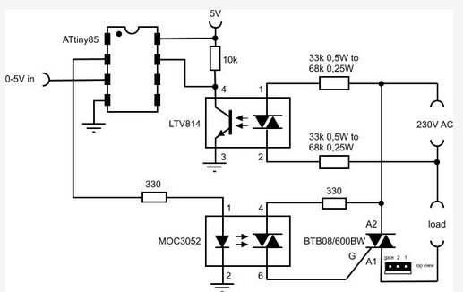

Have a look at this post https://forum.arduino.cc/index.php?topic=314773.0
Looks that this circuit can be fet with analog voltage ( pwm + filter can be OK)
Patou

the circuit itself does *nothing* withtout a proper firmware loaded into the ATtiny85; acually it's the same circuit of the initial post with added microcontroller to handle the synchronization with the main voltage frequency...

And on top to papperone's post, the circuit has definitely no protection to voltage spikes.
Not even a poor & cheap R/C-combo. Happy triac killing ?!
But basically that's one possible way to do the job with some electronics around.
A firmware for the ATTiny does not need witchcraft.
It might be a counter just counting up, resetted via INT-input from the zero cross detection.
The analog voltage gives a digital value that is compared to the counter and drives the
triac circuit if counter > analog value.
The only point that will need some experimenting is the counter clock speed.
As it should give as many dimming steps as possible it should be finetuned so counting to the max
should take 10ms (50Hz) or 8.3ms (60Hz). Some adaptions might be needed to get correct
voltage levels for the analog input too.
If you want to use ESP's PWM that should work. A little R/C-R/C lowpass filter behind the PWM output
changes the PWM into analog voltage.
