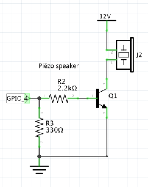

Howdee folks,
Are there any plans to support the MQ2 smoke detectors? I little while ago I experimented with them and they work pretty well. I was planning to have multiple sensors in the house with MQ2s all with loud piezo buzzers. I made some code in Lua that allowed a sensor to send an alarm to domoticz after which all other sensors in the house start buzzing as well. Next step was supporting UDP so I could send out an ALARM broadcast over the network which doesn't require Domoticz to trigger the alarms.
Anyway... I thought it would be nice to switch to ESPEasy for this. Together with some alarm logic as described above, this could easily turn into a nice alarm system.
The MQ2 requires an ADC connection and 5V. A loud Piezo can work with 12V. They are pretty loud :).

See my schema above. You can use a voltage divider and connect that to the ESP.

I have also used a voltage divider.
