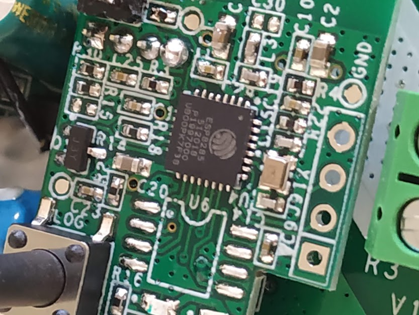

Tasmota guy, arendst , posted the following :
"...As the ESP8285 uses DOUT SPI flash comms, GPIO9 (pin 18 = pin 7 of U6) and GPIO10 (pin 19 = pin 3 on U6) are available for user connections.
No other SPI signals can be used as they are connected to the internal flash...."
Meaning the U6 can be populated with flash and run the full size MEGA version of ESPEasy.
Anyone tried this yet ?
-D

#4 Post by ThomasB » 03 Aug 2019, 19:09
I wonder if it is just as simple as soldering on the chip...
From what I see in the PCB photo I would expect it to be that simple.
