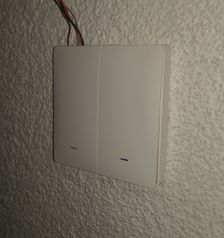

Hey folks,
I found a very nice smart Switch, with physical buttons and easy to reach contacts on ESP. Since I am very happy with this switch I would like to recommend it to others.
The Switch I used is the Zemismart Switch (ZM-L02E) AliExpress
Below there is an image of the final result. The wire goes to a motion sensor, a temperature/pressure/humidity sensor and a light sensor.
For more information visit my documentation on github

Re: Zemismart-Switch-Modification
Hmm nice one.
Do you happen to have a picture of the other side of the PCB?
It looks like you can remove the ESP module , but I wonder how it does look like on the other side.
To be honest, I didn't get the circuit board out. I levered it with a screwdriver as hard as I dared and until the circuit board made crack noises. You can look in through slots on the side, but I didn't see any reason why one can' t get it out of the plastic case. I didn't want to break it either and since I didn't have to take it out I left it there.
What I really like is the haptic feedback. The switches have a pleasant pressure point and make a quiet click when you have pressed them. I will definitely order more of them and then try again to take a look at the back of the board.
