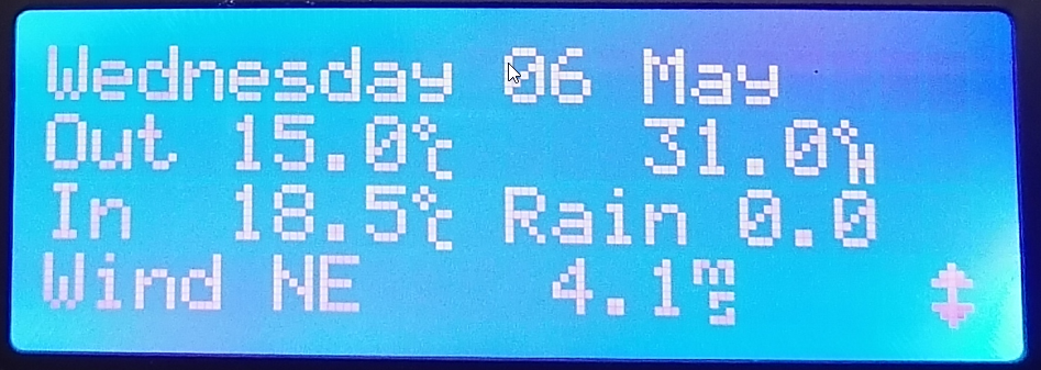

A bit late to answer but here's my experience : I modified P012 to add some special chars, it works see pic.
When I try to add them to an HTTP URL in order to display them from a Domoticz script, I can call them using that :
00 %08
01 %01
02 No way, not %02 or %09
03 No way, not %03 or %0a
04 %04
05 %05
I'll try with other value but I think 06 and 07 may work so I may just skip 02 & 03...

Thanks. I just skipped special char 2 & 3 and. Here's the result and the code:
2020-05-06 11_23_25-IMG_20200506_110359..png (749.5 KiB) Viewed 24341 times

And for dzVents :
-- ~/domoticz/scripts/dzVents/KitchenTestClock.lua
-- Send text to LCD attached to a Wemos ESpeasy
     return {
	    active = true,
            on = {
         	 timer = {'every minute'}
	    execute = function(domoticz)
	    local LCDSTR
-- Script parameters EDIT HERE ***************************************************************************
		local Debug = "No"
		local CustLCD ="Yes" -- Use Yes for custom LCD characters if you uploaded custom P012 LCD
		local MyLCD ="http://172.19.0.221/control?cmd=LCD,"
	    local MySensor1 = "Room-Pergola" -- outside T & H
	    local MySensor2 = "Room-Kitchen" -- inside T
	    local MySensor3 = "Rain Accuweather" -- rain
	    local MySensor4 = "Wind Accuweather" -- wind
		local MySensor5 = "Old Accuweather" -- Fake sensor for previous atmospheric pressure
		local MyVar = "BarometricTendency" -- Global variable that store a Char (v,-,^)
-- Functions
	    function DtoD(x)
		    local Winder = {"N","NNE","NE","ENE","E","ESE","SE","SSE","S","SSW","SW","WSW","W","WNW","NW","NNW"}
		    local WinDex = math.floor(x/22.5+0.5)
		--print(WinDex)
		--print(Winder[WinDex])
		return Winder[WinDex]
	    end
-- Main CODE
	    local outside = domoticz.devices(MySensor1)
        local inside = domoticz.devices(MySensor2)
        local Srain = domoticz.devices(MySensor3)
	    local SEwind = domoticz.devices(MySensor4)
	    local OPressure = domoticz.devices(MySensor5)
	    local STRG = DtoD(SEwind.direction)
		local Btrend = domoticz.variables(MyVar).value
		LCDSTR=  MyLCD .."1,1,".. os.date("%A") .. "%A0" ..os.date("%d") .."%A0" .. os.date("%B")
		os.execute('curl -s ' ..LCDSTR)
		if CustLCD =="Yes" then
			LCDSTR = MyLCD .."2,1,Out%A0" .. string.format("%.1f",outside.temperature) .."%07"
			LCDSTR=  MyLCD .."2,14,".. string.format("%.1f",outside.humidity) .."%04"
			LCDSTR=  MyLCD.. "3,1,In%A0%A0".. string.format("%.1f",inside.temperature) .."%07"
			LCDSTR=  MyLCD .."3,11,Rain%A0".. string.format("%.1f",Srain.rainRate) .."%20"
			LCDSTR=  MyLCD .."4,1,Wind%A0".. STRG
			LCDSTR=  MyLCD .."4,12,".. string.format("%.1f",SEwind.speed) .."%05"
			if Btrend == "^" then
				LCDSTR=  MyLCD .."4,20,%00"
			elseif Btrend == "v" then
				LCDSTR=  MyLCD .."4,20,%06"
				LCDSTR=  MyLCD .."4,20,%01"
			end
			LCDSTR = MyLCD .."2,1,Out%A0" .. string.format("%.1f",outside.temperature) .."%C2%B0C"
			LCDSTR=  MyLCD .."2,14,".. string.format("%.0f",outside.humidity) .."%H"
			LCDSTR=  MyLCD.. "3,1,In%A0%A0".. string.format("%.1f",inside.temperature) .."%C2%B0C"
			LCDSTR=  MyLCD .."3,12,Rain%A0".. string.format("%.1f",Srain.rainRate)
			LCDSTR=  MyLCD .."4,12,".. string.format("%.1f",SEwind.speed) .."m/s"
			LCDSTR=  MyLCD .."4,20," .. Btrend
		end
  		if Debug=="Yes" then
	        domoticz.log('Temp is ' ..string.format("%.1f",TSensor.temperature))
		    domoticz.log('Humidity is ' ..string.format("%.1f",TSensor.humidity))
		    domoticz.log(LCDSTR)
		end
        end

Grumpf
Posts: 124
Joined: 05 May 2017, 23:45
Location: Namur
Re: 4x20 LCD custom characters
#6 Post by Grumpf » 14 Jul 2020, 12:10
If you look at my modified P012.ino code, it's below the ////Grumpf////
You just have to create your character and replace it.
https://maxpromer.github.io/LCD-Character-Creator/
