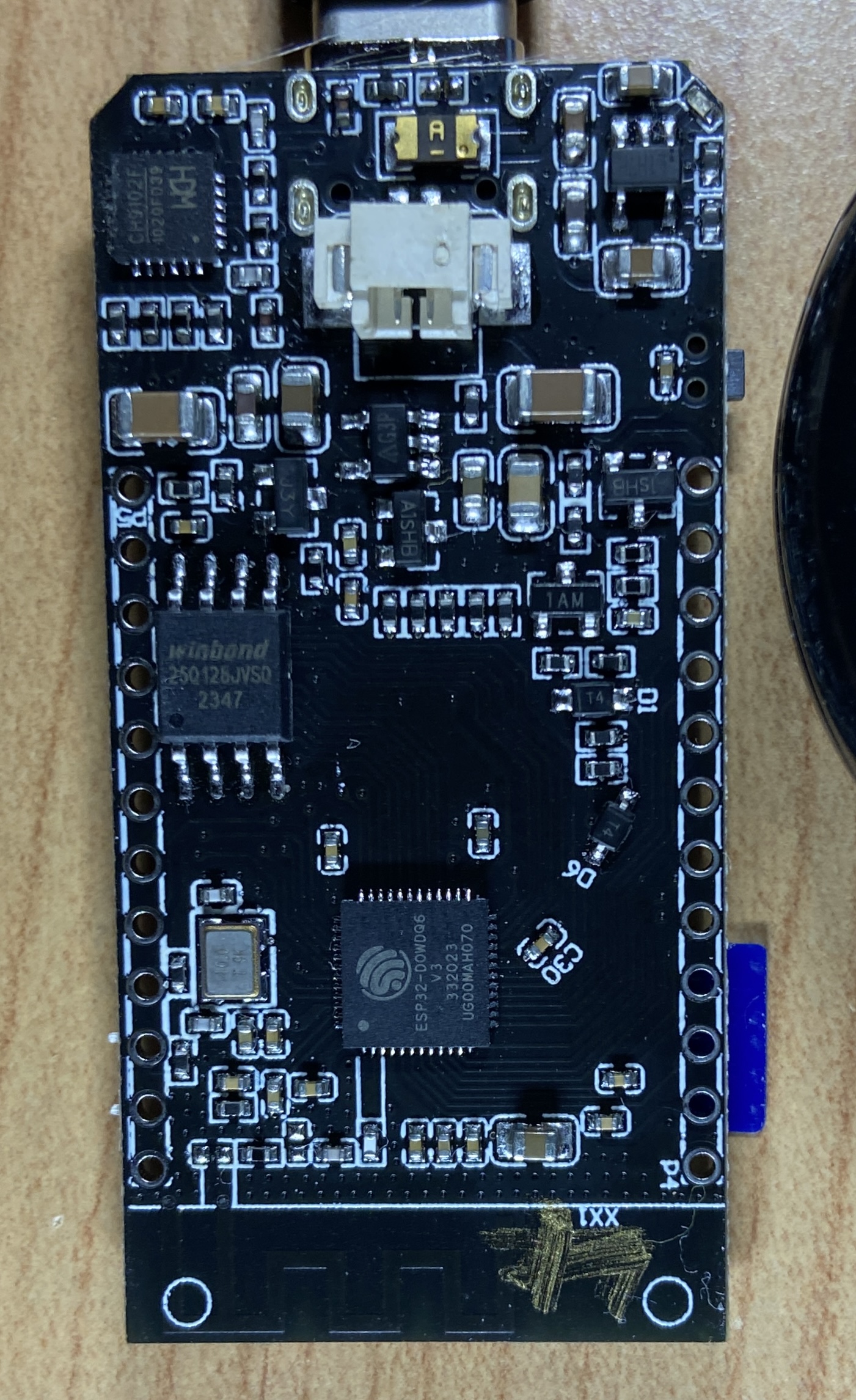

Well, I took a picture of the device and enlarged it. I only can identify the ESP32, the CP2102 and the Flash storage. I guess the graphics chip is underneath the display ...
Any other way/tool to identify the chip or test the SPI interface?

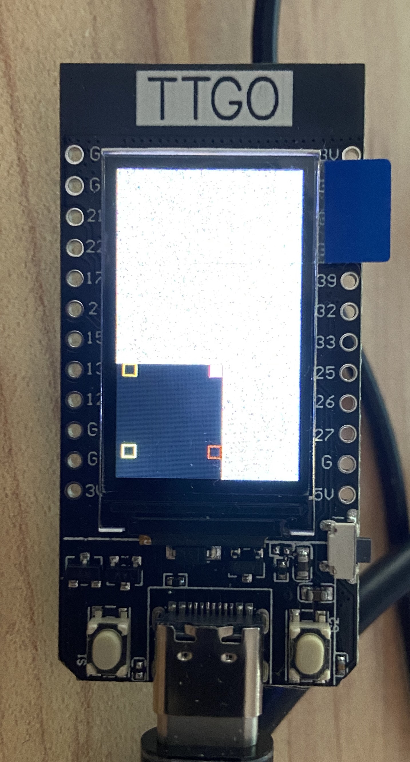

Well, I can offer you the attached photo.Ogn the front it only says TTGO, just like this one https://espeasy.readthedocs.io/en/lates ... 0_ttgo.png

I still have only a dark grey screen, so it's hard to read if (at all) anything is displayed. I changed the font size to factor 5 with white text on red background. I don't see any change.
Is my SPI configuration correct? Since the device was shown on the plugin page, I thought the correct configuration was just a question of looking it up and providing the information. Am I the only one using that device???

The markings on the board are quite minimal, so not much to detect there. It does have 16MB Flash, as displayed, and the Winbond 25Q128 chip confirms that too.
At the official lilygo product page I think I've found this 16MB board, the one marked "T-Display [DE]" should be available in 4MB and 16MB, like yours, but there is no indication of other hardware differences. The flash chips are 1:1 pin-compatible, so it can still use a single board revision.
My board is probably the same revision, as it has the same XX1 printed near the antenna, it's just equipped with 4MB Flash. And that's working as intended
Technically, it's possible the display is broken.

Re: Is it possible to use LCDs with ST7735&ST7739 controllers??
Current state:
flashed Y:\Temp\Bin-ESP32-max_ESP32_16M8M_LittleFS-20240309_PR_5003_8215939347\ESP_Easy_mega_20240309_max_ESP32_16M8M_LittleFS.factory.bin
configured hardware and device
accidentially TFT display model was set to ST7735 -> bright screen, little white square, rest looke like tv snow after end of broadcast
corrected TFT display model to ST7789 -> the usual dark grey screen, can't identofy text in line 1
corrected TFT display model to ST7789 (alt 1)-> gpio,4,1-> no effect, st77xx,txt,Hallo -> no effect
corrected TFT display model to ST7789 (alt 2)-> gpio,4,1-> no effect, st77xx,txt,Hallo -> no effect
corrected TFT display model to ST7789 (alt 3)-> gpio,4,1-> no effect, st77xx,txt,Hallo -> no effect
changed to TFT display ST7735 again, at least I get a white square, gpio,4,1-> has effect, st77xx,txz,64,64,XXX -> shows text
looks like the ST7735 is working pretty well, just that the geometrics of the display is not correct and there is an offset
next checks:
flashed Y:\Temp\Bin-ESP32-display_ESP32_4M316k-20240309_PR_5003_8215939347\ESP_Easy_mega_20240309_display_ESP32_4M316k.factory.bin
no chnage vs. the max version. All ST7789 settings remain dead, ST7735 works better

The TTGO device has a Flash Chip Real Size of 16384 kB, which would allow me to flash the max version of ESP with all sensors/devices.
- HX711 -> is in Collection A
- SSD1396 -> is in NORMAL DISPLAY CLIMATE

I've been able to fix this issue, by adding the 135x240 resolution for the ST7735 driver, as that's what this T-Display unit seems to be using.
This GH Actions run can be used for testing.
