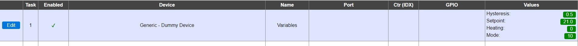

Devices:

Hello! The thermostat was made according to your YouTube video. Can you please tell me how to implement the hysteresis function of the controlled Domoticz? I set up the transmission of the hysteresis value from Domoticz, but I haven't figured out how to apply it in the rules yet.
on RoomControl do
if [HTU21d#Temperature]<[Variables#Setpoint]+[Variables#Hysteresis] // ?????? It doesn't work like that

Re: Control ESPEasy-thermostat -> Rules problem
#13 Post by Ath » 07 Jan 2021, 22:28
Doing calculations in comparisons isn't working (yet), so it should be something like:
on RoomControl do
  Let,1,[Variables#Setpoint]+[Variables#Hysteresis] // Assuming that var#1 isn't used yet...
  if [HTU21d#Temperature]<[Var#1]
    TaskValueSet,1,3,1
lex007112
Posts: 4
Joined: 07 Jan 2021, 17:34
Re: Контроль ESPEasy-термостат -
#14 Post by lex007112 » 08 Jan 2021, 06:59
Ath wrote: 07 Jan 2021, 22:28 Doing calculations in comparisons isn't working (yet), so it should be something like:
on RoomControl do
    TaskValueSet,1,3,1
Hello, I'm new to this business.If anything, sorry for google translation))). So the value, in your example, assigned to Let, 1,[Variables#Setpoint]+[Variables#Hysteresis] equals [Var # 1]. Or should it be prescribed somewhere else in the rules?For Let, 1 and Var # 1. And where to specify Let, 1 .... Let, 2 ... in the rules immediately before the "if" or you can define all the values "Let, 1 ... Let, 2" after the "System # Boot ...endon " block at the beginning of the rules?
Did I understand correctly in the example?
#15 Post by Ath » 08 Jan 2021, 07:58
1) All Rules code has to be within an 'on ... do / endon' section (event-handler), any code outside of that is ignored.
2) You would want to compare the actual measurements/values, so the assignment 'Let,1,...' should be done right before you do a comparison to it, by using its value [Var#1], so please use my example code.
3) Any event name in the rules should be used only once, so having 2 'on RoomControl do' events is causing more confusion then needed
on RoomControl do
  Let,1,[Variables#Setpoint]-[Variables#Hysteresis]
  Let,2,[Variables#Setpoint]+[Variables#Hysteresis]
  if [HTU21d#Temperature]<=[Var#1]
    TaskValueSet,1,3,1
  if [HTU21d#Temperature]>=[Var#2]
    TaskValueSet,1,3,0

Ath wrote: 08 Jan 2021, 07:58 1) All Rules code has to be within an 'on ... do / endon' section (event-handler), any code outside of that is ignored.
on RoomControl do
    TaskValueSet,1,3,1
    TaskValueSet,1,3,0
(And the endif/if could be changed to elseif, but that's just a small optimization)
Under this condition, with a Setpoint value of, for example, 25 degrees, hysteresis 1 turns on correctly at 24, and turns off at 24.1, but should turn off at 26 degrees, what is the reason?
Those. the following condition does not work:
#18 Post by Ath » 08 Jan 2021, 20:33
lex007112 wrote: 08 Jan 2021, 19:59 Those. the following condition does not work:
Well, I just copied your code and moved it around a bit :D
You can add a line to the log to view the actual values that are used for the comparisons, like this:
  LogEntry,"Temp: [HTU21d#Temperature], V1: [Var#1], V2: [Var#2]"
Insert that just before the first 'if' statement, and view the log either via the serial output or from the Tools/Log page.
lex007112
Posts: 4
#19 Post by lex007112 » 08 Jan 2021, 20:52
Ath wrote: 08 Jan 2021, 20:33
Friends, thanks for the help, I figured out what the reason was for removing the line at the end of the code:
On Rules#Timer=1 do
 TaskValueSet,1,3,0  //This prevented the hysteresis from working
 if [Variables#Mode]=10
  event,RoomControl
 if  [Variables#Mode]=0
  TaskValueSet,1,3,0
 event,relay
 timerSet,1,60
Deleted this line in the rules, and everything worked as it should. Because the code is not yours, therefore "reverse engineering" failed :D
Thanks again for participating ;)
