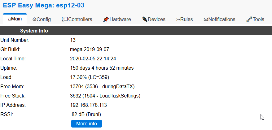

Today one of my devices (ESP12E) made the 150days online!
I have 2 DS18b20 connected and send data every 30s via UDP to influxdb...
looking forward for the next 150days...

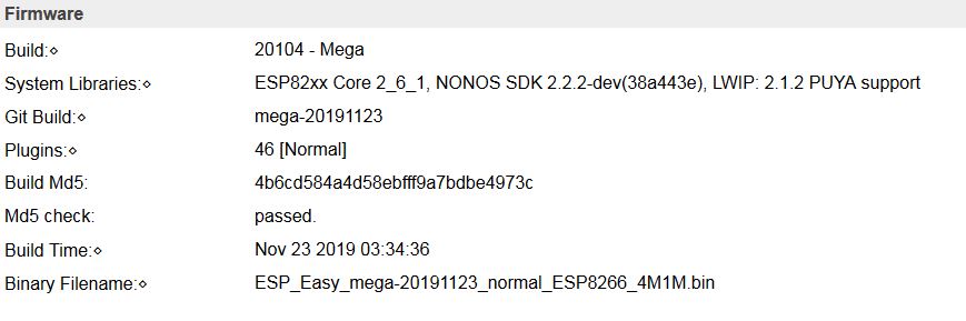

Great experience here with mega-20191116 Core260 running on 13 units.
Finally able to optimize/debug my application aspects.

Using
the recording graph of uptime in minutes changed dramatically:
This is only one example of several Wemos D1 with similar graphs containing the uptime in minutes.
So for me is the conclusion: Hardware Watchdog Timeout reboots are history.....
Thanks to the team, and special thanks @TD-er. Thumbs up.

...still alive now for 200 days!
- Clipboard01.png (26.82 KiB) Viewed 38295 times
