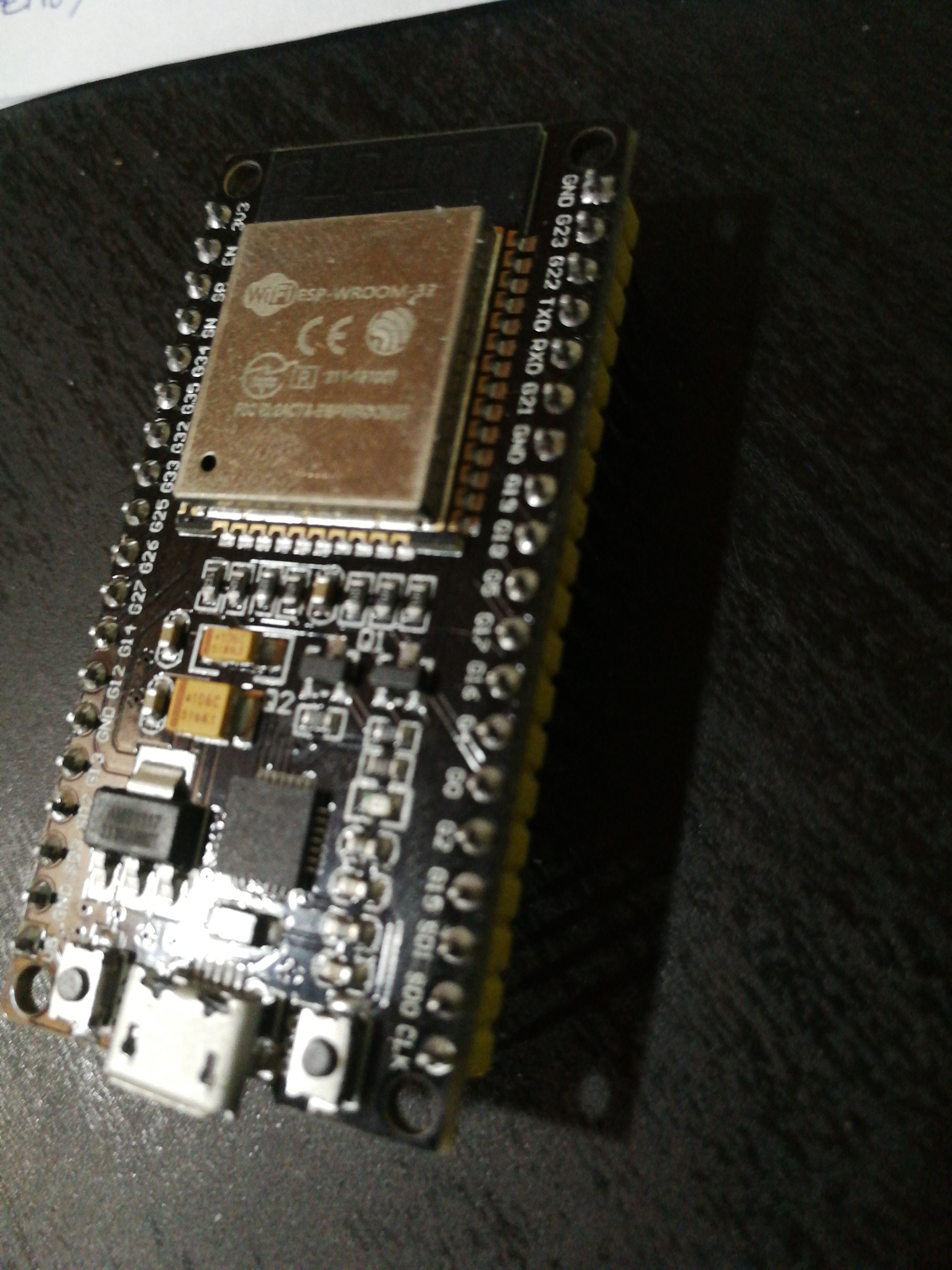

hi, i have three different ESP32 bought on aliexpress.
i fash them with espeasy without any problem, but i have a strange behavier when i power on them.
if i use usb cable, no problem at all.
if i use pin Vin and GND with a poer regulator of 5V i can see the web page of espeasy.
for sure is not the power suppy problem, i use this one to power up 6 esp8266, so i can exclude it
i see that if i connect before the usb cable, and after that connect the Vin and GND, the webpage will be visible and ESP32 do not crash.
i would like to use esp32 to connect 8ch relay and 8 switch
i create the task but if i use esp32 powered by USB cable i can sitch on/off the relays, if i use Vin and GND power (plus usb cable, otherwise as i explained usin only pins is not working the ESP32 power up) the relays are working.
these are my device:
https://ibb.co/nb1mH3L
look at the photo you can see same ESP32 wroom32 chip
i have two of those with yellow pin and one with black pins, but the behavier is the same for all my three ESP32
has someone this problem?
can someone suggest me on aliexpress a link where i can buy an ESP32 that can be programmed with espeasy that can use pins as power-up and can use relays+switch ?
thanks

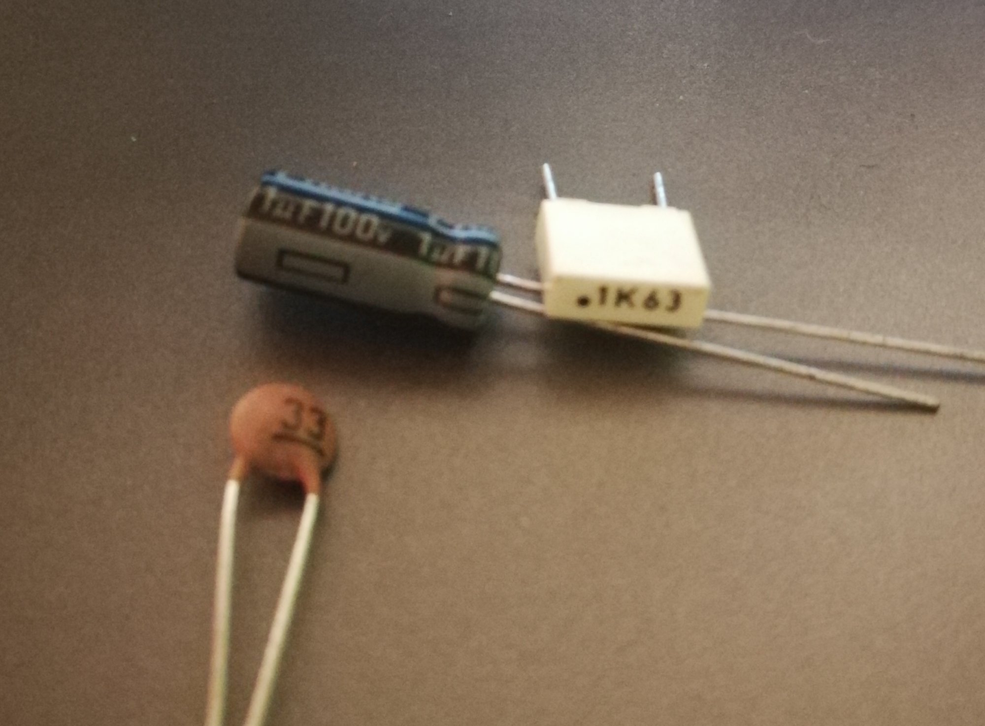

regarding capacitors, i find these three in my house...i tested everyone but the powering issue is not solved...why?

Hi, anyone that has this device and succeed on boot using vin and gnd pin?
If i use usb, i do not have any problem, if i use vin and gnd many times it not boot and the led continue to flash, somw times, very rarely it boot using vin and gnd.
With usb cable no issue.
I try to put condensator between en and gnd but no lucky.
I have another esp32 with black pin and it works. Suggesion?

hi TD-er i try with different capacitors, but without success.TD-er wrote: ↑29 Mar 2020, 16:05 There is an issue with some of these ESP32 boards.
If I remember correctly, the fix was to add a delay before pulling up the EN pin on the ESP.
So adding a capacitor + resistor should do the trick here.
See: https://randomnerdtutorials.com/solved- ... et-header/
then i power on the ESP32 alone, usin a power supply dedicated only to it, and now it boot without problems....
if i connect with all other esp sharing the same power supply it not boot. no problems with all other esp8266 connected.
i have a power supplier DIN rail with 230V AC in and 5V 12W DC out
connected to this power supply i have 6 nodemcu esp8266 plus n°2 pcf8574 that controls 28 relays.
i think that power supply power is more than enought!!
if i connect esp32 with black pins no issue, it boot also if it is connected with all others esp8266 and so on.
if i connect esp32 with yellow pins it not boot. I have two esp32 with yellow pins, both with same problems.
if i disconnect the esp8266 and the others stuff and power on only the esp32 yellow, it boot
why?!? do you have some ideas?
thanks
