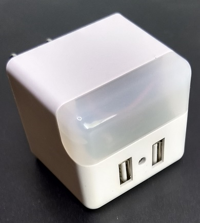

While searching the forum for "Action store" (a store that i like to visit on a regular base to find new cheap mod stuff), i found this USB charger that already has been modded once by someone else:
https://www.letscontrolit.com/forum/vie ... 71&p=34420
Because i recently said goodbye to all my ESP8266 modules, i wanted to see if an ESP32 would also fit in there. I had my doubts first because the module is bigger than the original Wemos D1 Mini based on ESP8266.
I decided to purchase one and followed most of the instructions provided in the other post.
And indeed, as exptected, i had to use the dremel tool a bit more agressive on this gadget to make it fit. Also had to remove the LED board, so now it is effectively no longer a "nachtlampje". But that wasn't my goal anyway.
In the end, both the ESP32 module and a shield on top will fit the cabinet. And whitout the cap, i can also access the USB port when needed for troubleshooting:

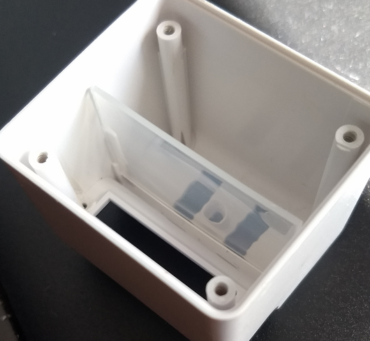

In this case, good isolation between the lower and upper half of the enclosure is important. For the prototype, i used a piece of plastic of 1.2 mm thickness like this, similar to the enclosure thickness itself. But i'm still looking for a piece of hard plastic that can be glued to the enclosure to avoid possible creepage between the edges.

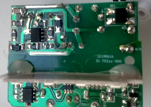

#6 Post by martinus » 23 Apr 2020, 14:53
I'm familiar with the basics of modern PSU devices. And seen some tests of the very cheap ones.
The thing with Chinese Manufacturing is that it can be hard to distinguish between cheap and too cheap.
I definitely stay away from the no-brand 1 euro direct import from ebay versions that according to several reviews make funny noises and tend to go up in smoke during heavy charging.
About the cheap ones available in local dutch stores? Hard to tell without proper testing equipment. They do have CE marking but i guess that only means "China Export" in these cases. It looks like they at least have learned about the 5 mm distance on the PCB between the high and low voltage areas:
The load in my case will be very moderate compared to actually charging a tablet or powerbank.
And i'm feeding the 5 volts only into the onboard regulator on the ESP32 module. So at least there's a second regulator in place and that could help out with the ripple issue if any.

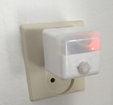

#7 Post by martinus » 29 Apr 2020, 16:47
Some more mechanical modding and I've found a possible purpose:
Running stable for several days, no false positives. No unexpected reboots.
