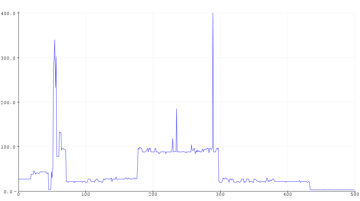

In order to checkout current consumption of the ESP doorsensor mod (using ESPNOW and controlling a servo on batteries) i decided to hookup an INA219 module to an old Arduino Nano module and used the Arduino IDE serial plotter to show exact current measures from boot till shut-down:
As the plotter only shows the last 500 points, i used a timescale of 2 ms/point. so the 500 at the right end means 1000 milliseconds.
The graph shows the 90 mA during normal operation, the high peaks around 350 mA and the radio-off moments that use around 20 mA.
This will really aid in verifying changes to the code for further optimization.As the plotter only shows the last 500 points, i used a timescale of 2 ms/point. so the 500 at the right end means 1000 milliseconds.

What range have you set for the current?
And are you measuring the current in front of a linear voltage regulator?

The range is set to 400 mA. Measuring the entire setup, so the modded doorsensor with the Arduino Pro Mini and the servo. The INA sensor is between the batteries and the Vbat connection of the doorsensor. It uses a step-up boost converter to provide the ESP and Servo with a constant 3.3 volts.
The Pro Mini is directly powered on VBat as well as the 'tuya' MCU.
I could adapt the lab setup to actually measure the current into the ESP module, but i'm actually only interested in the total current consumption as this will predict possible battery life.

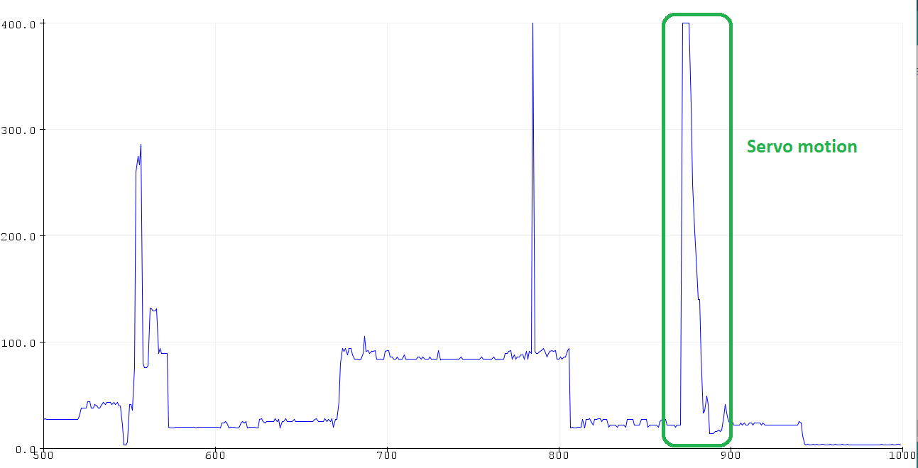

This sample also shows the (slight) servo motion in action: Looks like the start peak current when the servo starts to move is beyond the scale of 400 mA.

Almost forgot that the Arduino Nano has digital inputs to mimic a cheap logic analyzer and the Arduino Serial plotter can do multiple lines in the chart.
So i used GPIO-0 on the ESP to toggle at some given points in the rules engine and hooked up to an input on the Nano.
Gives more info on what happens at certain moments:
It looks like the sleep command does not do anything to reduce current. This needs some further checking.
Also notice that gpio-0 seems to produce 'noise' during bootloader stage.

About the sleep, it turns out that it does work like planned. The power-off as assumed in the previous graph was not true. I also measured VCC and used a 4 ms timescale, to find out that the VCC remains active for an additional second. The VCC is controlled by the tuya MCU so we have no control over that.
But during that additional second, the ESP is already into deepsleep and uses very little current.
And it seems that it takes about 100 mS before the sleep actually reduces the current after the ESP.deepSleep() command.
