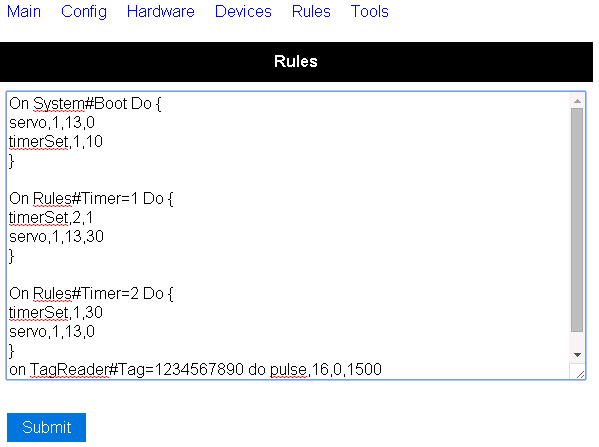

I have used a custom ESP Easy for my "RFID Tag reader test rig", looking like this: That would by my definition of "simple"...
We also have the "playground action event" plugin that might be able to do some basic stuff. I've also used that for the Tag reader test, but it took 5 tasks to manage the same result.

Well my "simple" idea supports only one simple logic rule:
on <event>[compare][value] do [{]<action>[,<action>,..}]
The idea was based on the old Nodo project were we had a similar set of oneliner event/actions.
You have posted an entire script like LUA that needs a full blown scripting engine to process it. And that's were my basic development skills end
(and if I knew how to integrate a LUA engine into ESP Easy, it will likely not fit the available free RAM)
