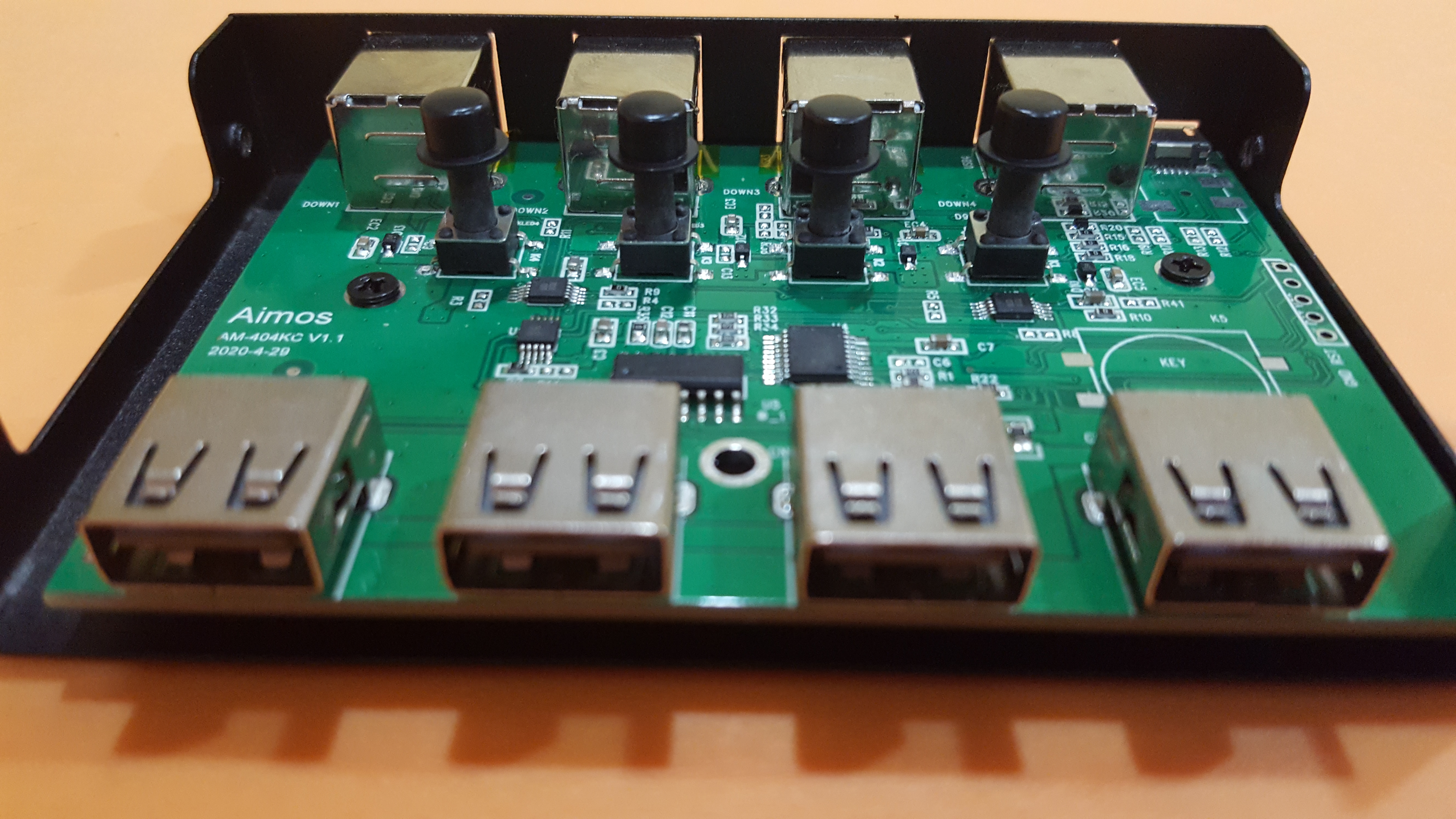

A few months ago i started a project at the topic USB KVM Switch modify project. That project failed for the reasons I mentioned on that page. So i decided to start a new project with a new KVM. This time i bought a KVM with 4 selection button. That KVM circuit has a micro usb port with 4+1 (ground). This provides port selection. So i decided to connect my nodemcu( already had a ir receiver and ir sender on it) and make that selection with ir remote. I also add a lcd(2004) for future requirements. So how would be the connection ?
I have nodemcu,ir led, ir receiver, PCF8574 GPIO extender also MCP23017, LCD 2004,TLP281 4 CH 4-Channel Opto-isolator IC Module. Is there anybody help me for connection?

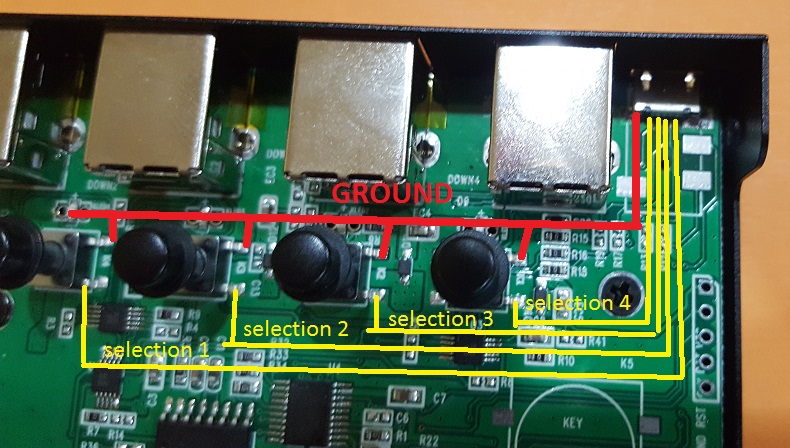

#5 Post by asuz » 22 Oct 2020, 21:48
TD-er wrote: 22 Oct 2020, 10:18 Well I think it isn't a bad idea here to use optocouplers to replace or override the switches.
After all you don't know if the switches are connected to GND or Vcc and changing impedance may affect the operation of the KVM switch.
You are right switches are connected to GND not Vcc so I realize that I do not need Vcc at the TLP281 Opto-isolator output side then i remove the J3Y transistor each channel and shorten them with a small wire. Now TLP281 Opto-isolator card act like a relay.

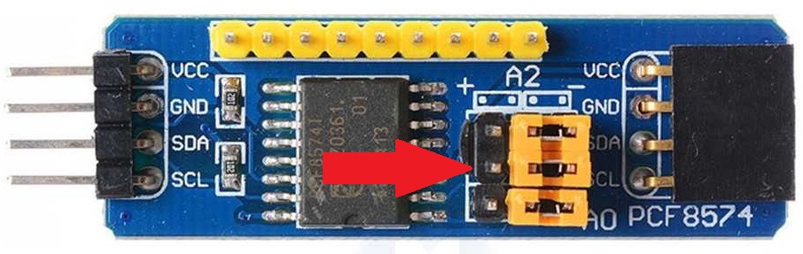

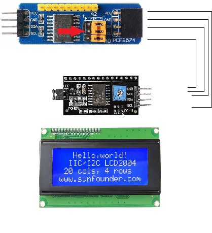

One more thing i need to know, is that the jumper status are ok if i connect LCD 2004A after PCF8574 GPIO extender or should i need to change them.

#6 Post by Ath » 22 Oct 2020, 22:18
It looks like the default I2C addresses for both PCF8574 and LCD2004 are 0x20, so you should change one of them, and as the PCF has jumpers you could move the A0 jumper to the other position, so it should be configured for 0x21 instead.

#7 Post by asuz » 22 Oct 2020, 22:38
Ath wrote: 22 Oct 2020, 22:18 It looks like the default I2C addresses for both PCF8574 and LCD2004 are 0x20, so you should change one of them, and as the PCF has jumpers you could move the A0 jumper to the other position, so it should be configured for 0x21 instead.
Thank you, i will try.

I can't find the manual for the AM404K either. These are Chinese cheap KVM usb switches that share 4 usb stuff with 4 different PC. That KVM does not support keyboard stroke(software key ) switching between devices, for that reason i decide to modify it with ir remote.

In summary, there is a micro usb port at KVM pcb. That micro usb has 4+1 wire connection. 4 wire goes each selection button and 1 is ground. I will trigger each selection button with lolin over ir remote.

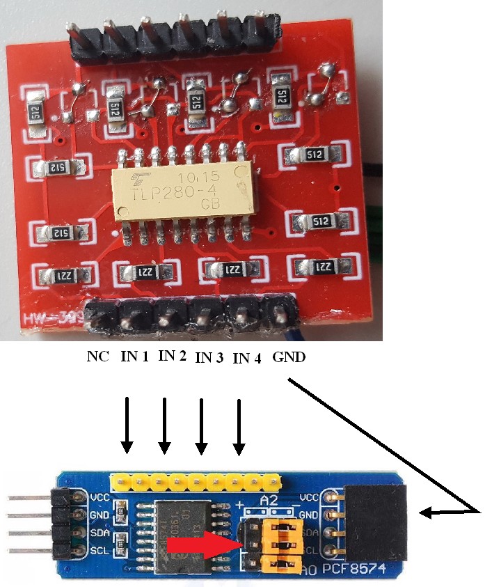

I connect nodemcu to the PCF8574 modul then to the 4-Channel Opto-isolator IC Module but when I send the command <esp ip>/control?cmd=PCFGPIO,1,1, I only measure 1 V between IN 1(IN 2, IN3, IN 4) and GND and it seems it doesnot enough voltage to trigger opto output side. When I measure IN 1(IN 2, IN3, IN 4) and GND without opto modul i get 3.3 V. What should I do?
Re: USB KVM Switch modify project - 2
#15 Post by TD-er » 26 Oct 2020, 15:19
Have you tested using a LED and 220 Ohm resistor to check if the PCF does allow to draw the needed current for the LED?
Do you know the voltage drop of the LEDs in the optocoupler?

Thanks i will check LED and 220 ohm. What do you think about using level shifter to power the 4-Channel Opto-isolator modul?
#17 Post by TD-er » 26 Oct 2020, 20:03
First check whether the LEDs inside the optocoupler can be used at this voltage.
As you may already know, the voltage drop differs per LED color.
Red LEDs have a lower voltage drop compared to other colors.
So I assume the voltage drop of the LEDs in the optocoupler are comparable to red LEDs. If not, then this optocoupler may not be usable in this setup.

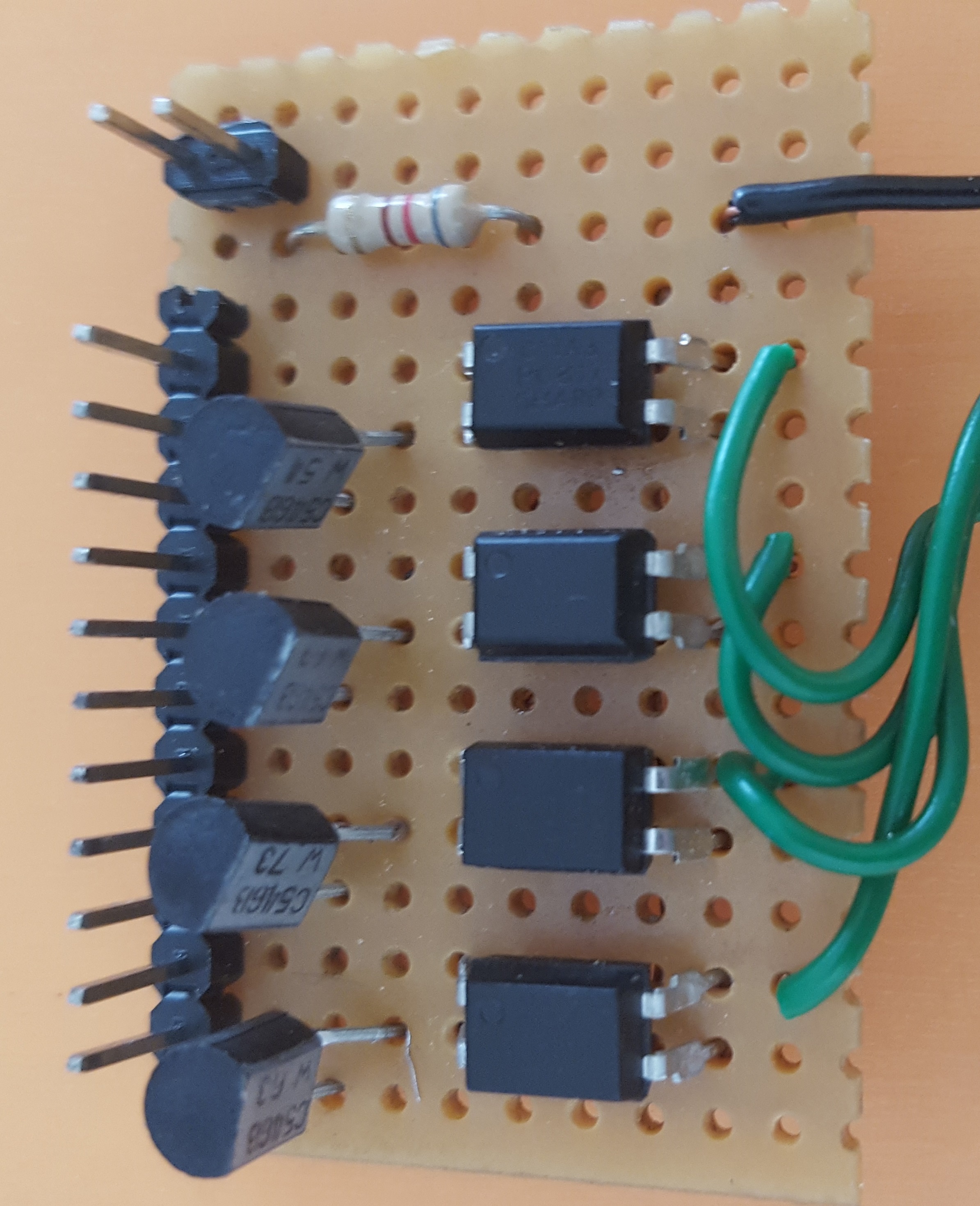

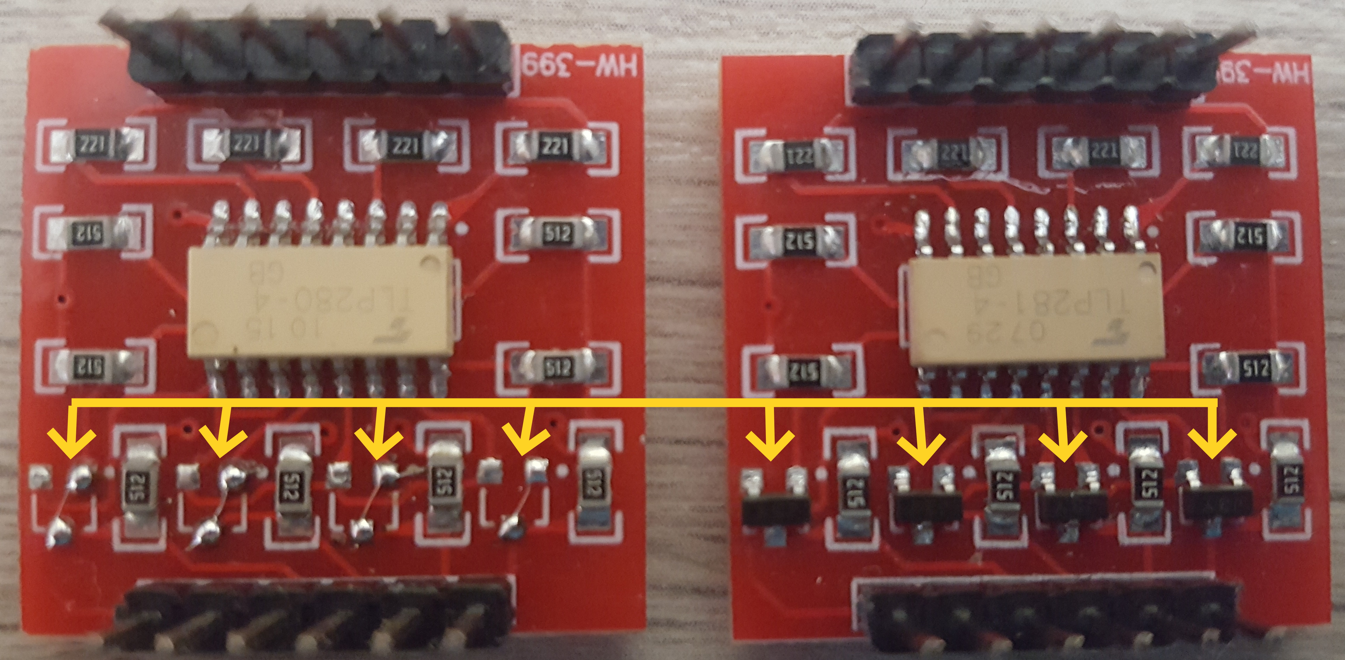

1 - OK, i understood thank you and Micha_he. The 4-Channel Opto-isolator modul it too small to edit it but i will try. GND's are common at the pcb so it will be a hard working or i will build 4 piece 817 opto for driven P0,P1,P2,P3 at the MCP23017.
2 - Just want to know your idea about just give up the editing pcb and only remove the 220 ohm resistor (short them) between led and GPIO and connect the P0 to P3 ports directly to the opto?
3 - I need to do after editing Opto-isolator is find a solution to connect ir led and VS1838B ir receiver. Is it possible to connect directly to the P4 and P5 ports of the MCP23017 or should i need something else?
#25 Post by TD-er » 27 Oct 2020, 14:38
If you can't separate the common ground, then you may need to add a transistor in front which does do the heavy lifting for you.
Removing the resistors will only increase the current through the LEDs, so it will not make it easier for the driving output of the PCF.
Resistors in series with the LEDs will lower the current so the current is limited and thus protecting the LED. (LED will get damaged if you power it with a sufficient powerfull supply and no current limiting resistor)
Maybe the MCP can source a higher current?

#26 Post by Micha_he » 27 Oct 2020, 14:59
2. No ! The led of the optocupler needs ~1.15V / 10mA. You can not remove the resistor. And the PCF8574 cannot drive +10mA.
3. Look at the IR-led datasheet. If it only needs 300µA, would be unusual, it could work ! In my opinion, there is no Led that works with 300µA.
You need a additional transistor/MOSFET to drive the current for each led/optocupler-led or a schematic like these:
Or another I2C port expander...

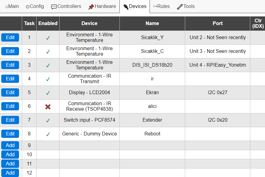

ESP_Easy_mega_20201022_normal_ESP8266_4M1M installed at my nodemcu but there is not include ir stuff at that version of espeasy how can i install ir devices in it?
When i install ESP_Easy_mega_20201022_minimal_IRext_ESP8266_4M2M this time there is no PCF8574 device include. What should i do to use both ir and PCF8574 ?
#28 Post by TD-er » 28 Oct 2020, 23:32
I think you will need a custom build, as it doesn't seem to be an existing configuration using those.

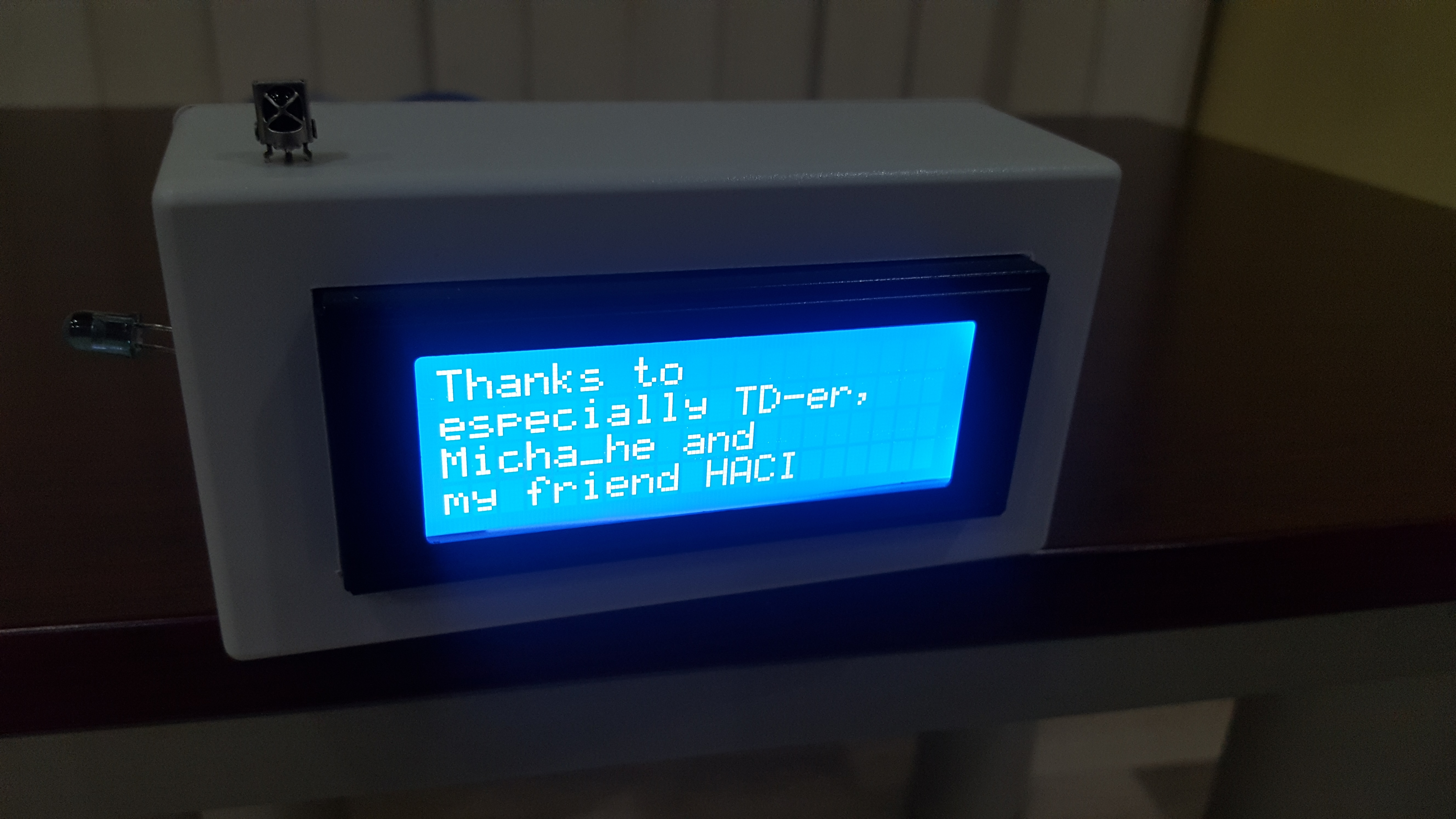

Thanks to especially TD-er, Micha_he and my friend HACI for helping to make my dream project come true. Soon, i will record and publish here a video what the actually the project do and might be reference for somebody for a weekend project.

asuz

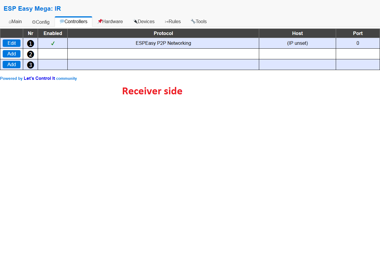

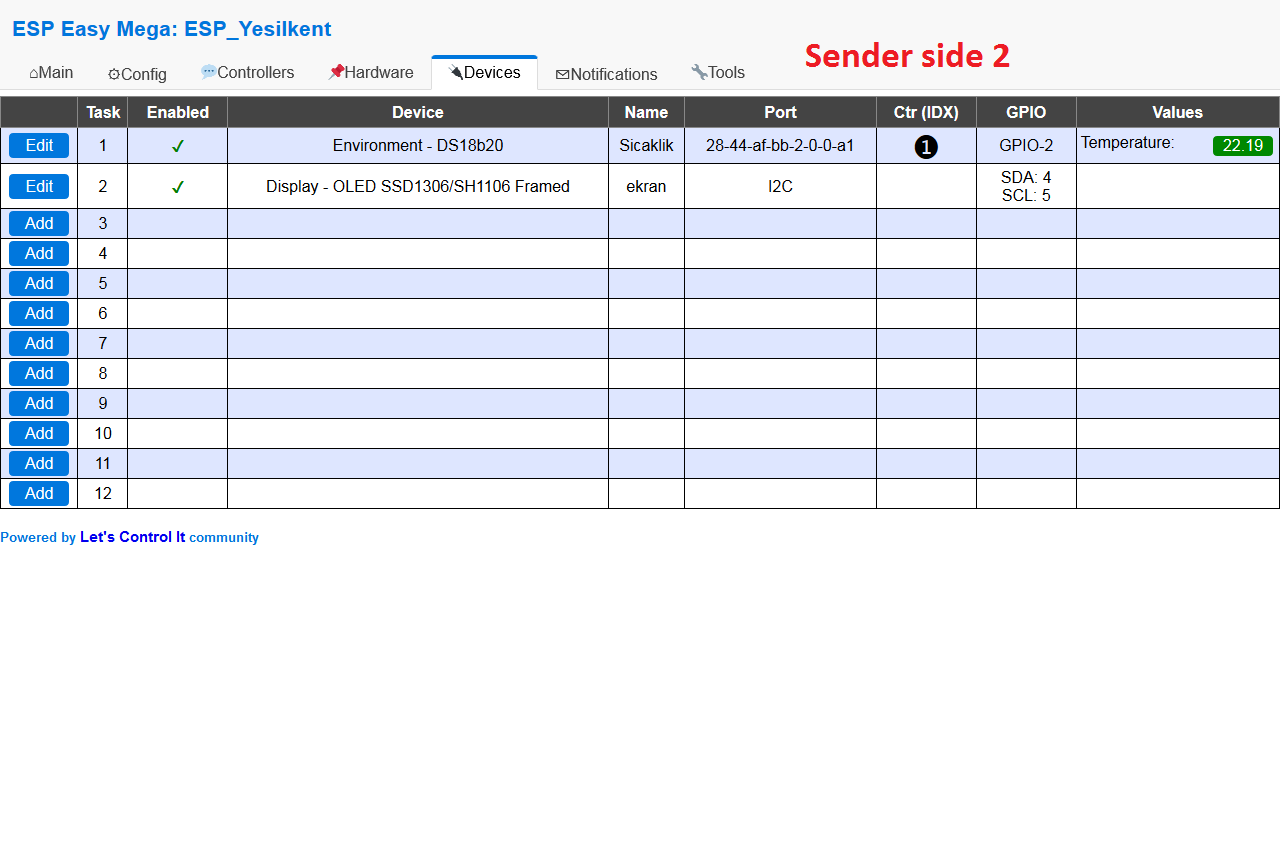

Last things i need to do is get temperature sensors value from other 2 esp easy and display them at that esp easy's LCD screen. Should I use ESPEasy P2P Networking or something else?
#39 Post by TD-er » 30 Oct 2020, 21:07
Yes, use ESPEasy p2p for that.
See: https://espeasy.readthedocs.io/en/lates ... #c013-page
Just make sure to have unique unit nrs (not 0, not 255) and use the same UDP port (8266 of course) among them in the same network.

#40 Post by asuz » 30 Oct 2020, 21:40
TD-er wrote: 30 Oct 2020, 21:07 Yes, use ESPEasy p2p for that.
(and keep showing pictures :) )
Pictures not enough for you, video will come after all done soon. I need a hand, can you look at the picture and what i am missing, please tell me. I see the 3 esp at the main page but after? I want to send Environment - DS18b20 from senders side to receiver side LCD
#41 Post by TD-er » 30 Oct 2020, 21:44
On the sender side you also need to have the ESPEasy p2p controller and link it to the task you want to send via p2p.
On the receiver end you need to have the task nr empty which you try to send.
If you follow the steps on the docs page I linked, you should get it to work.
asuz
Posts: 175
Joined: 31 Oct 2018, 18:22
#42 Post by asuz » 30 Oct 2020, 22:30
TD-er wrote: 30 Oct 2020, 21:44 On the sender side you also need to have the ESPEasy p2p controller and link it to the task you want to send via p2p.
Done, thank you again. I learnt its working logic. :D
