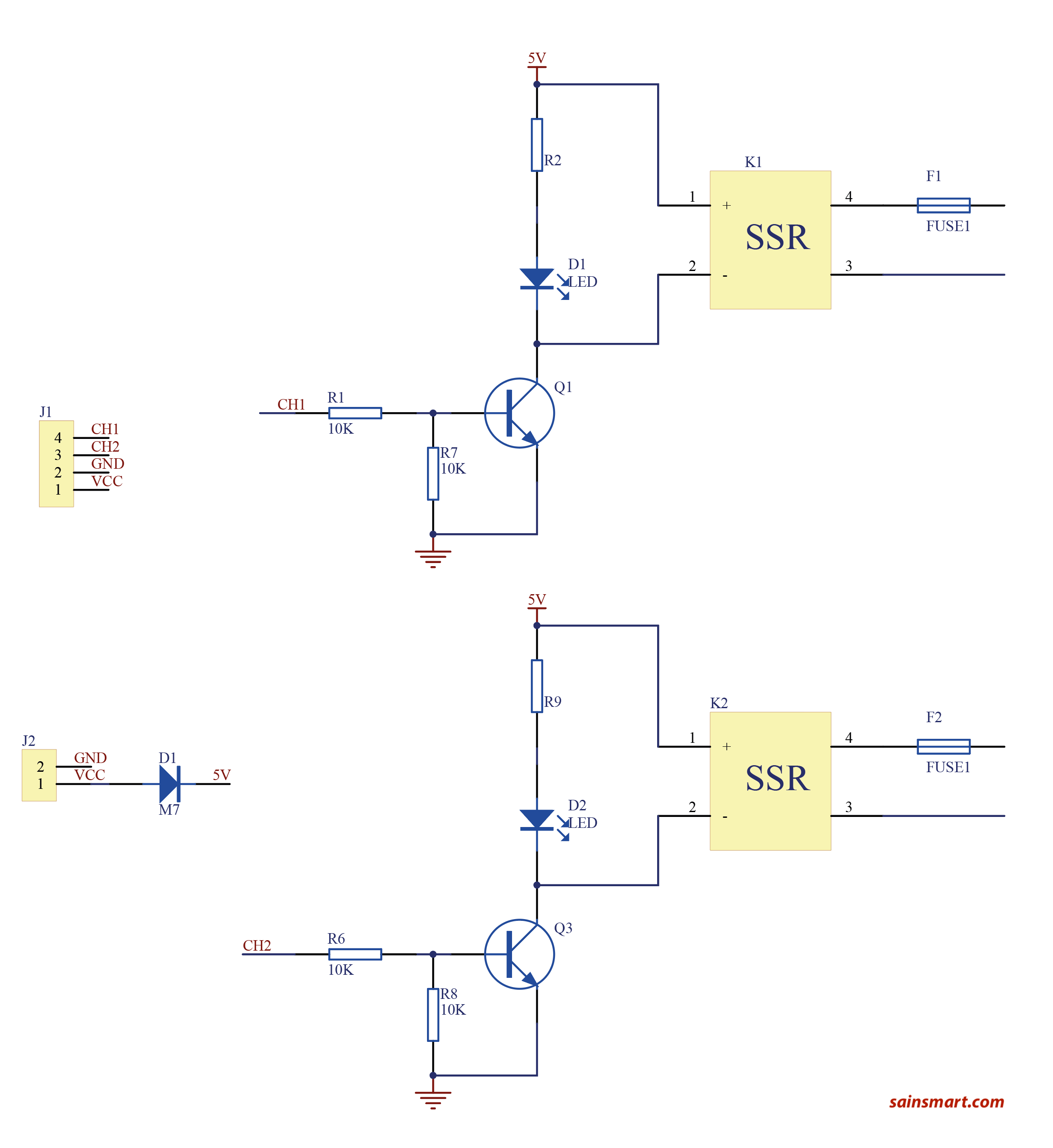

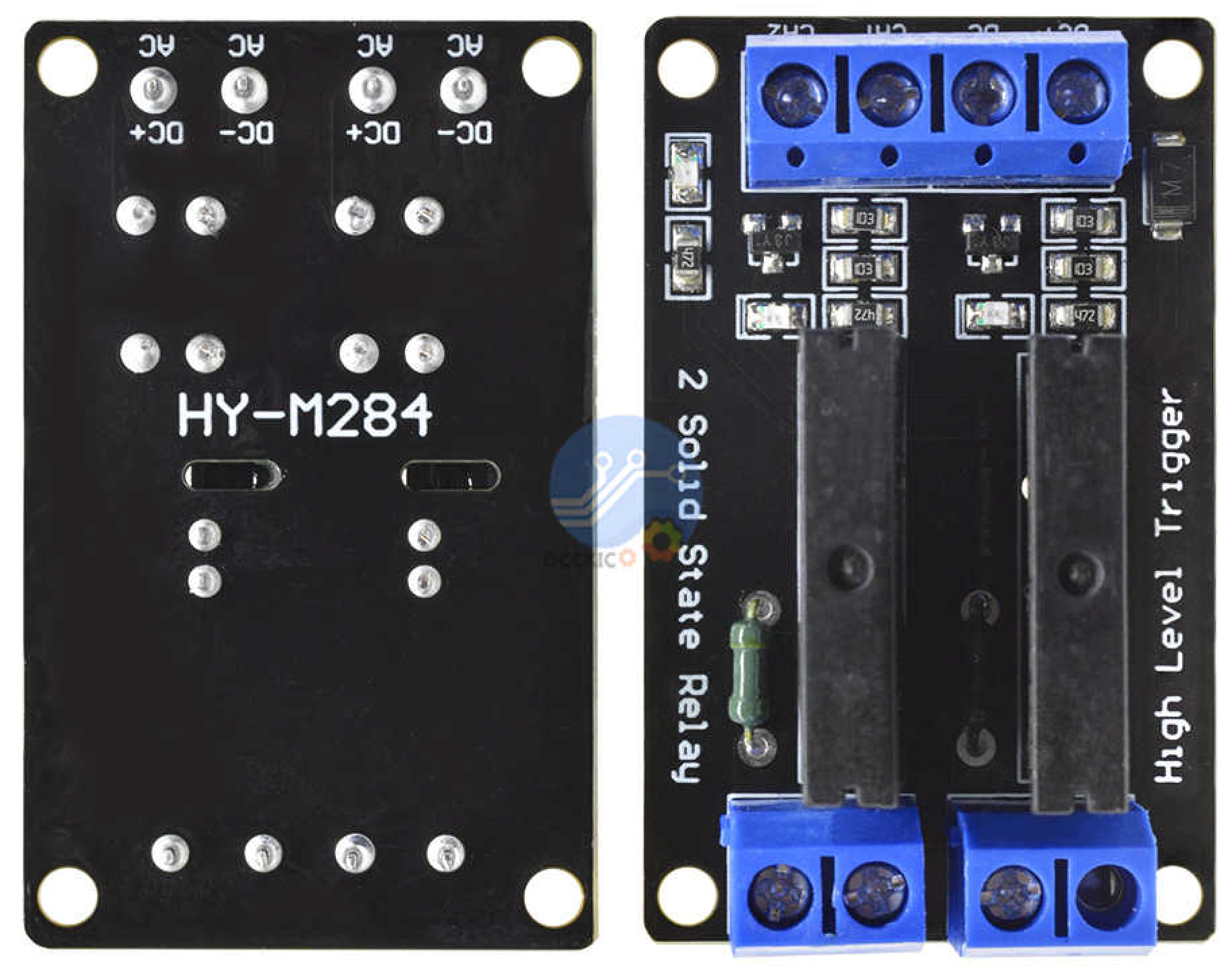

Here’s a closer look at the PCB of this 2-Channel SSR Board, which can carries the model name HY-M284. It’s impossible to find a genuine, official datasheet nor schematic. The best/closest match I was able to find is the schematic shown below of a very similar looking module from sainsmart.com.
2 Channel SSR Module Solid State Relais HY-M284 Schematic.png (216.43 KiB) Viewed 8520 times
@TD-er
Question: AFAIK a device must not draw more than 12 mA max. from a single GPIO on the Wemos D1 mini/ESP8266. So does the J3Y transistor and 10K resistor on the module ensure that there are less than those 12 mA drawn @ 3.3V and the Wemos D1 mini doesn't get roasted?

Posts: 9895
Re: Experience of using Solid State Relay Boards?
#7 Post by TD-er » 09 Feb 2022, 08:26
The 12 mA is what you draw from the 5V and is what is drawn by the 2 LEDs (a SSR is a LED as seen from the low voltage side)
The ESP only has to deal with the 2x 10k resistor, which is perfectly fine for an ESP.
Only thing you need to keep in mind is that not all pins on the ESP are wired equal.
Some do have a pull-up resistor (e.g. GPIO-0 and -2) and some even have a pull-down (e.g. GPIO-15)
So it might differ per GPIO how well these SSR will work
