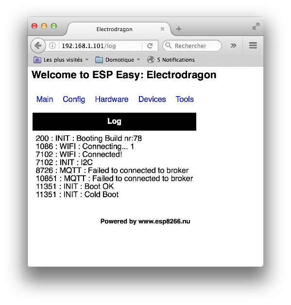

I am having the same problem. Rel 78 using mossquito broker. I am at a loss as to what the problem is and how to troubleshoot
INIT : Booting Build nr:78
WIFI : Connecting... 1
WIFI : Connected!
INIT : I2C
MQTT : Failed to connected to broker
INIT : Boot OK
INIT : Normal boot
WD : Uptime 0 ConnectFailures 0 FreeMem 26424
MQTT : Connection lost
WD : Uptime 1 ConnectFailures 2 FreeMem 26336
WIFI : Connected!
INIT : I2C
INIT : Boot OK
INIT : Normal boot

My ESP still can't connect to broker...
1/ My broker is running well :
2/ I can connect & send fake messages to my broker via MQTT.fx :
Then I receive them well :
Here is my ESPEasy configuration :
And here is my log :
My ESPEasy version is R78
I also tried with versions R107 & R91 and I have exactly the same problem...
Strangely I prefer R78, other versions make my board a little bit noisy, the board make a little shrill noise.
My Mosquitto version is 1.3.4-2 :
If anybody can help me...
Best Regards.

Re: MQTT : Failed to connected to broker
I think I have found the solution...
My controller IP adress is not 192.168.0.100 but 192.168.1.100
I'll check it tonight @home and send you reply.
90% of problems are located between the chair and the keyboard...
your esp-modules are on your net 192.168.1.x,
and your mosquitto-server is in a different net 192.168.0.x
(look at your screenshots).
are you shure, you can reach clients from one net on the other?
maybe you check your networking-setup regarding this routing?
