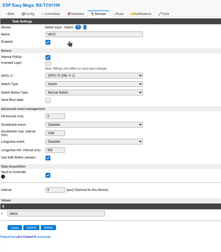

D8 config.png (56.91 KiB) Viewed 22719 times

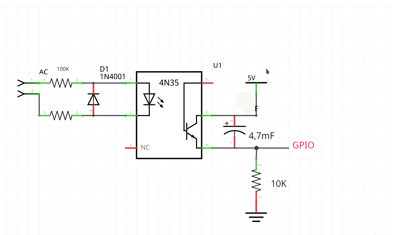

Hya,
worked, with the following scheme:
replaced D8 by D2 and internal pullup.
By initial tests, it's working.
AC sensor with 4N25.png (69.66 KiB) Viewed 22639 times

TD-er wrote: 21 Dec 2020, 14:23 Or to make it a lot simpler, have a capacitor over the LED. But then you have to deal with mains voltages.
i also thought about it, but dealing with the mains didn't seam a good idea, so i did as the new schema.
Worked on a 5 minut test as i will only be able to test more sometime later this week.
Re: AC detector - how to make it work?
#11 Post by TD-er » 21 Dec 2020, 14:56
Ah that's indeed a way more simple schematic.
Should work just fine.

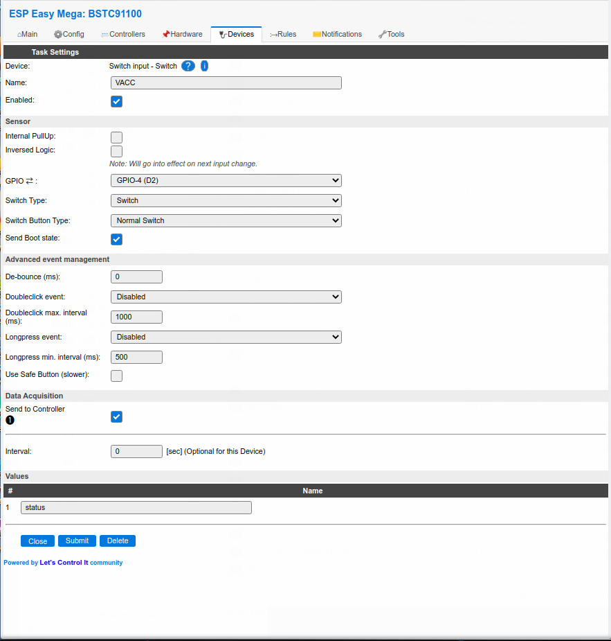

Ok, guys, something is not right at all.
The pin D2 / GPIO 4 is the input for ACC sensor.
What does happen: VACC status does not change when ACC is detected. So, by devices, i enable Internal PullUp, and.. it works! status of VACC changes form 0 to 1 and 1 to 0 when ACC is detected.
Then after a reboot, PullUp enabled, the VACC status does not change. So, by devices, i disable Internal PullUp and, it works.
Long story short: i have to change the pullup behavior every time after boot to make it work.

#13 Post by TD-er » 21 Dec 2020, 23:06
Have you set the boot states in the web uit for the pin?
pw444
Posts: 155
Joined: 23 Apr 2019, 15:34
Location: rio de janeiro
#14 Post by pw444 » 21 Dec 2020, 23:07
TD-er wrote: 21 Dec 2020, 23:06 Have you set the boot states in the web uit for the pin?
can you please explain?
#15 Post by TD-er » 21 Dec 2020, 23:09
See the "Hardware" tab in the web UI.
There you can set the internal pull-up state which will be set at boot, before starting the plugins/controllers.
pw444
Posts: 155
#16 Post by pw444 » 21 Dec 2020, 23:16
TD-er wrote: 21 Dec 2020, 23:09 See the "Hardware" tab in the web UI.
could not find pullup on the hardware tab. pullup i could only find on devices tab, inside the task definition.
#17 Post by TD-er » 21 Dec 2020, 23:22
It is right under the "GPIO boot states" header.
