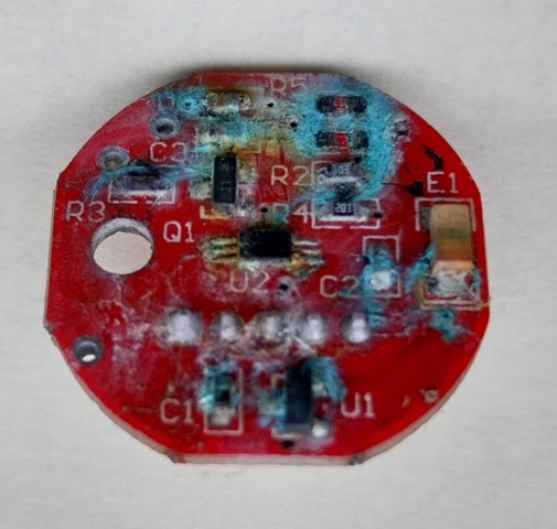

The other 3 lightsensors in the housing still doing their jobs => no need for urgent repair of the BH1750.
However, the protecting window of plastic & gaze of the sensors' housing (as shown in 1st message in this thread) has increasingly been discolored & fractured due to prolonged UV/light-exposure, handicapping operation of those sensors.
Therefore the setup now indoors and dismantled, showing that the BH1750-PCB is 'far beyond-repair'.

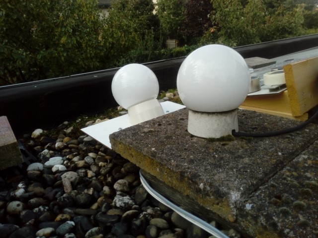

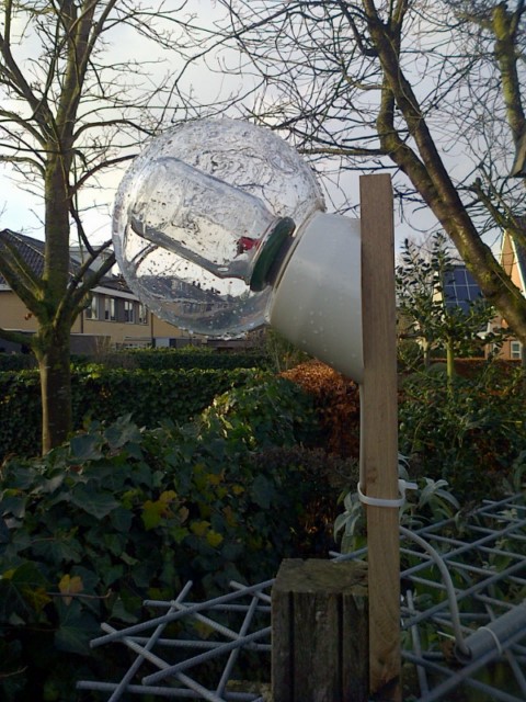

In fact thinking along that line, because already lampbowls in use as housing for other lightsensors, UV-sensors and as 'solar_jar'.
'Solar-jar' is a setup in which you measure temperature inside a glass-jar enlighted by the sun, and compare with a 'normally' shaded thermometer:
- the air inside the solar-jar heats under effect of the sun's power
. the difference betwwen the temperature inside the solar_jar and the open air temperature outside the solar_jar is measure for sun's power.
Sounds simple, but is unreliable
=> quickly tracking the up-line, but the stationary air inside the bowl slowlier cooling-down for the down-line
=> just useful as a coarse indicator ...........
. The 2nd jar inside the clear bowl meanwhile has been removed, because cause of reflections spoiling the measurements, and bad for temperature management.
The shown lampbowls have surprising little effect on the sensing performance of the lightsensors and UV-sensors.
The 'slanted' lampbowl has the advantage that the sensor can easily be aimed in the direction of the noon sun-position.
Because the bowls sometimes are 'less uniform' at the central point, other advantage is that zenith scanning is performed through the side of the bowl.
Further experience shows that temperature inside such bowl can become a 'problem' in summer,
even causing temporary stop of the PCBs' functions.
'Challenge' to fit a simple, yet effective ventilation ........

Rummaging in the garage detected also a cartridge with silicon paste as used in kitchens and bathrooms:
well suited to fight moist, but not so sure that electronics like that paste.
Sensing some confusion, to be corrected.
The 'defect' BH1750 was not inside a bowl, but was fitted at the bottom-side of the small dome visible at the top of the exhaust-vent used as housing:
by dome & hood well protected against rain etc, but at the bottom-side exposed to air flow.
As can be seen on the detail-picture of the PCB, the PCB has a hole which would allow flow of air through the PCB into the small dome.
Apparently the thermal changes due to weather have effect that the air sucked inside the small dome has condensed, and the PCB being at the bottom of the dome with electronics at upper side has collected liquid & suffered the consequences .....
The electronics in the bowls nowhere are at the bottom of the bowl, but have 'elevated' positions, preferably in the center of the bowl for good view,
which means that any condensation can harmlessly flow along the sides to the bottom of the bowl, and exit through drainage holes:
occasionally ( ~ spring+autumn) I take off the bowls and check & clean, but seldomly seen any moist/liquid inside.
The ESP8266 related to the BH1750 and his brethern is located in the electronics box at the back of the housing (left on the picture):
no moist problems with that IP-certified box.

Suspecting also some leakage at the side of BH1750's dome have carefully checked the fitting of the dome and put some extra paste on the edges.
Based on (positive) experience have put the other 3 sensors on an 'arm' inside a glass lampholder.
That lampholder is a front-extension of the original housing, mechanically connected aiming downwards,
meaning that the sensors now look at higher elevation, not yet zenith-scanning, but approx. +60 degrees rel. to horizon.
Simple support of the lampholder needed in form of recycled box+V-support, to keep the main housing vertical.
This raised elevation should already give some improvement, with the 3 sensors less looking at near obstacles, and more looking to summit of sun's trajectory.
The wooden bases for the 3 sensors shifted unchanged to the 'arm', meaning that the 2*TLS2561 are cross-eyed,
which was favourable in the original setup to avoid 'edge'- effects in the windows of the modules & housing.
In the new setup both (more or less) look through the same segment of glass: if the glass not uniform, same effect for both.
Ventilation inside a glass-bowl is not easy, and therefore possible that in midsummer the sensors become a little too hot for comfort,
but experience in the other bowl-setups shows that a functional breakdown seldomly occurs ......

Maybe test if there is a focal point of the sunlight inside the glass.
Just to be sure your setup won't catch fire
Last summer a neighbor of mine almost had her garden cushions on fire (large burn spot) due to an empty drinking glass left outside.
So I'm a bit more careful these days with glass and sunlight.
