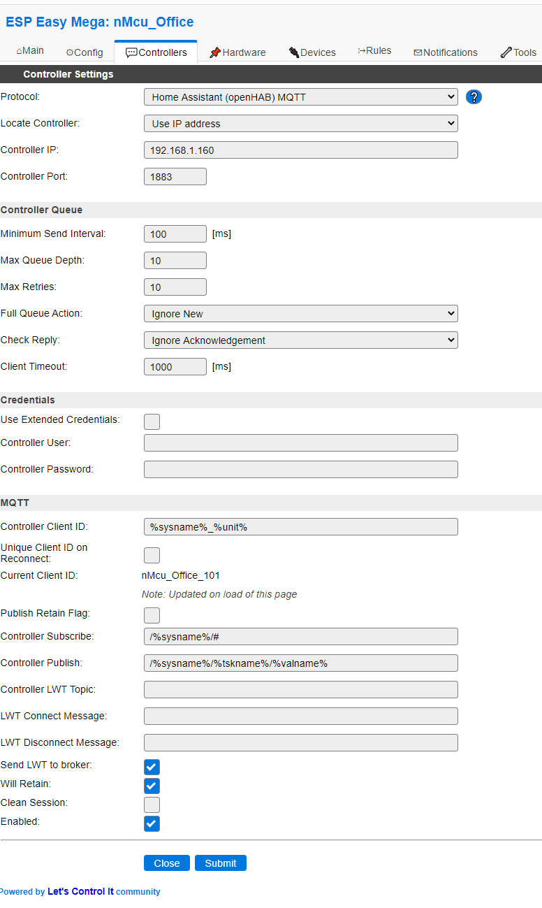

My installation uses OpenHab2 MQTT and has some Lolin NodeMCU V3 devices that utilize the MQTT broker. They all have the mega-20200222 [Testing] release. I haven't encountered lost MQTT connections with any of my NodeMCUs.However, the same problem occurs with the NodeMCU ESP8266 v1, but I did not notice this with the Wemos D1.
Below is a screenshot of my typical controller settings (for comparison to your configuration):

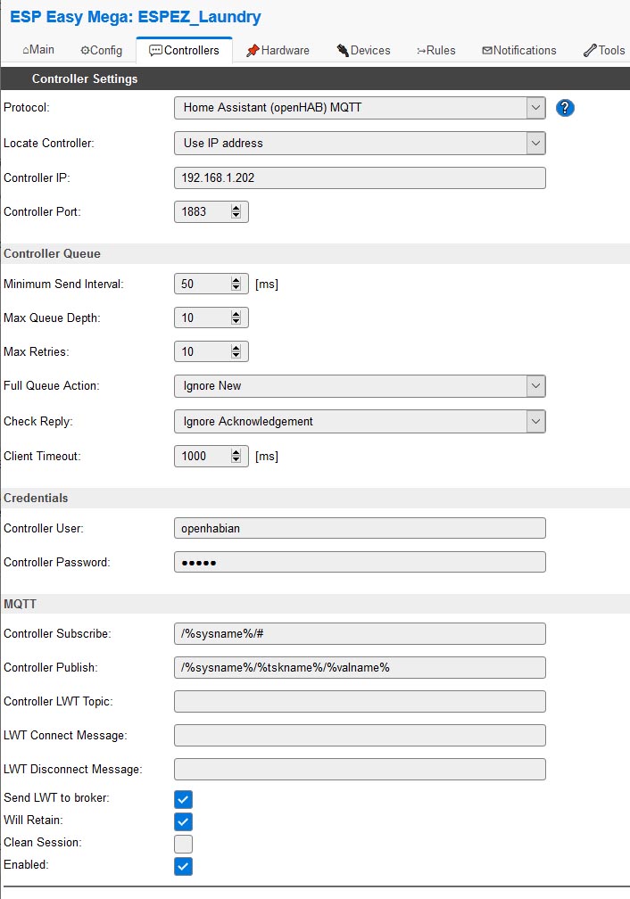

Re: openhab MQTT connection lost
This is my OH2 configuration. And a correction of the previous post I have NodeMCU ESP8266 v3 not v1.
Our controller settings are similar. However, I'm using the mega-20200222 [Testing] release (ESP_Easy_mega-20200222_test_ESP8266_4M1M_VCC.bin) on my NodeMCU devices. This combination has been stable/reliable.
