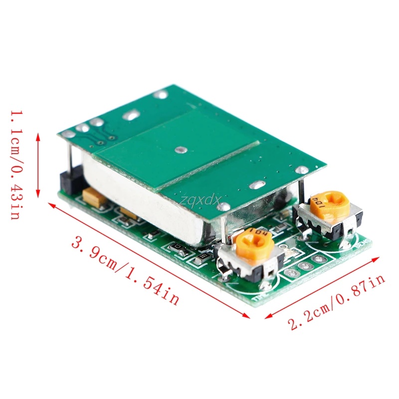

After inspecting three different integrated 230V Microwave Sensor Relay Switches, I realized that the DC circuitry doesn't seem to run on 5V (depending on the model I measure either 12 or 24V, which matches the imprint on the relay). Anyhow I have to admit that I'm not expert enough to understand the circuitry enough without access to a schematic.
Long story short: I ordered a HFS-DC06 5V 5.8GHz Microwave Radar Sensor Switch Module from AliExpress for USD 3.18 (4.76 shipped) for testing. Curious to see how well that works. Any experience with that module?
- Bildschirmfoto 2021-04-23 um 01.43.53.png (268.97 KiB) Viewed 24256 times
- HFS-DC06.jpg (100.63 KiB) Viewed 24259 times

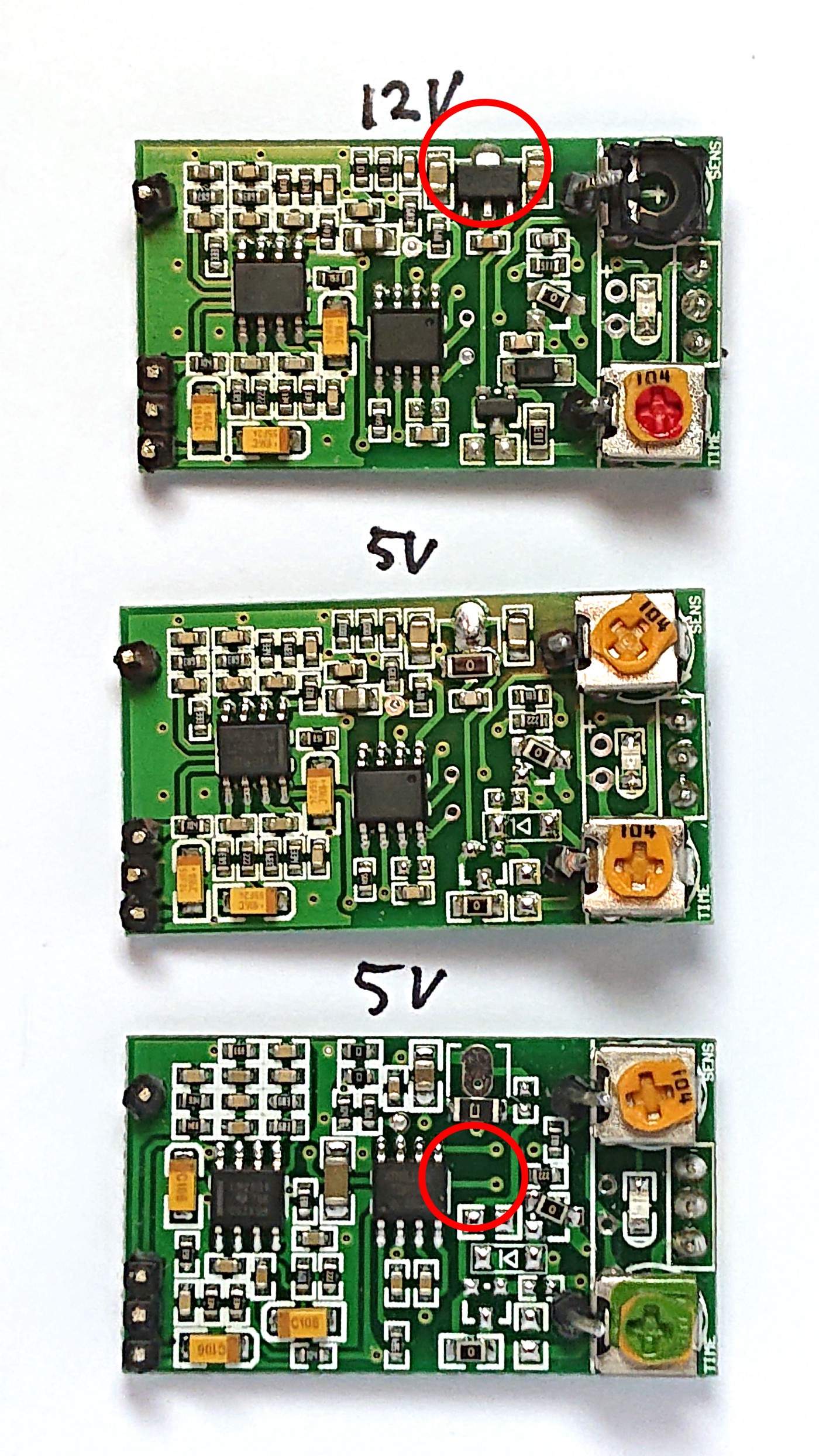

As for the voltage of the HFS-DC06: There are different board versions (HFS-DC06H, HFS-DC06F, no idea which is which), but there is a good comparison, also describing your found 78L05 differences, on this page: https://kleinejan.medium.com/boltanski- ... e41202ccb6

So, why did you order the HFS-DC06 and HB100 then?
What speaks a bit against the RCWL-0516 is the rather short range (on 7 meters unobstructed; amongst others I need to cover a 11 x 1,5 meter hallway), and if you actually need a shorter range, SMD soldering is required (0805 resistor @ PCB position R-GN). Also the repeat trigger timer requires soldering an SMD capacitor (PCB position C-TM), should there be a desire to change it.
Full description of the RCWL-0516 here.
Re: Voltage-based trigger on Wemos D1/ESP8266 – How?
The RCWL-0516 is an effective sensor for typical motion detect applications. Perhaps the best value for the dollar.So, why did you order the HFS-DC06 and HB100 then?
But it won't work in my application. The full story is found here: viewtopic.php?f=2&t=8759
For the record, I have no idea if the HFS-DC06 or HB100 will work for me either. But try I must because I refuse to let the turkeys win.
Installing a 0805 size component is not difficult if you can solder thru-hole devices. You'll probably need to install resistor R-GN, but it's highly unlikely you will need C-TM. Regardless, don't let this SMD soldering be a deal killer.... and if you actually need a shorter range, SMD soldering is required (0805 resistor @ PCB position R-GN). Also the repeat trigger timer requires soldering an SMD capacitor (PCB position C-TM), should there be a desire to change it.
