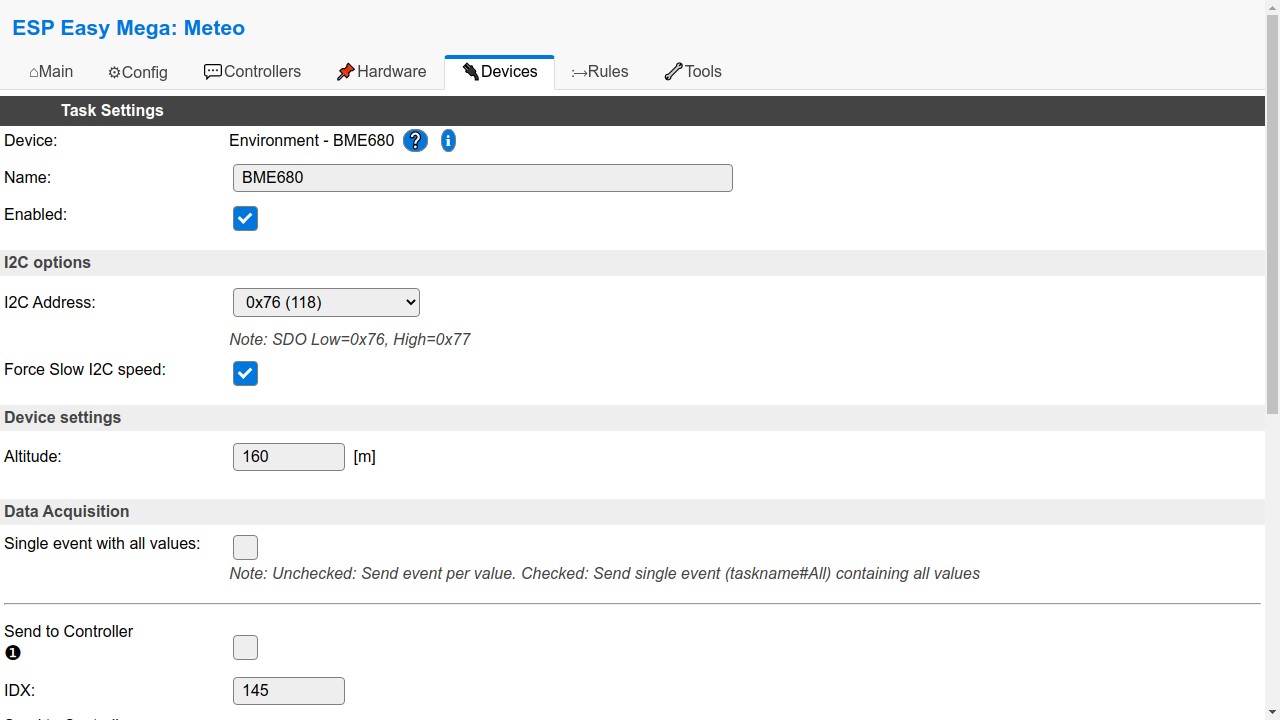

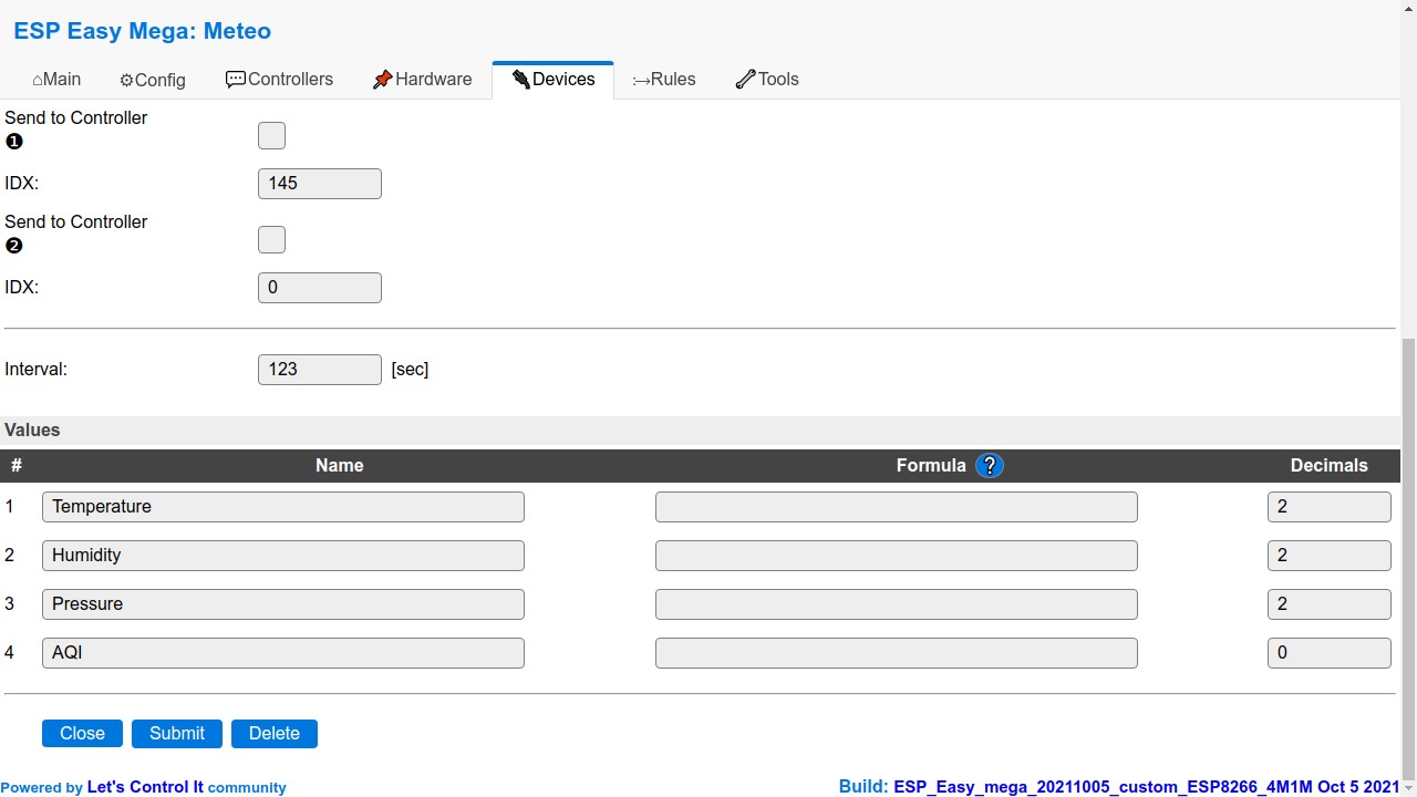

The name of parameters as define in task of device BME680. See screenshots:

Well, actually that format is documented, for the Rules, over here and it also works in other places where you can enter related text, like in the Formula field

Posts: 9895
Re: Virtual sensor in Domoticz for BME680
#15 Post by TD-er » 13 Oct 2021, 09:08
You can have multiple instances of the same task.
For example when using the Dallas plugin, one often has multiple Dallas 1Wire sensors.
To distinguish among various tasks, one has to make an unique combination of taskname#taskvaluename
In the rules every occurence matching [taskname#taskvaluename] will be replaced with the current value of that taskvalue.
So if your task is called "bme680" and it has a value named "Temperature", you can refer to this value via [BME680#Temperature] (don't forget the square brackets)
N.B. since the events are not always handled immediately, and the [taskname#taskvaluename] replacement is done at the time the event is handled, you may want to use the %eventvalue1% notation to refer to the value it had when the event was generated.

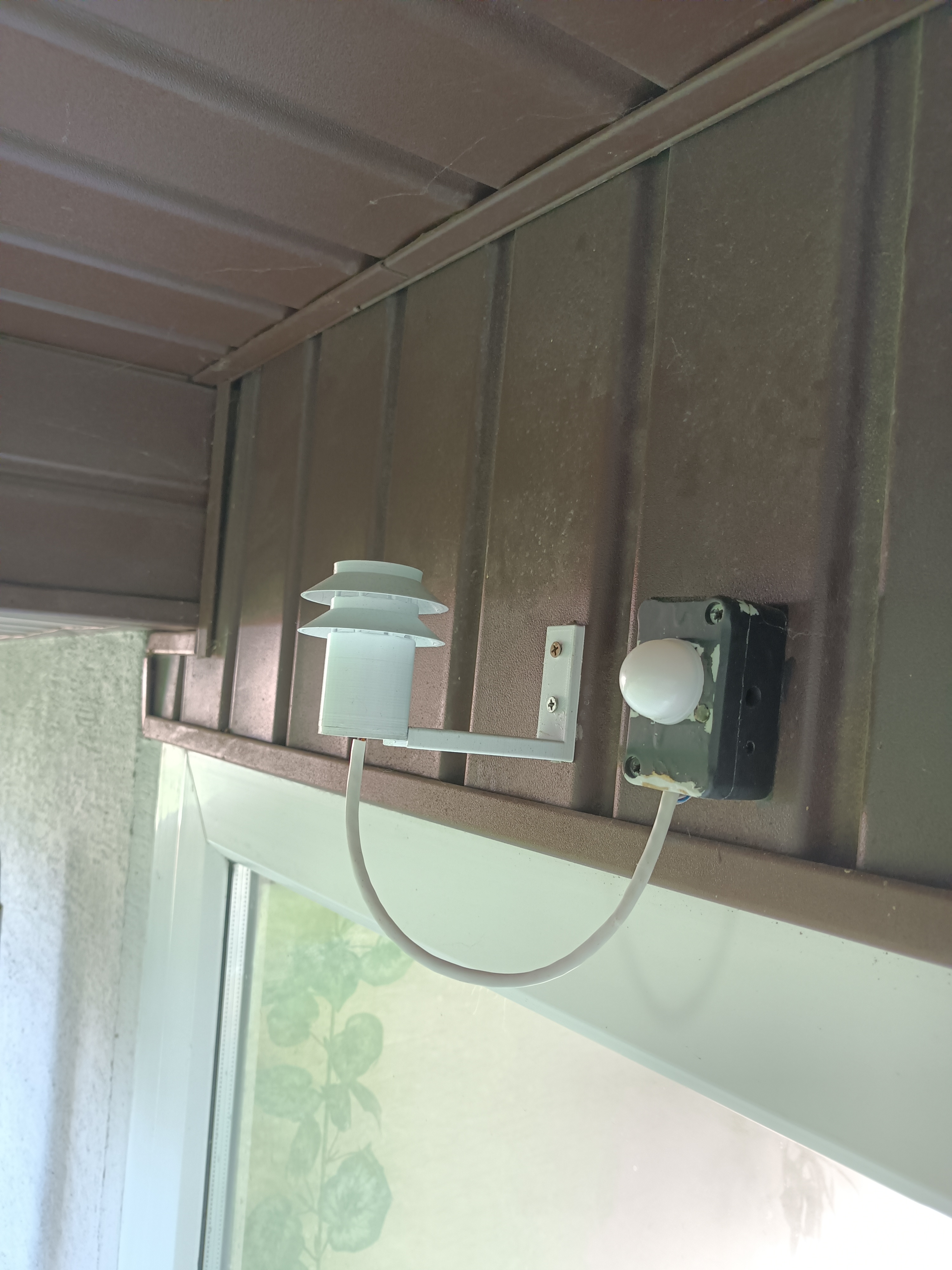

At the moment I use a set of three separate I2C sensors:
- SBGP30 (AQI)
- HTU21D (hum/temp)
- BMP180 (pressure and temperature backup)
And because I use them outdoors, they were placed in the so-called "Stevenson Weather Cage" (see photo). It is a 3D printout.
Next to it is another I2C sensor - BH1750 (Lux). It works on the same I2C bus as previously mentioned.
