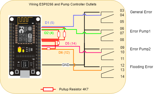

Re: Send alarms from basement pump to mobile device
Hello Ath, hello TD-er
Many thank for your answer. I tried to chart the wiring from ESP8266 to pump controller outlets. I think it won't work because according my model pattern from Elektronik-Kompendium - Paragraph 3 (German) GPIO-Pin is connected with +VCC.
Could you please give me some advise?
Many thank. I really appreciate your work and help.
You're using a single pull-up resistor for all inputs. You need a resistor for each signal you like to measure.
Also in your picture, you attach the GPIO pins line to the GND.
So that's not going to work.
You did post a correct schematic below, where there is a resistor between Vcc and the GPIO.
The switch will then "pull" the level down to GND.
There you also see why you need to have a resistor per GPIO, otherwise all connected GPIO pins will be pulled down if one of the switches is closed.

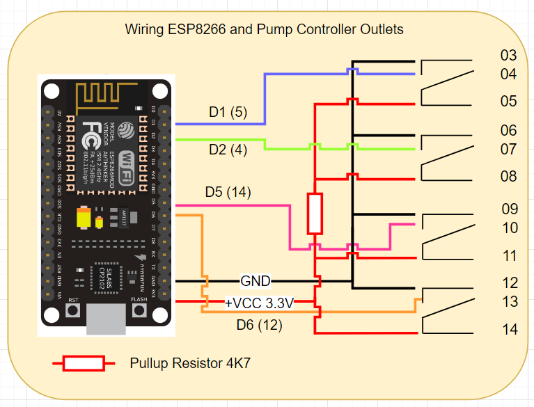

Hello TD-er
Thank you for your patience. Unfortunately I know very little about electronics
but I try my best.
I made a new picture but if I use a separate +VCC (3V3) per outlet I only can connect three outlets of the pump controller. Or I could use only one resistor and V3V for pump1 and pump2 (Outlet 06/07 and 09/10) so I just would know if pump1 or pump2 has a failure. That would be ok. I then could use the third 3V3 for Outlet 12/13 to find out if there is a flooding error.
I hope this is a step further into the right direction
Nope.
What you need is this:
3V3 ---Resistor----GPIO----switch----GND
So all resistors have 1 pin connected to 3V3 and their other pin to the respective GPIO pins.
From the GPIO pins you connect a wire to their switches
The other end of the switches you connect to GND.
Only a big warning!
Make sure the switches are (before you start) not connected in any way to each other or to some voltage. (so called "potential free")
The best way would be to have the switching pins of some relays.
If the outputs are not a relay, but something else, you need to know if those outputs have some kind of polarity (a + and - symbol)
However, the schematic does not suggest it, so you're probably fine.

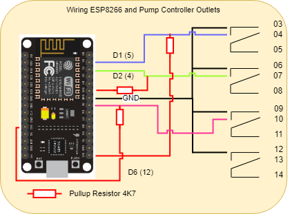

Hello TD-er
Ok, I don't give up. Next try
sorry to bother you again.
The manual states that the outlets are potential free (potentialfrei in German). Should I measure voltage from outlet 03/04, 06/07.... before connecting some cables? Just to be sure that there is no voltage and the relay is potential-free? I already checked the continuity (Durchgangsprüfung) with a multimeter and there is no connection between 03/04 but between 04/05 because there was no error when I was measuring. That's how it should be.
I took the outlet for pump1 and pump2 on the same GPIO (D2, GPIO 4) because there is no 3V3 left on the ESP8266.
Thank you for your help. It's really nice.
Regards Manuel
Still not a good drawing ...
With respect to the potential free, that sounds good.
Just puck 1 pin on the NodeMCU with 3V3 and one with GND and use those.
So with my best ASCII-art skills:
As you can see, Each GPIO you plan to use should be connected to:
- A resistor
- the center point of the switch
Each resistor is on one end connected to 3V3
The pin on the switch that is normally closed is connected to GND
So what you get then is that the signal is "0" on the normal situation and "1" on the alert situation.

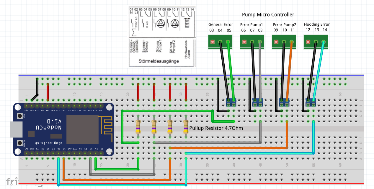

Hello TD-er
Cool! Thank you for your help and patience. I really appreciate that. I made a new drawing with fritzing. Makes me always a little bit nervous to show it to you
I changed the wiring on the switch side.GND is now in the middle an GPIO line to one of the side pins.
I sponsored you some coffees. ESPEasy is really really cool and I already have some sensors installed in my apartment.
Looks OK.
Just a few remarks:
- The Fritzing image mentions "4.7 Ohm" that should be 4k7 Ohm, or 4700 Ohm. (10k is also fine, 4.7 Ohm is almost a short circuit)
- The lines from the switch to the pull-up resistors is now drawn in red, it is more clear when drawn in the same colors as the GPIO line. After all it is the GPIO state.
Thank you TD-er
I already changed the colors of the red lines to the one of the GPIO state colors in the last post. Resistor is now 10k.
I guess this is it
Thank you very much.
Manuel
- ESP8266 Wiring Pump Controller_Steckplatine.png (386.72 KiB) Viewed 14593 times
Great
Hope you also learned why it should be connected like this.
Hello TD-er
Yes, with your explenations I think I understand it. There is also a really good Site in German which explains very well pullup and pulldown relay. This also helped me a lot.
Many thanks for your help. You deserved your coffees.
Greetings Manuel
Greetings Manuel
