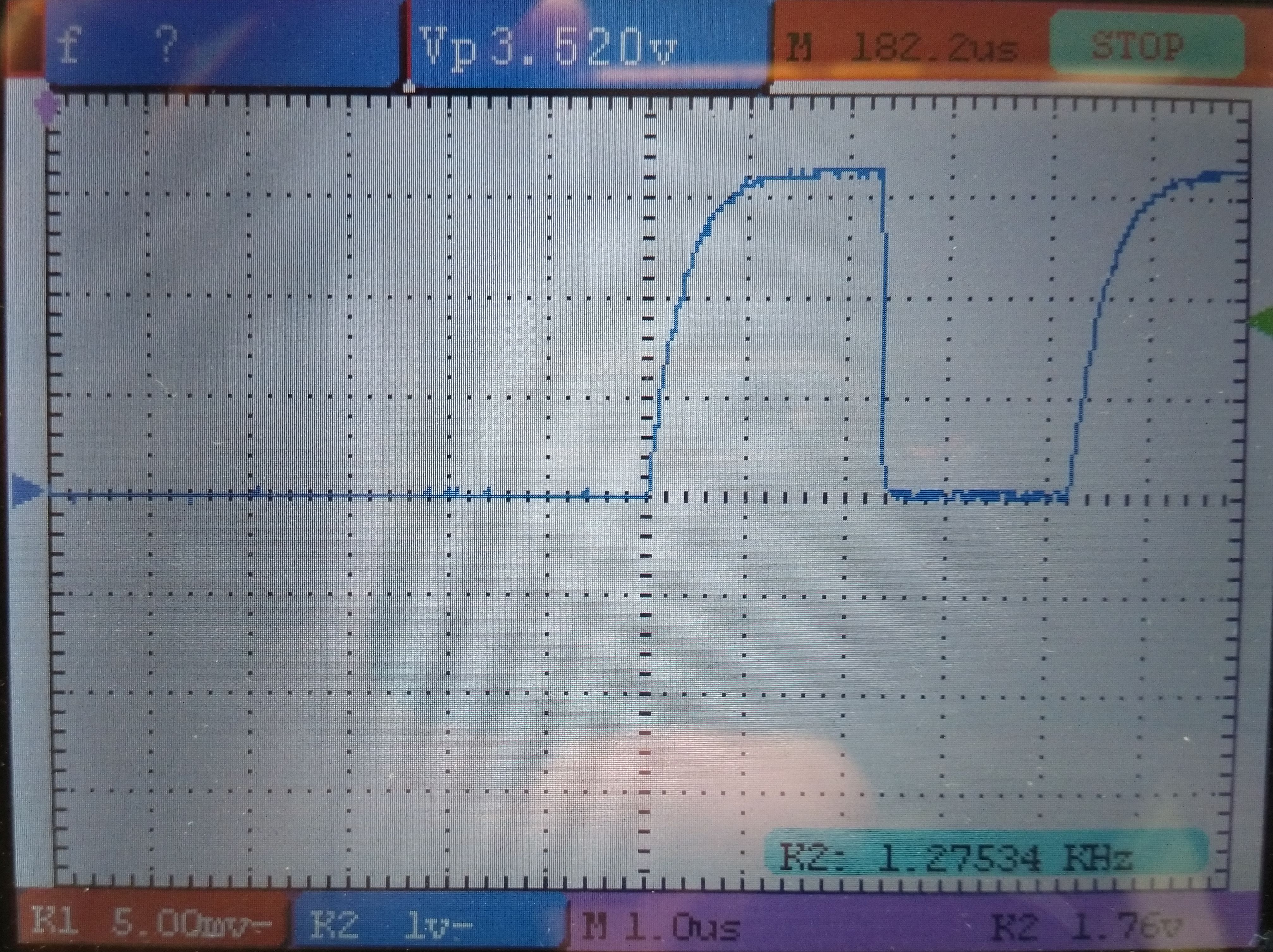

Reduce the SCL/SDA pullup from 4,7k to 1,8k, because the rise-time was to long (900ns) for 400k-I2C

For 400 kHz you could still use 900 ns as the period is 2.5 usec, so you're below 50%.
What do you count as the level above which you stop measuring?
And what is the fall-time? (measured at the ESP and at the chip)
Can you experiment with a setup with thicker wires?
Capacitance is only one explanation of the slow rise time.

This is a statement from the specification: The rise-time of SDA/SCL to be a maximum of 300 ns in "Fast-mode”
You mean the level to stop the measuring the rise-time? 70% of Vcc (3,3V) = ~2,3V
Rise-time with 4,7k (resulution 2µs):
Rise-time with 1,8k (resultion 1µs):
I've tried thicker wires. No improvement. Same rise-time.
