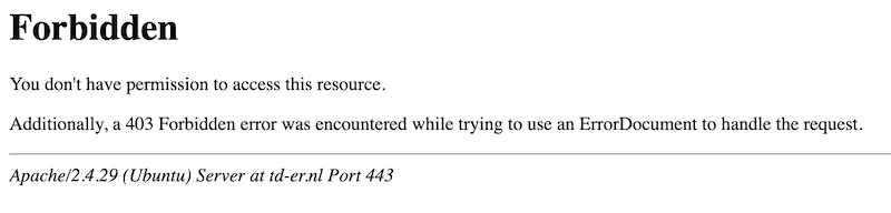

I wanted to try the web flasher but.....
Bildschirmfoto 2021-07-08 um 16.37.36.png (39.91 KiB) Viewed 12191 times

#6 Post by Ath » 08 Jul 2021, 16:45
What is the Operating System platform you are on?
And what browser are you using?
Possibly using a browser plugin that blocks almost everything like scripts and stuff?
Can you send me a direct message with your IP address?
I have some IP-ranges blocked due to hack attempts (1000's of them... per day some times) but I also got some reports of others that were now blocked from a country which does not reflect the comment next to the IP-block.
So I guess some IP blocks were sold to other providers and they sold the least interesting ones as those were blocked in various tools.

#10 Post by chromo23 » 08 Jul 2021, 20:21
Thanks a lot... that’s the clue i needed :)
I have a vpn service and connected to a server in the netherlands. Works! Great!!!
