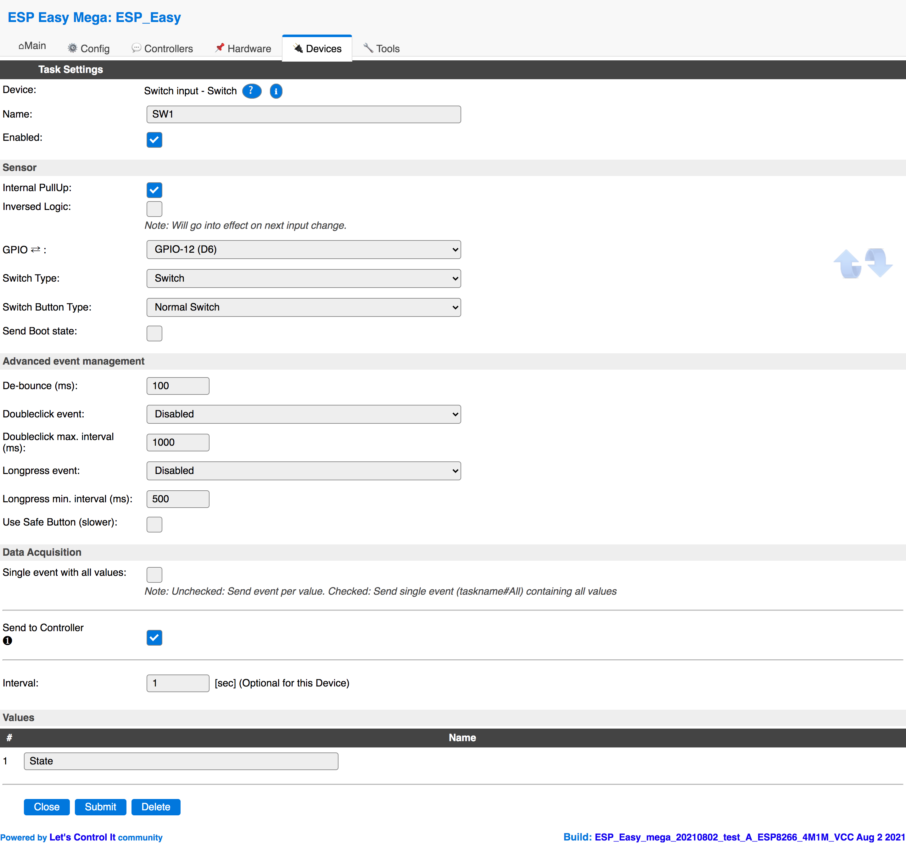

Can you also show a screenshot of the Switch SW1 settings and the Controller settings (details)?

#12 Post by 4711Austria » 07 Aug 2021, 15:42
here we go

#13 Post by Ath » 07 Aug 2021, 16:22
Ok, that looks nearly standard. Can't see anything really strange yet...
I'm a bit puzzled by port 1886 on the MQTT broker, the usual default for that is 1883
